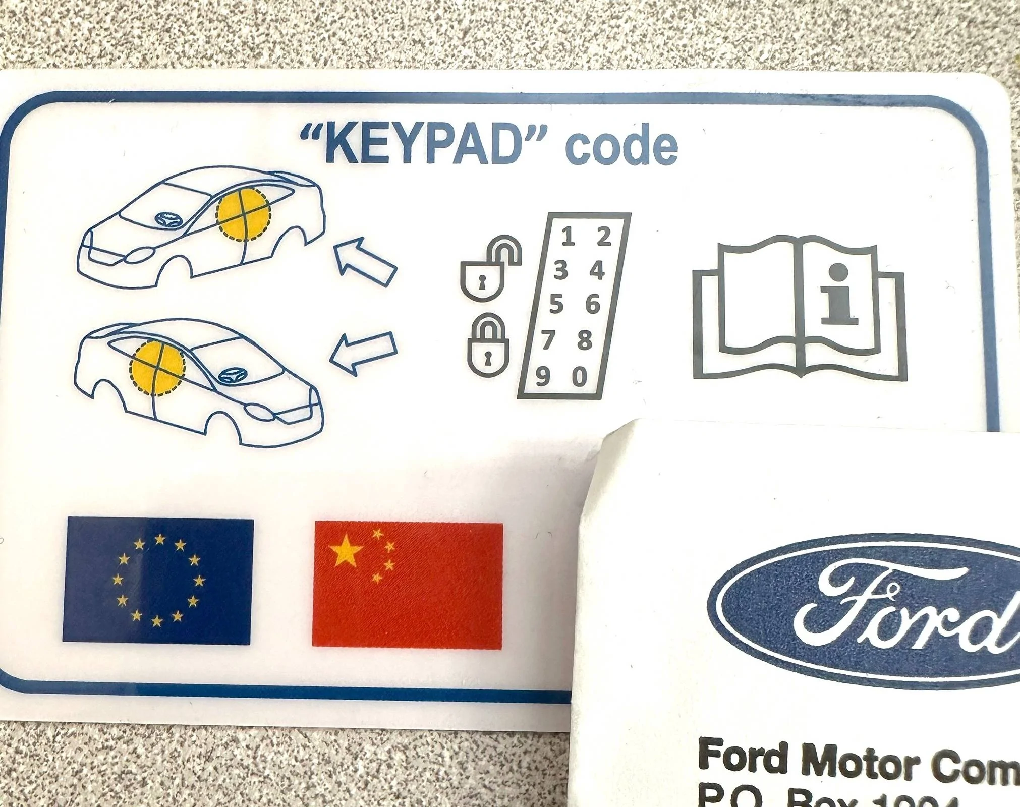

at time of delivery you should've been given a credit card looking thing with your factory door code. It should've come with your manual, fobs etc. might take a look at all your documents and glove compartment
Ah, found it!
The card has codes on both sides - US vs non US...
With that master code, can I open the door if I forgot what I set it to ?

Ah, found it!
One option to store this: Take picture and put it on your phone. You can then Search your photos for “KeyPad” or “code”, and it will find it. Be sure you take the picture of the correct side, I did the one above, then realized it was for the wrong country…
