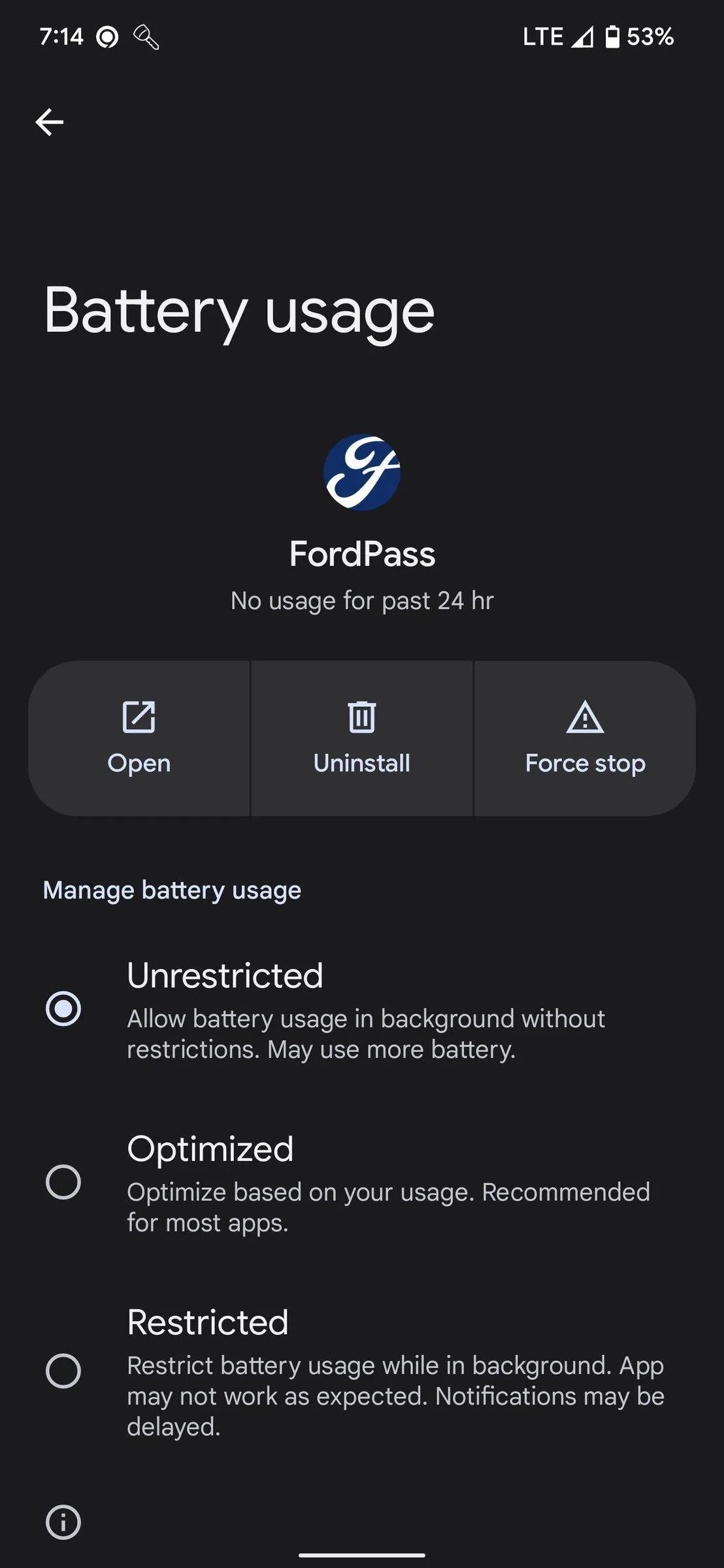

I honestly wish I could record my every day interactions with the car because PaaK is absolutely flawless for me. I've had my ups and downs, but being that I'm "slightly" tech minded I can usually find the reason for failures. Recently, I have discovered that disabling adaptive battery has massively impacted my PaaK experience for the better. I'm going on 3 weeks of not a single issue and opening/starting first button push.

The two main reasons for PaaK failure or poor performance, in my testing, are throttling and location access.
On Pixel devices we have something called adaptive battery. It's a form of throttling to maintain battery health. Other phones and OS' have their own versions. Basically anything that restricts Bluetooth power or connectivity to save battery should be turned off and location access should always be granted to FP.

Have you noticed an intense battery drain occasionally? I'm like you, in that I am tech-minded, and like to try and diagnose issues like this or at least identify the cause of failure so that I can remedy, report, or avoid it.
With adaptive battery off, and also with battery optimization off for FordPass, I find myself force-closing the app out of habit every time I'm done driving, so that it doesn't start its occasional severe background battery drain.
Of course, this means I have to make sure I open the app again every time I want to drive somewhere again.
I have no battery drain at all. It's not even in my list of usage items. As you can see by the key icon in the screen shot it's active and I never force close. I try to avoid going into FordPass at all costs because that's when I tend to have issues.
Amazing. I've got a Pixel 6 Pro, and FordPass usually shows up as the #2 or 3 in my list; sometimes topping it at #1 with around 6-20% battery usage. I wonder what's different.
Try disabling adaptive battery, make sure location is set to always (has to be done manually), stop force closing it and don't play with enabling/disabling Bluetooth. Lastly don't hide the persistent notification.
Let me know if you notice a difference. I've got the same phone. FWIW I also had a perfect experience on a 5XL and tested a 4XL with like results.
I'm in compliance currently with all of that... except for the force close habit (out of necessity, lol!) and hiding the persistent notification. But hiding the notification shouldn't affect anything... why would it?
I'll give it a try for a week nevertheless!
I agree that it shouldn't, but in testing with two different people we've found it caused issues.
