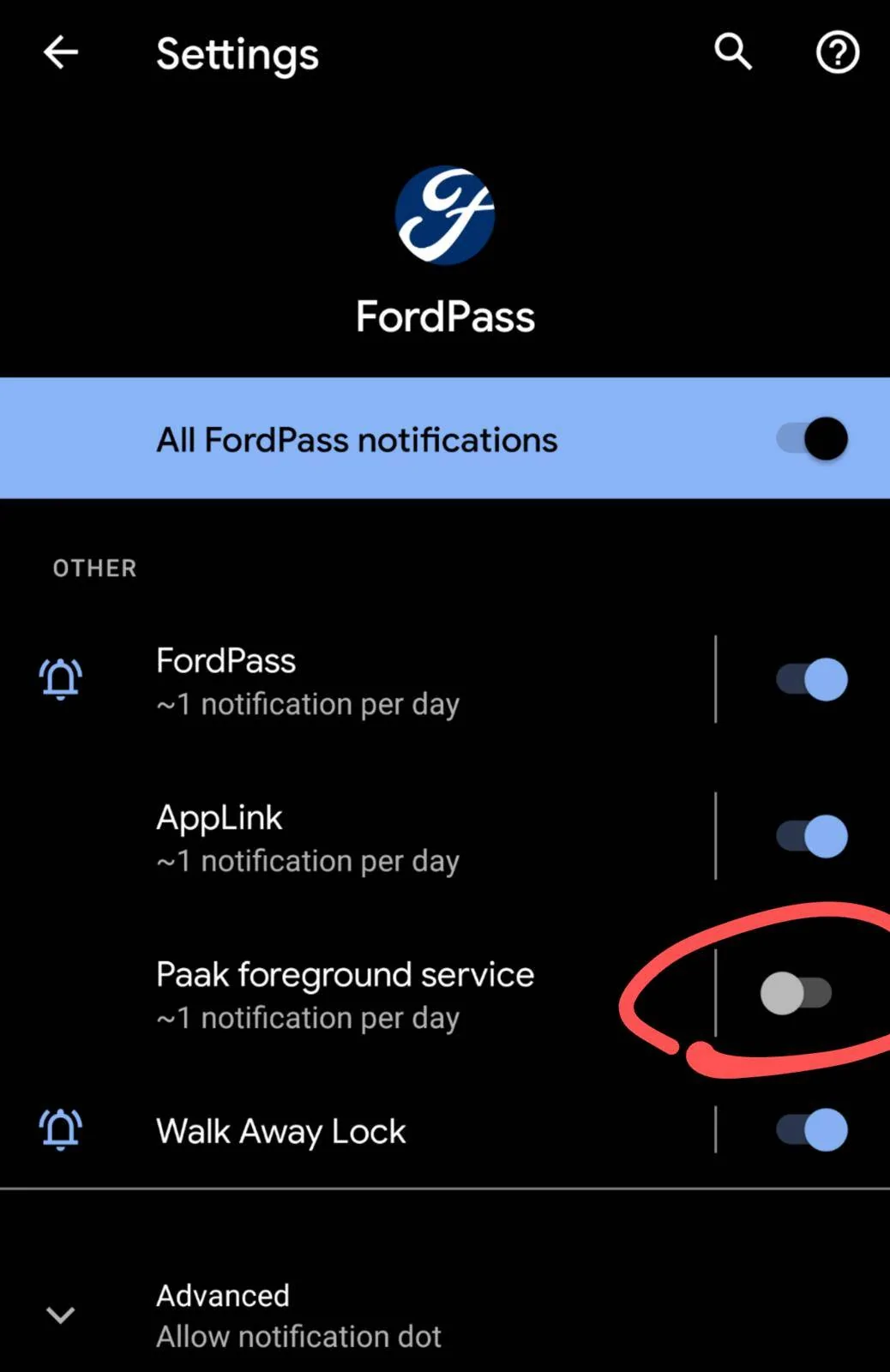

For those of us on Android (faithful old Pixel 2 XL here), this is the solution you need for this annoying notification, unless you care about seeing whether it's actively connecting or not:
Ford Mustang Mach-E PaaK notification always trying to connect Screenshot_20210325-223104
