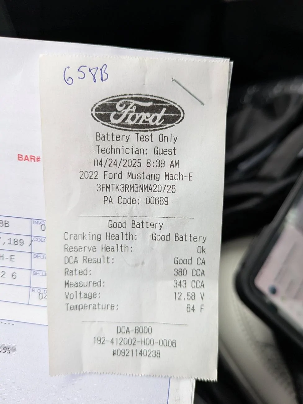

Ok it's finally time going on vacation for a month. Last week went to get my tires rotated and get the 12V battery checked my results +see attached.
I drive the car three consecutive days a week (m-w) and it's stored at my work garage till the following Monday. I make sure I run the car no less than 30 min using the auto power down if need be. I have been doing this the past 1 -1/2 years.
Also I run down the SOC of the HV to 30 then I charge around to 80 every two weeks. So my plan is to time it right and charge to 80 before I leave on vacation to hopefully top of the 12V. Should I go lower though? Run it down to 20 then go to 60? Saw the manual screenshot that says leave it at 50.
I'm prepared. Since the garage is gated and there are periodic security walks. I leave the doors unlocked.
So wish me luck. I am prepared of the battery dies. I have this is jump starter-see attached. I leave the doors unlocked.

I am happy to report that my car started. Tomorrow would be 4 weeks to the day since I went on vacation. Car parked in work garage. I turned everything off I think that would drain battery like, WIFI, auto updates, Bluetooth and even turned off motion sensor. What else? I left the door unlocked just like I said I would in case the battery went dead. I came in with my jump starter ready to use and thinking about the how to videos i watched on taking off the cover to get to the battery. The battery is older than three years now. I also loaded up the PSI on the tires and deflated them to spec as the car was running.
