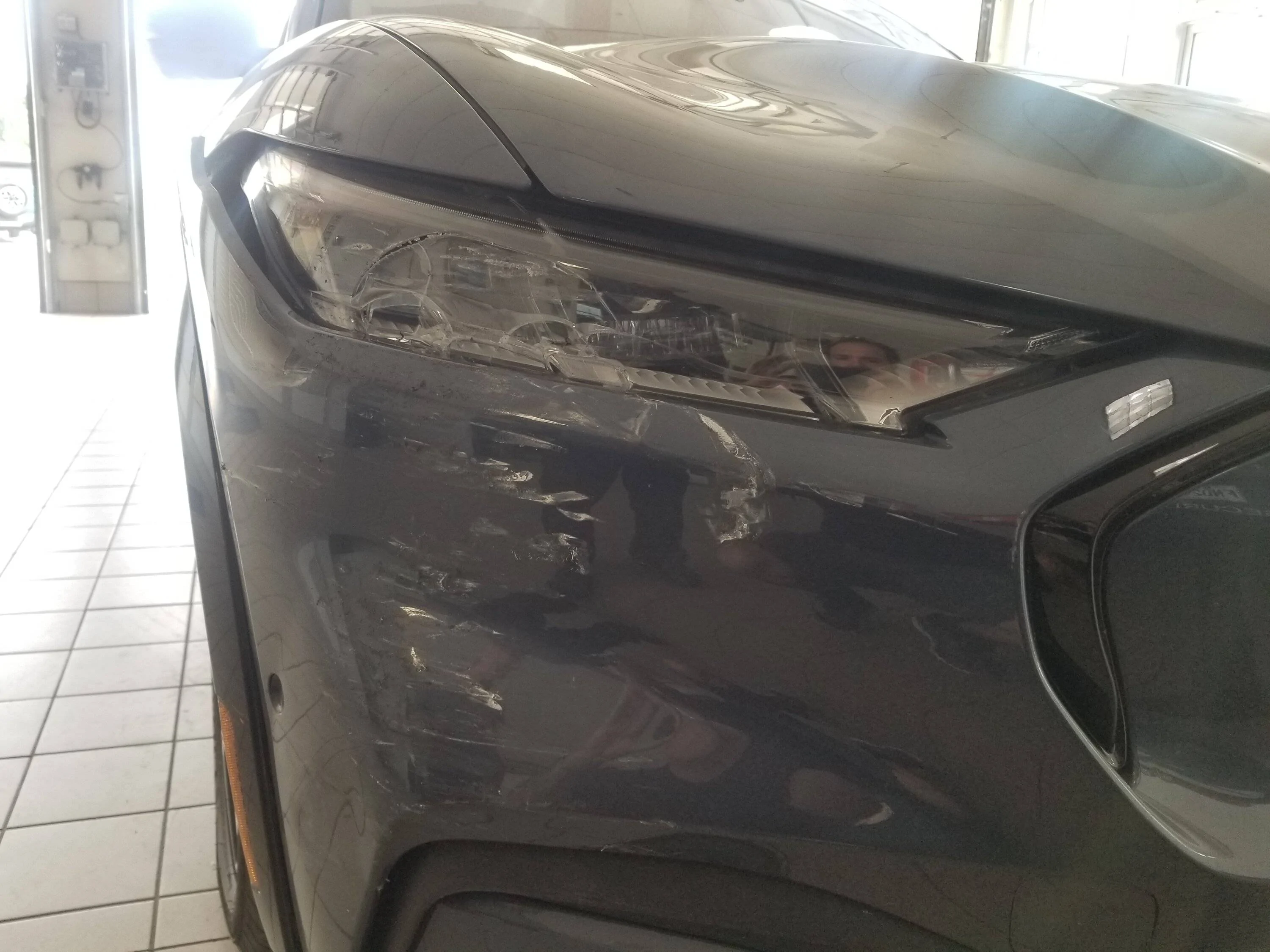

Damage wasn't as bad as i thought. It looks worse because of the PPF. My main concern is the headlight considering everything i read over the weekend about the headlight shortage.
Ford Mustang Mach-E Parking Brake issue since 2.7.4 20220629_102446
