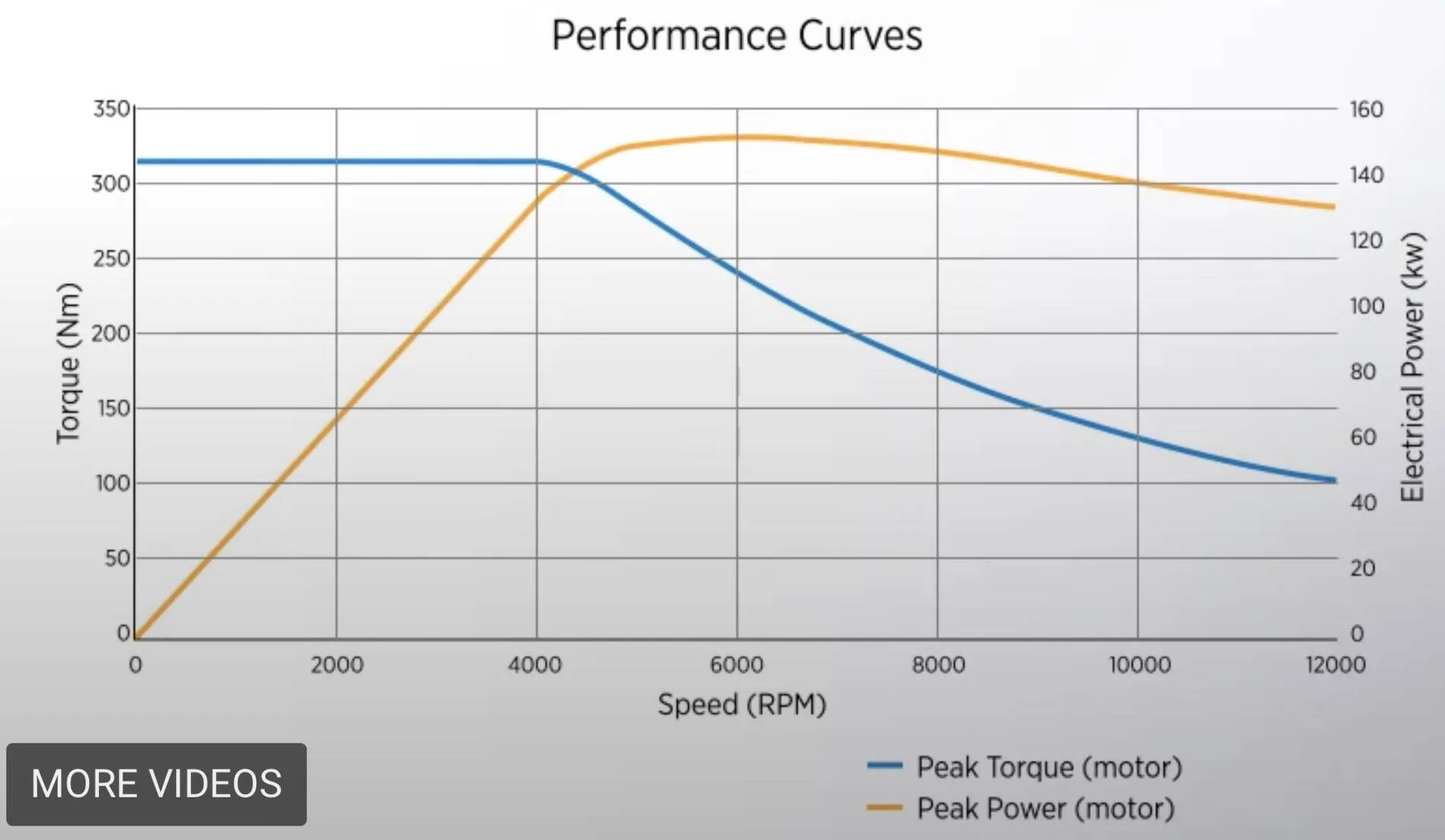

Not the Mach-e motor, but this is from the IDM video that you posted a link to:
Ford Mustang Mach-E Performance Question Screen Shot 2020-10-07 at 5.11.07 AM
DC electric motors have a synchronous speed based on the number of magnetic poles and input power frequency. At that speed, the back electromagnetic force from the rotor (spinning magnets) is in balance with that of that produced by the static coils (outer, non-spinning) to spin it. For the graph above, that point seems to be 4000 rpm. Synchronous speed is the "max current" condition for the motor, kind of wide open throttle for a dc motor.
The motor experts can chime in, but I don't think any electric vehicle motors operate above synchronous speed. To go above that speed, you have to apply electrical or mechanical field weakening. You are already at max current, so you are really just removing the resistance (back emf) from the rotor field. To weaken the field, you have to do some things with the input power control, all of which reduce power. That's why you see the horsepower decrease above synchronous speed.
Motor experts, please simplify or correct...
