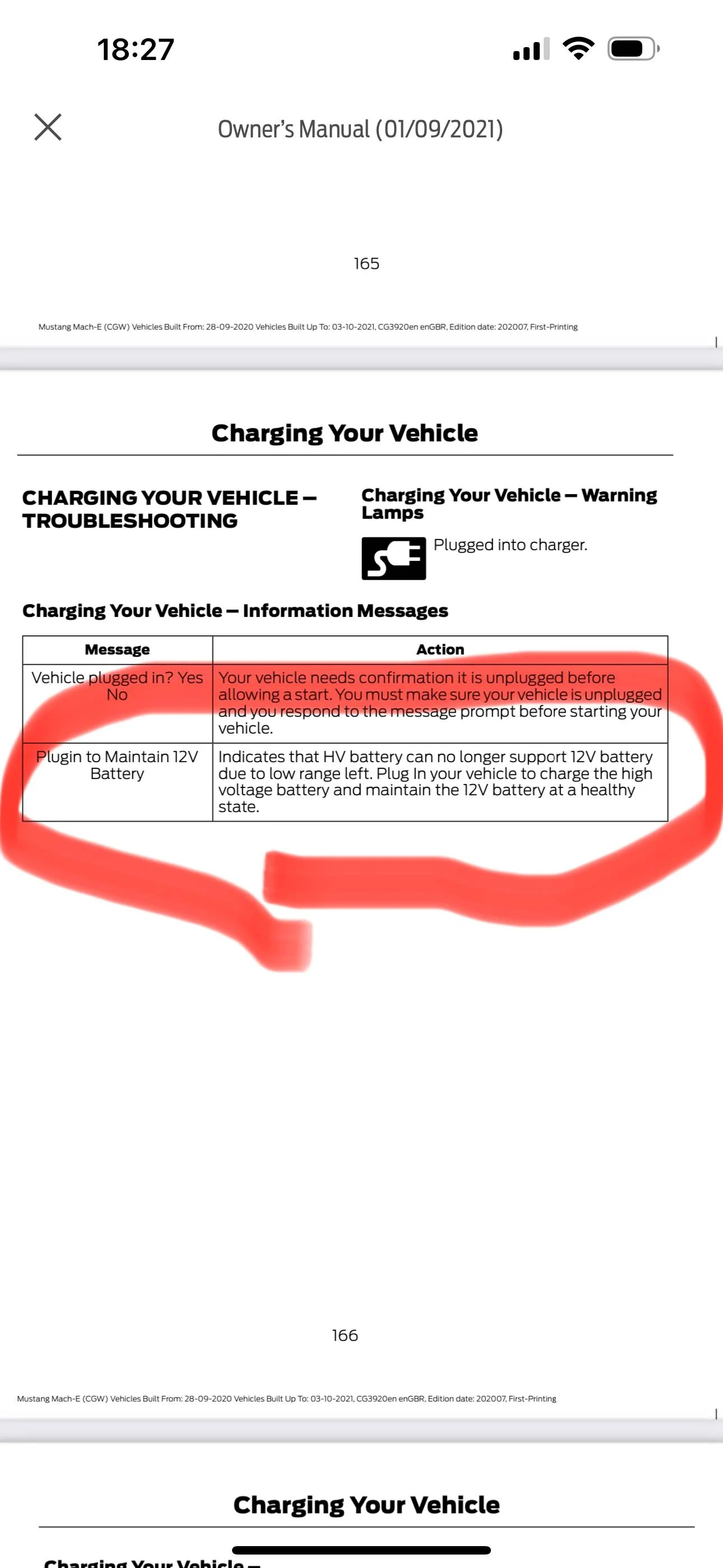

The only time we should see the attached message is if we allow our HV battery to get too low on charge:

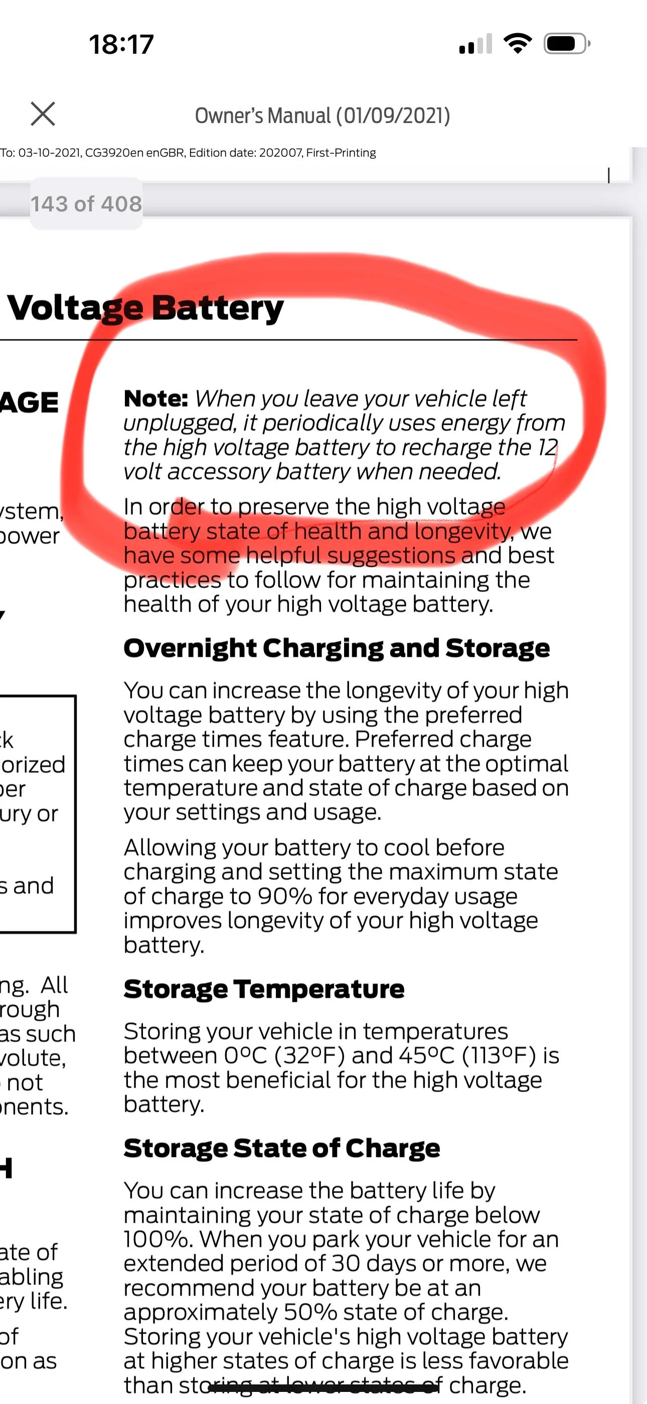

Otherwise the following applies…..
