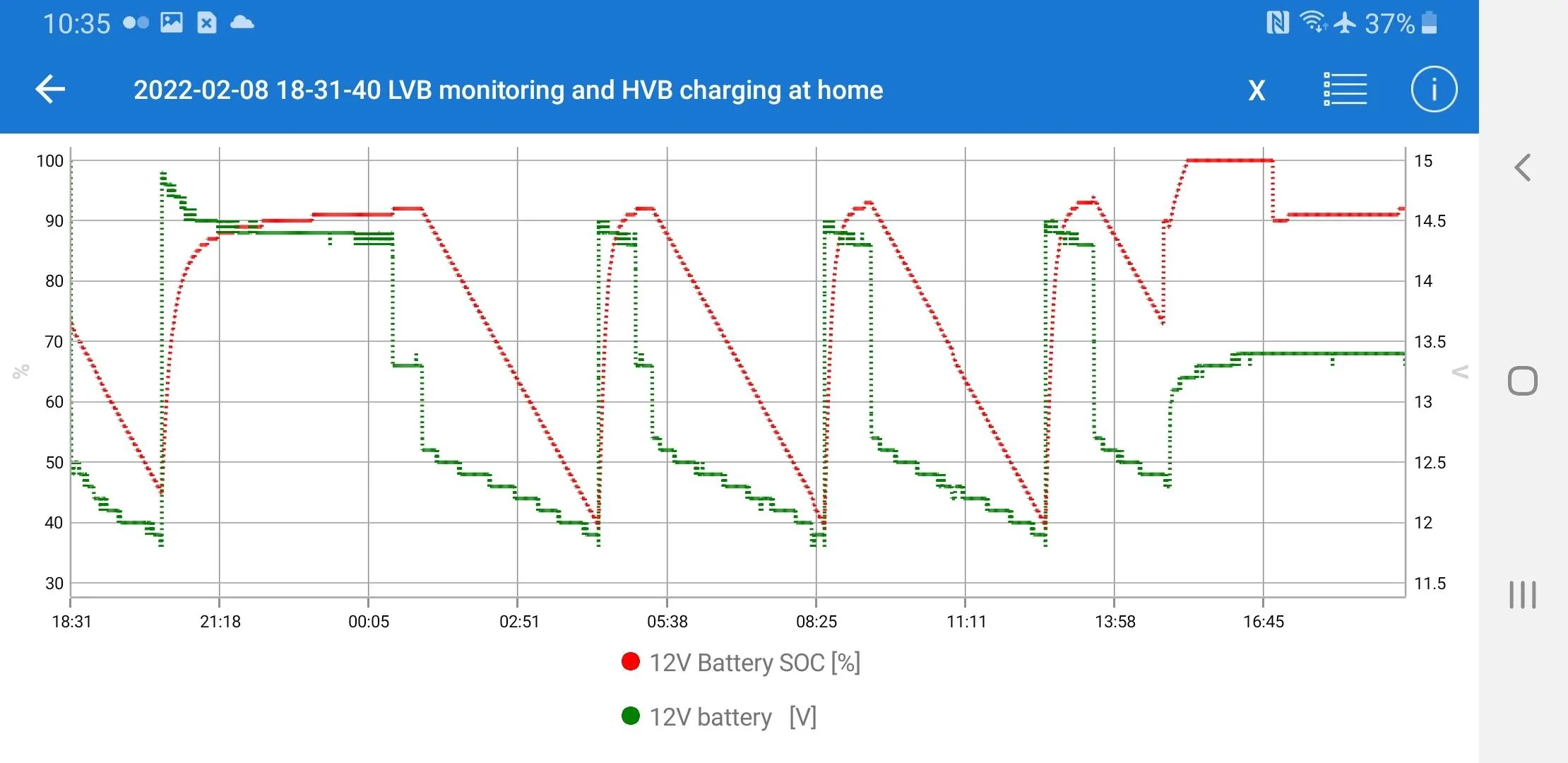

I measured it myself using CarScanner and it does just what Lee said: at 40% the HVB will charge the LVB. Of course 40% is very low and not good for the LVB, so whatever is causing it to get that low needs to be corrected.
See below for what happens when the LVB hits 40%.

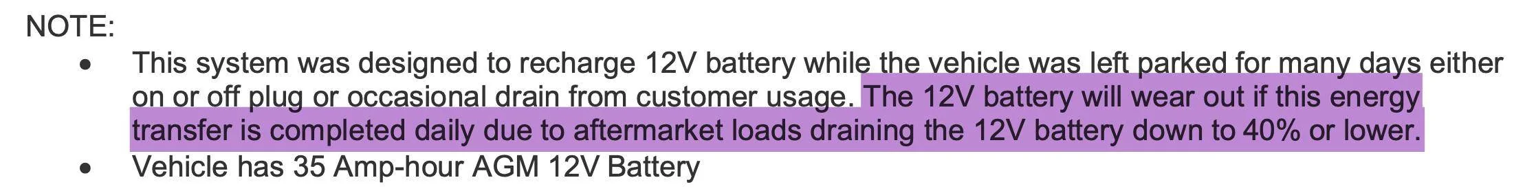

So when the "System off to save battery" message came up, I fired up my scan tool and saw the 12V SoC was at 50%. That was some months ago so I'll have to double check the exact %, but I'm pretty sure it's in that neighborhood.
Multiple threads in the past have observed the 40% recharge threshold, here's one. I've also observed it in my own 12V battery drain testing. EDIT: You can also see it in Mike's data graph above.
I've attached the technical description of the Mach-E charging system that describes the 12V recharge process in more detail.
I would also like to highlight this note from the bulletin:
