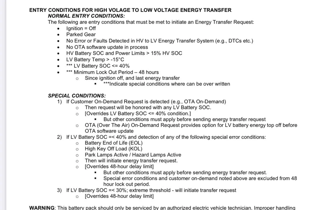

I've attached the technical description of the Mach-E charging system that describes the 12V recharge process in more detail.
I would also like to highlight this note from the bulletin:

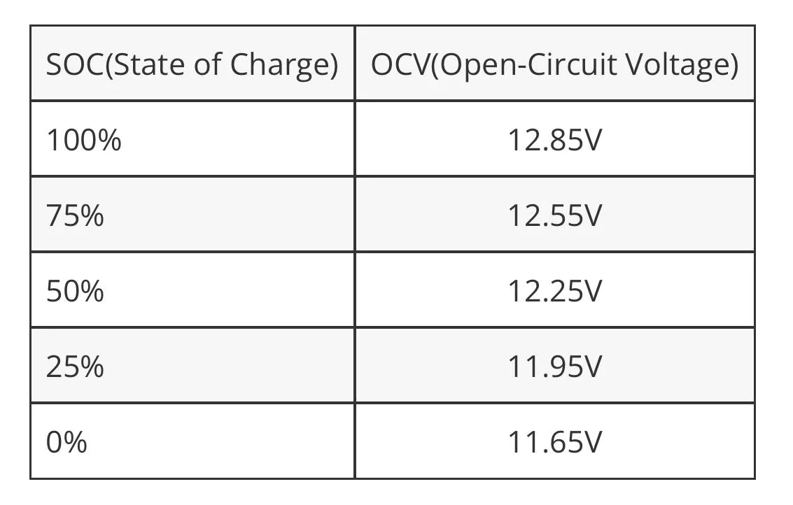

For context, I don’t think those percentages of 12V battery charge levels are anthing to get excited about because 40% charge doesn’t mean 40% of 12V or even the full voltage of an AGM battery which would be 14.2V or more.
The attached chart illustrates.

At the risk of overthinking and undue worry, because the pre-requisite conditions are so numerous and their analysis are outside the expertise of the layman to even understand and check a dealer probably ought to take a look.
Prerequisite conditions are summarised in image attached, fuller details to be found in the linked document already posted here but I would read it VERY carefully and understand the context of each and every part trying not to read what you want into any part.

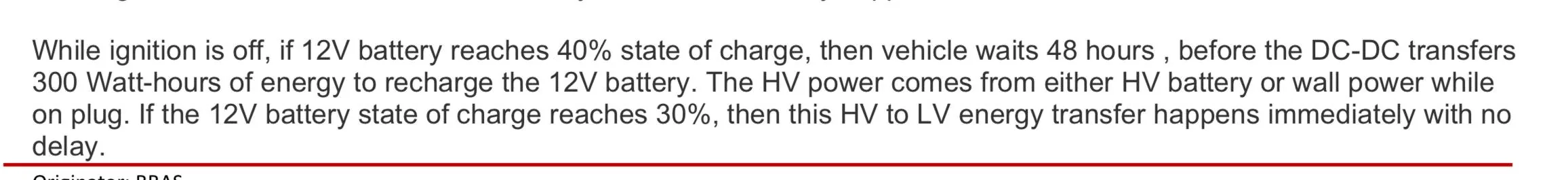

Ford say this:
ā€œWhile ignition is off, if 12V battery reaches 40% state of charge, then vehicle waits 48 hours , before the DC-DC transfers 300 Watt-hours of energy to recharge the 12V battery. The HV power comes from EITHER HV battery OR wall power while on plug. If the 12V battery state of charge reaches 30%, then this HV to LV energy transfer happens immediately with no
delay.ā€
To assist with an understanding of LV percentages, see attached chart, 40% or even 30% SoC for LV isn’t as low as it seems.
