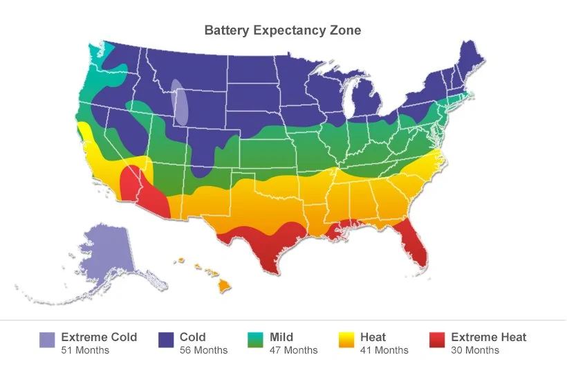

Again, battery lifespan depends on the temperature it's exposed to, heat kills them faster:
Ford Mustang Mach-E Plug in to Maintain 12V Battery 1569910488880-png
In Minnesota 5 years is typical, but where you live now they will only last about 3 years because of the heat.
