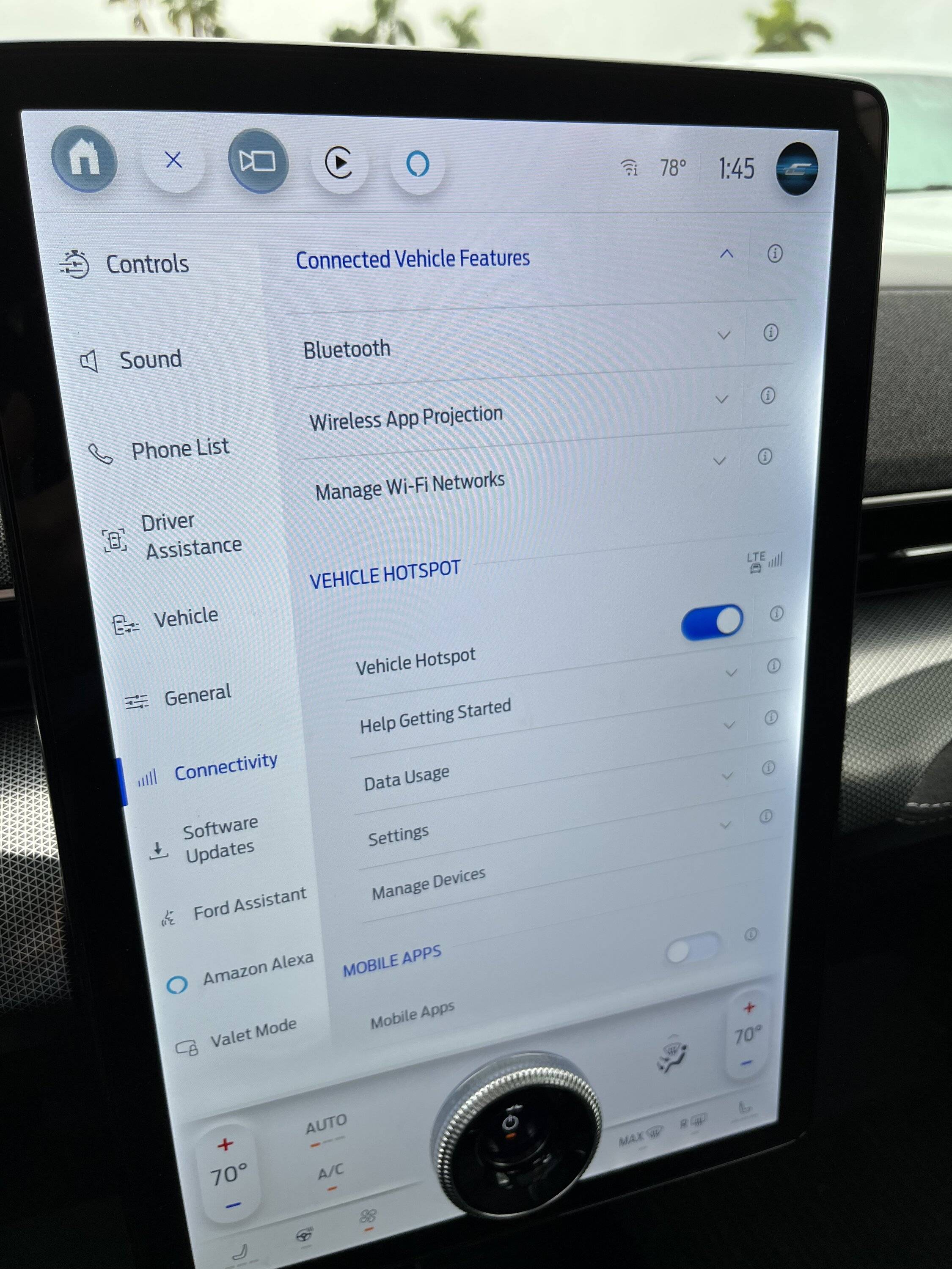

Thanks for this. Your workaround worked for me.
I was wondering why my connectivity menu was missing. When I hit the button it looks like this-
Ford Mustang Mach-E [Possible Solution] Intermittently missing connectivity settings IMG_9554

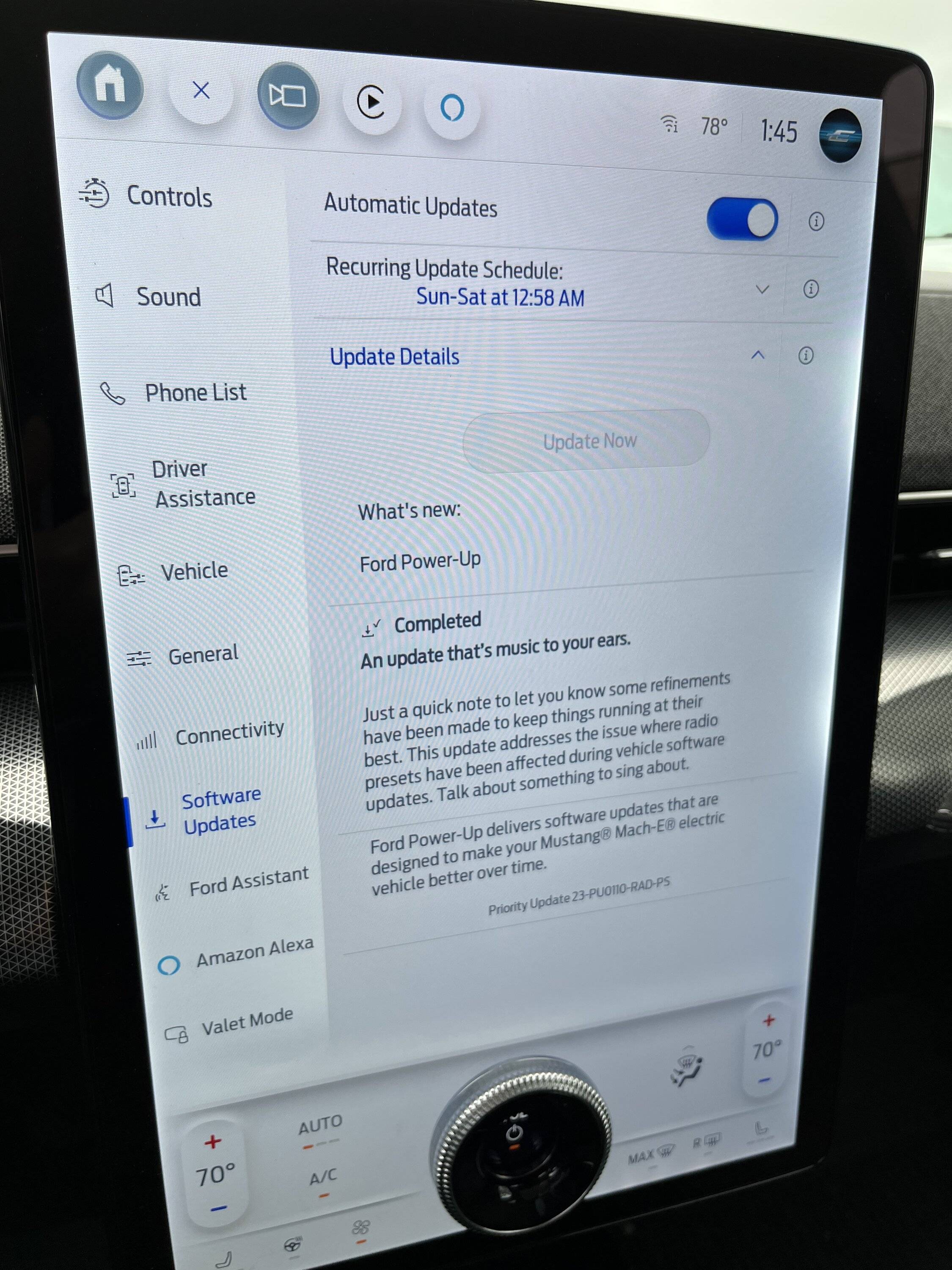

I wonder if this has anything to do with me getting no updates since August 7.
Here is my last update-
Ford Mustang Mach-E [Possible Solution] Intermittently missing connectivity settings IMG_9555
