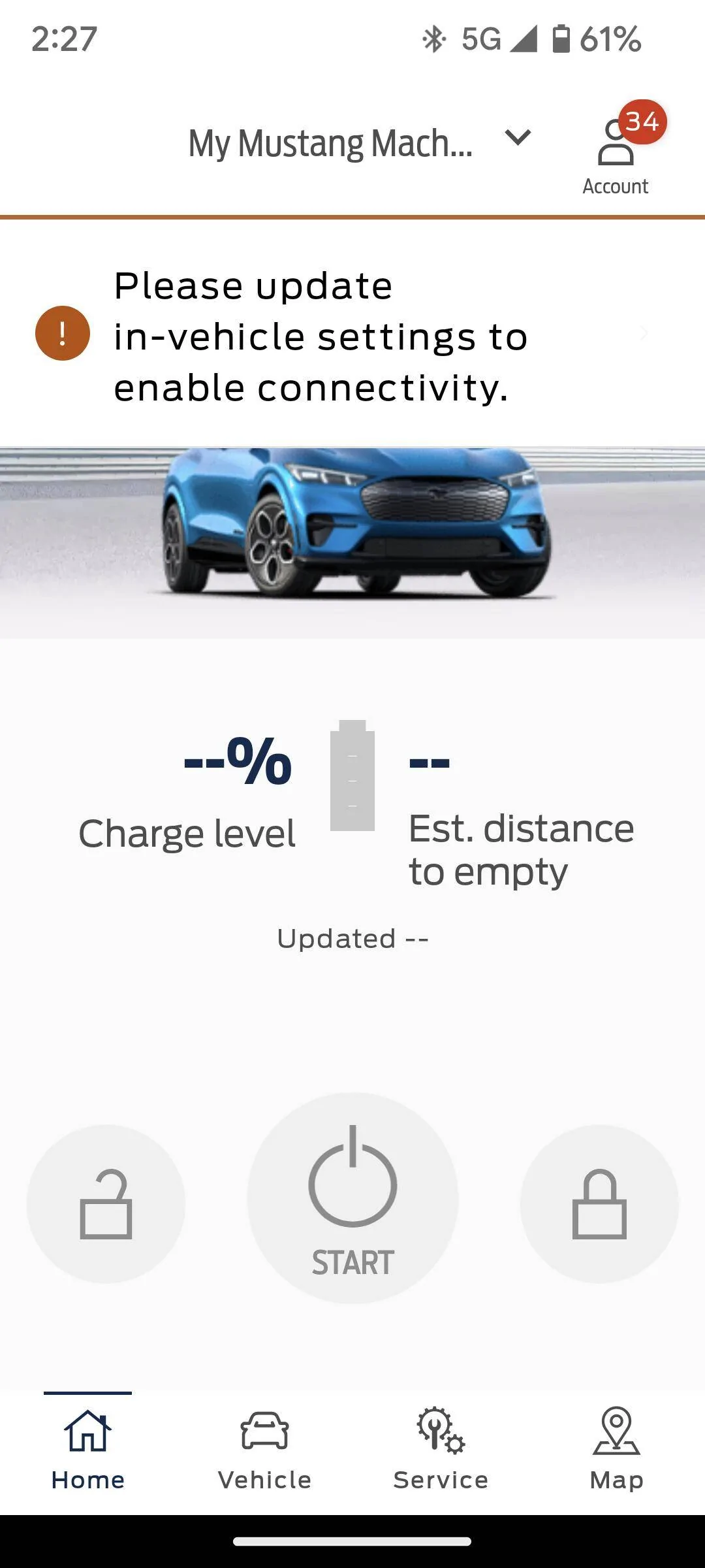

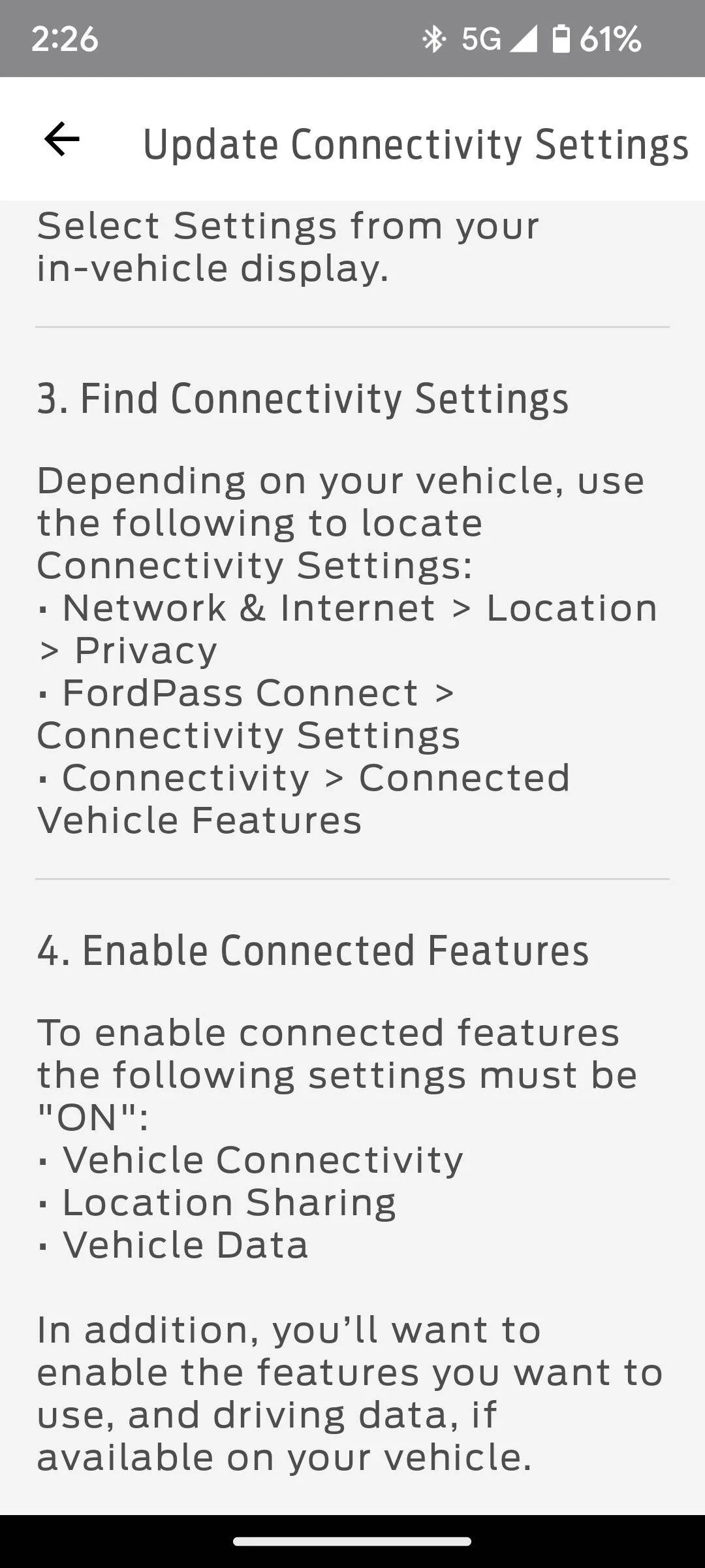

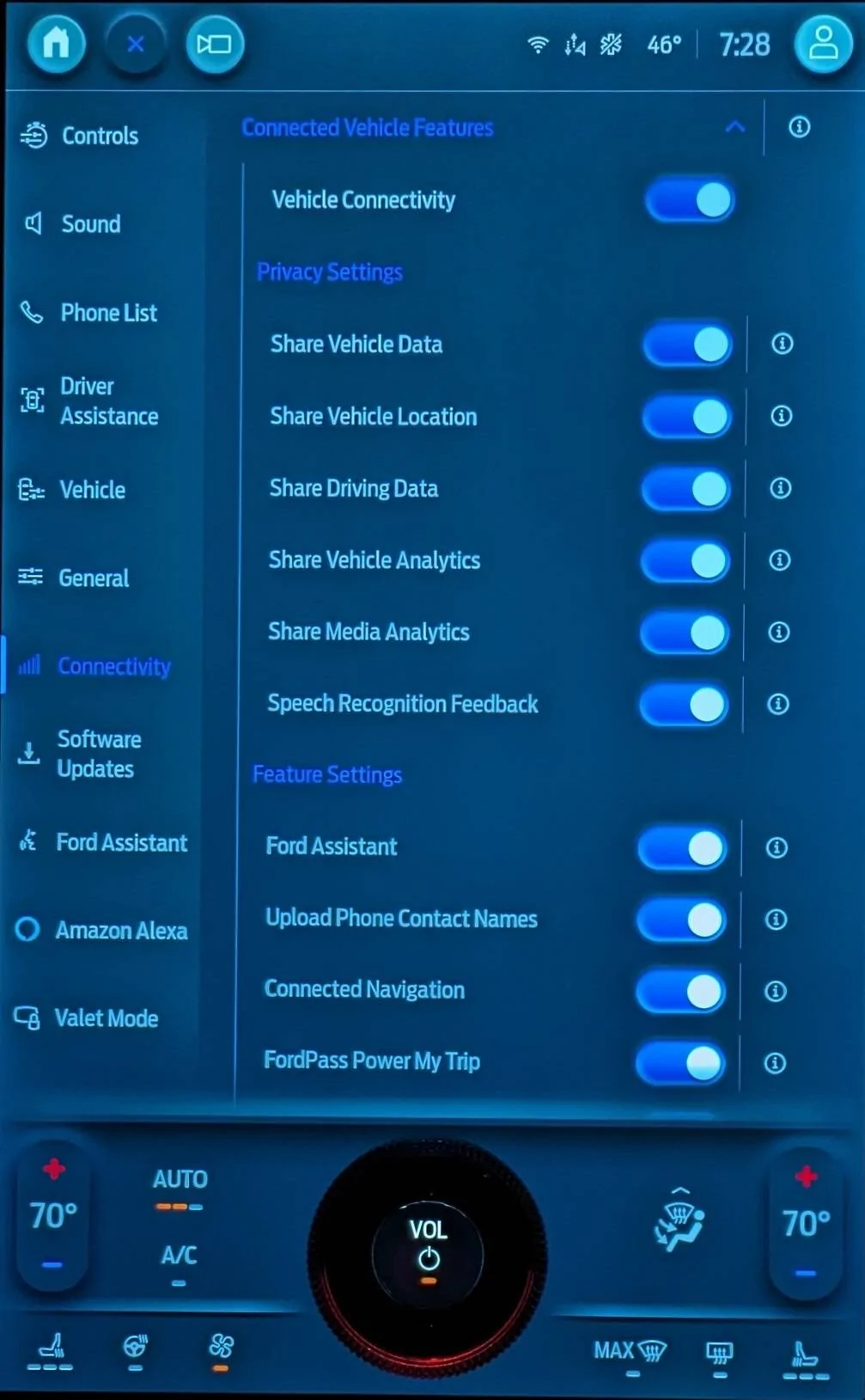

I have the same issue, but I cannot turn Connectivity off (i.e. can't update privacy settings). Additionally the app doesn't let me remote connect to the car, as it tells me I need to turn Connectivity settings on (I'm on 6.2.0).
Try deleting your car from the FordPass app and adding it back in.
Nope. Now the car won't connect to the FordPass app at all, so I can't see any info on the Mach-E. Meanwhile on the Mach-E, everything is the same (Connectivity showing as enabled, but there is no indication it is connected).
It's at the dealership now, trying to figure this out.
