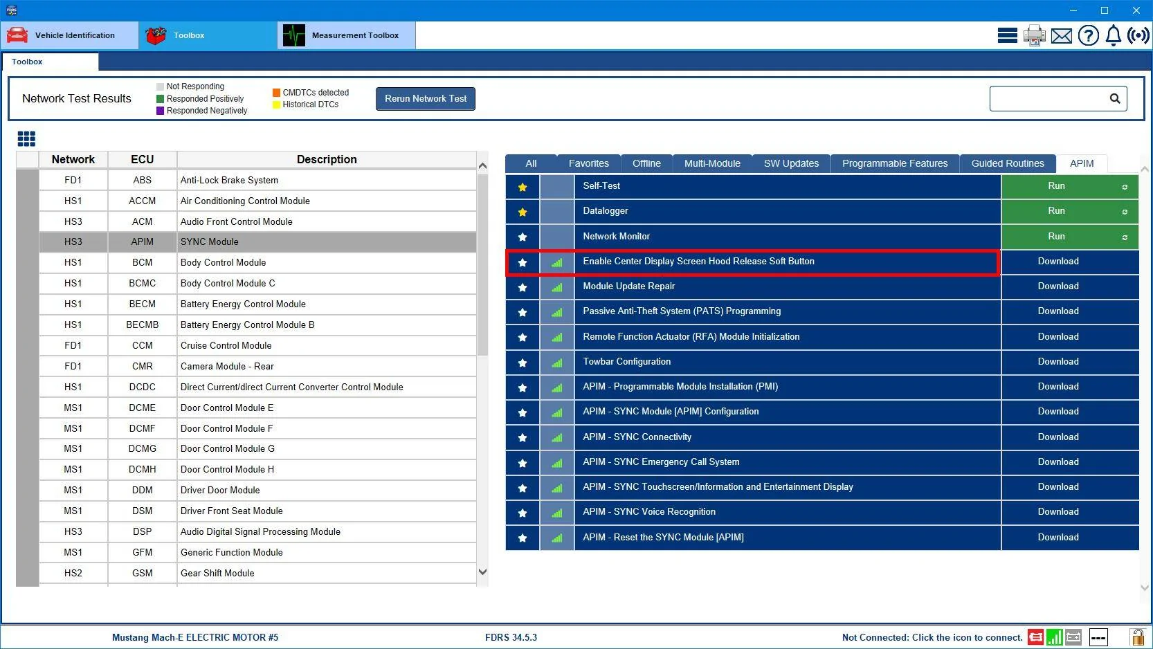

On the Frunk button thing for '21J1...here's the part I don't understand....
It would have been SO easy to fix.
Search all the '21J1 asbuilts and update the one segment that adds the frunk softbutton to Sync. This is a server update. They can do it from their end.....just like they corrected the BCM data for the TPMS system on the new Lightnings they sent out with the wrong tire low pressure warning threshold.
Then push an OTA for the BCM and GFM updates as a technical update just for those cars. Unless there's something else I'm not aware of that should update this issue for everybody who has it.
The only thing I can think of that's keeping them from doing this is that they aren't confident that either a BCM or GFM update will actually work OTA. Why else would they put a procedure into FDRS specifically for the techs to enable that softbutton on the Sync screen?
Ford Mustang Mach-E Power-Up 4.2.4 software version released Frunk_Button_Enabl
If doing this by OTA isn't an option then @Ford Motor Company ought to identify those '21J1 vehicles in the asbuilt database that specifically still do not have the Sync frunk softbutton enabled and send the owners a notification letter of a Customer Satisfaction Program that will enable them to get the BCM/GFM updated and the frunk Sync screen softbutton enabled by a tech at Ford's cost.
I think if they put one...maybe two interns on this they could have it done by this time next week (if you can get them off their phones).

Maybe they're worried it will possibly pop the frunk during an OTA install? That's the only on I can come up with.

Totally agree Mike. I think they are very nervous about bricking the BCM with an OTA because there could be no recovery from a bad flash. BCM would have to be replaced so that would be a massive fail. OK fine, so then they should do a dealer update CSP instead. But upper-level management falsely believes the frunk button was enabled on all Mach-E's already, so they won't pay for it. Something like that.
Then there's FordPass. They should just enable the frunk button on all Mach-E's already. A server change shouldn't be hard. If the button in FordPass doesn't work, then you go to the dealer and get the update for it.
