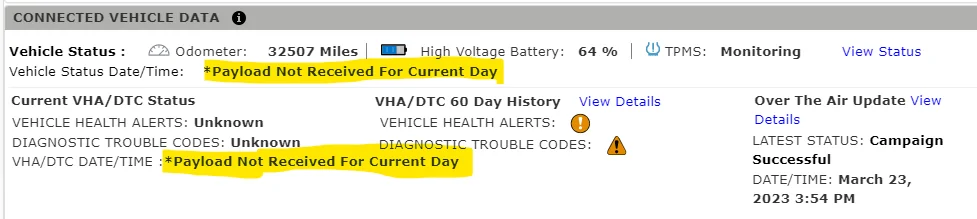

Update: pulled fuse 11 from the passenger foot well fuse box and connectivity is restored.
Got 4.2.4 installed last night to update the Telematics Control Unit. Now my car won't phone home to the Ford mothership.

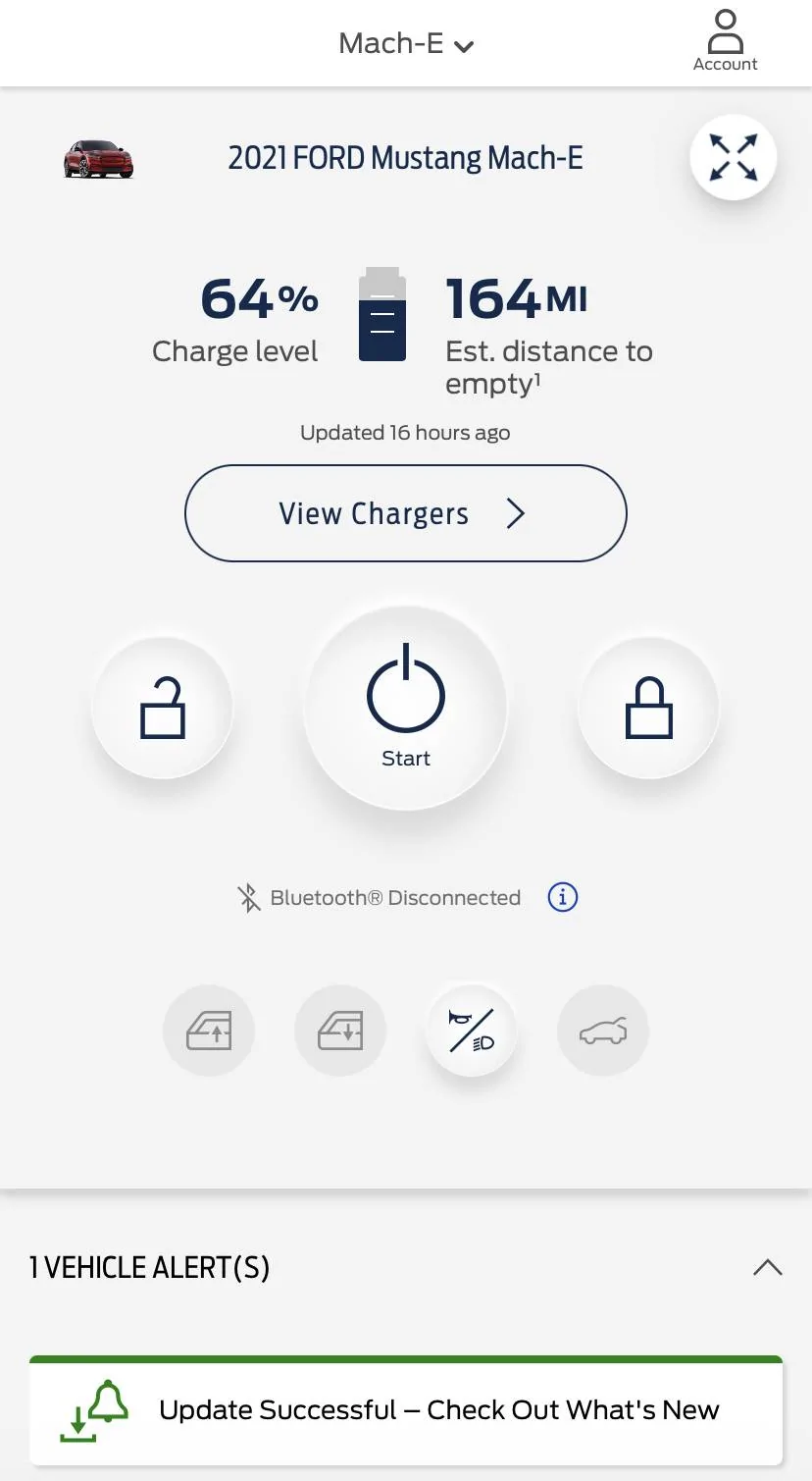

FordPass is stuck at last nights SOC reading as well (16 hours ago). I drove the car 30 miles to work today....no update. Force close FP and rebooted phone. Weird.
Happened to me on a failed install FP noting car stuck where it updated for a month. No ford pass no conductivity to the car but Bluetooth (paak) continued to work. Do you have control of your conductivity settings in sync or are they locked? Had to be fix in the shop here.
Are you going to try the TCU fuse?

Thanks for the recommendation. It worked!!
I did the fuse pull awhile back and it worked, but then the issue kept coming back and I was pulling the fuse every few days. I eventually deleted PaaK cleared out my phone and re-paired everything, I havent gotten that issue since. It was one of the early 4.1.x updates that did it to me.
