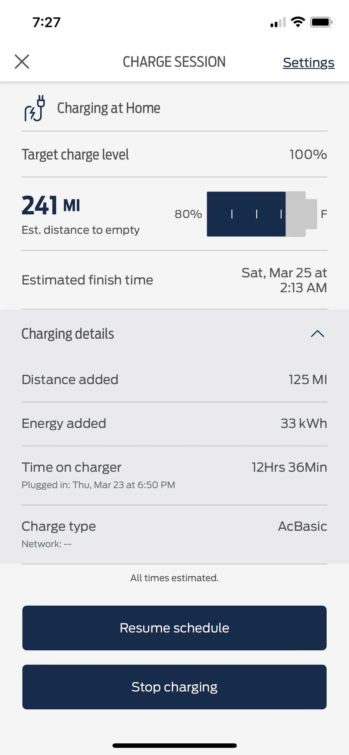

Odd I don’t get the charge rate when using ‘charge to 100’. Actually the more I look the more this is telling me it’ll wait till 11pm tonight to charge anyway, even using the charge to 100 button. I closed and opened the app a handful of times. Car is in the garage on Wi-Fi. That 7:27 is this morning’s

Oh wait. This is Powerup not FP update. I'm derping.
