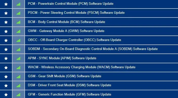

I have an identical situation (stuck on 4.1.1 since Jan). Mike G took a look with FDRS - this was his response:
I haven't seen this before but on the other hand I knew it was possible...
You do have a gateway revision that indicates you got 4.1.1 ("-LAD" rev.).
And you're correct the next thing should have been the APIM update in your list, but for some reason that didn't download yet. (you can ask your service advisor on the phone to check your OTA dashboard and tell you why).
And the new wrinkle is you have the next gateway (GWM) update already in your list. this may be somehow blocking you getting the APIM.
Despite what the normally recommended sequence is for updating (GWM then APIM then TCU) I strongly recommend that if a tech does this update to fix your car that he/she goes straight to the APIM first before doing that GWM in the list just to try to follow the sequence that should have occurred (the 4.11 you got, followed by the APIM/4.1.2 you haven't gotten yet, and then that next GWM/4.1.3- which could actually be 4.2.1 at this point since it's been that long.)
Hope that makes sense.
Here's the list this morning:
Now I realize that most techs don't think highly when customers come in and tell them what "the internet" thinks they ought to do. So diplomacy is best.
I've got an appointment with Encinitas Ford April 5th - will let you know how it goes. Buy the way This is my second time being stuck.
Thanks for posting this. It gives me some idea of what is going on.
