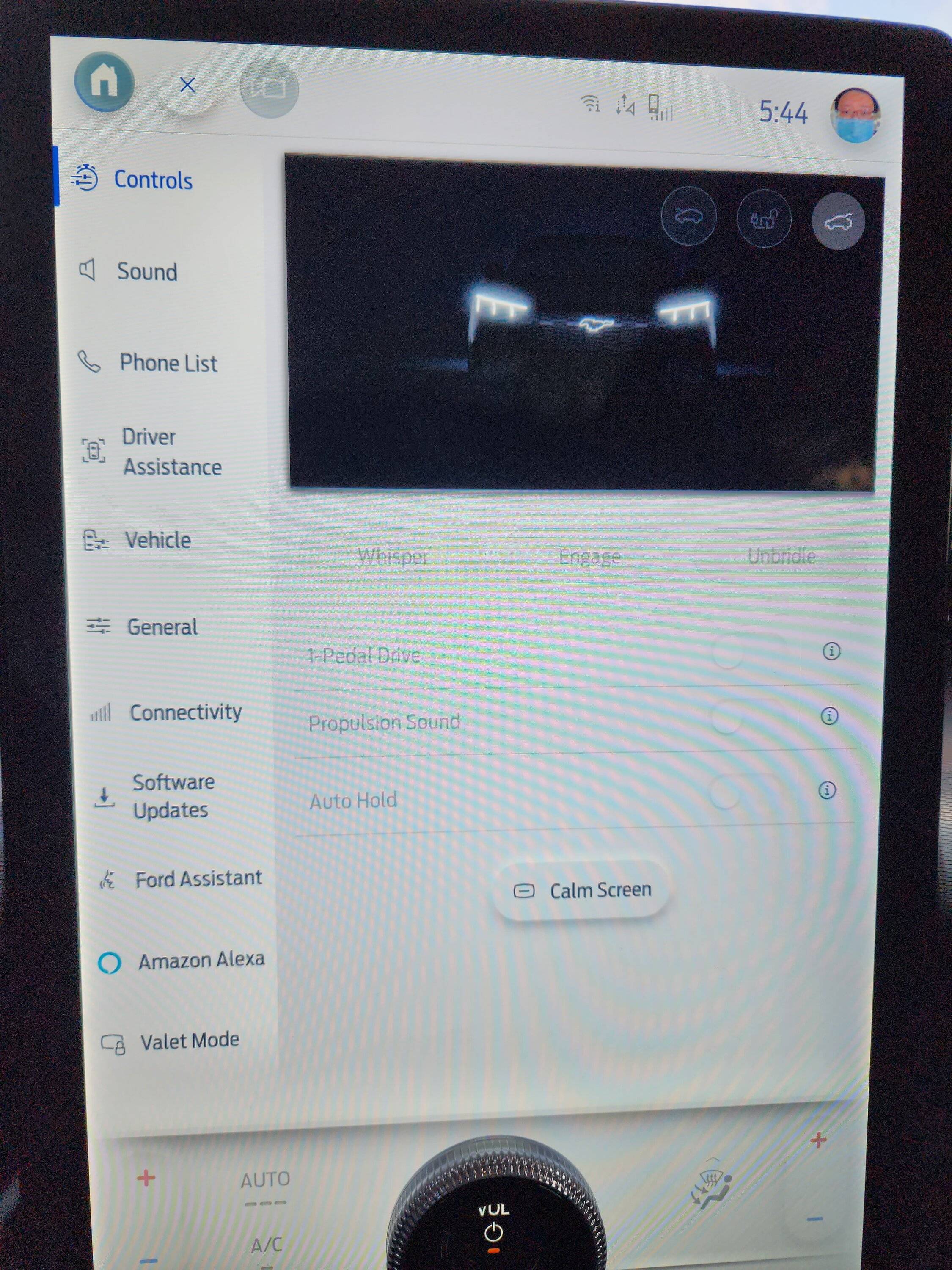

Randomly driving and then drive mode changed on me. Saw drive mode unavailable on screen. Car launched off all of the sudden and almost rear ending a car. It went from unbridled where it was auto slowing down for a red light to sustained speeds of whisper.
Afterwards I could not select a drive mode and the modes were black.
Ford Mustang Mach-E Power-Up 6.1.0 OTA Update 20231016_174510
Maquis
4,446
6,157
That’s happened to me 3 times since getting this update. In 2 years and 8 months I never saw “Drive mode unavailable” once. Now 3 times in just a few days.

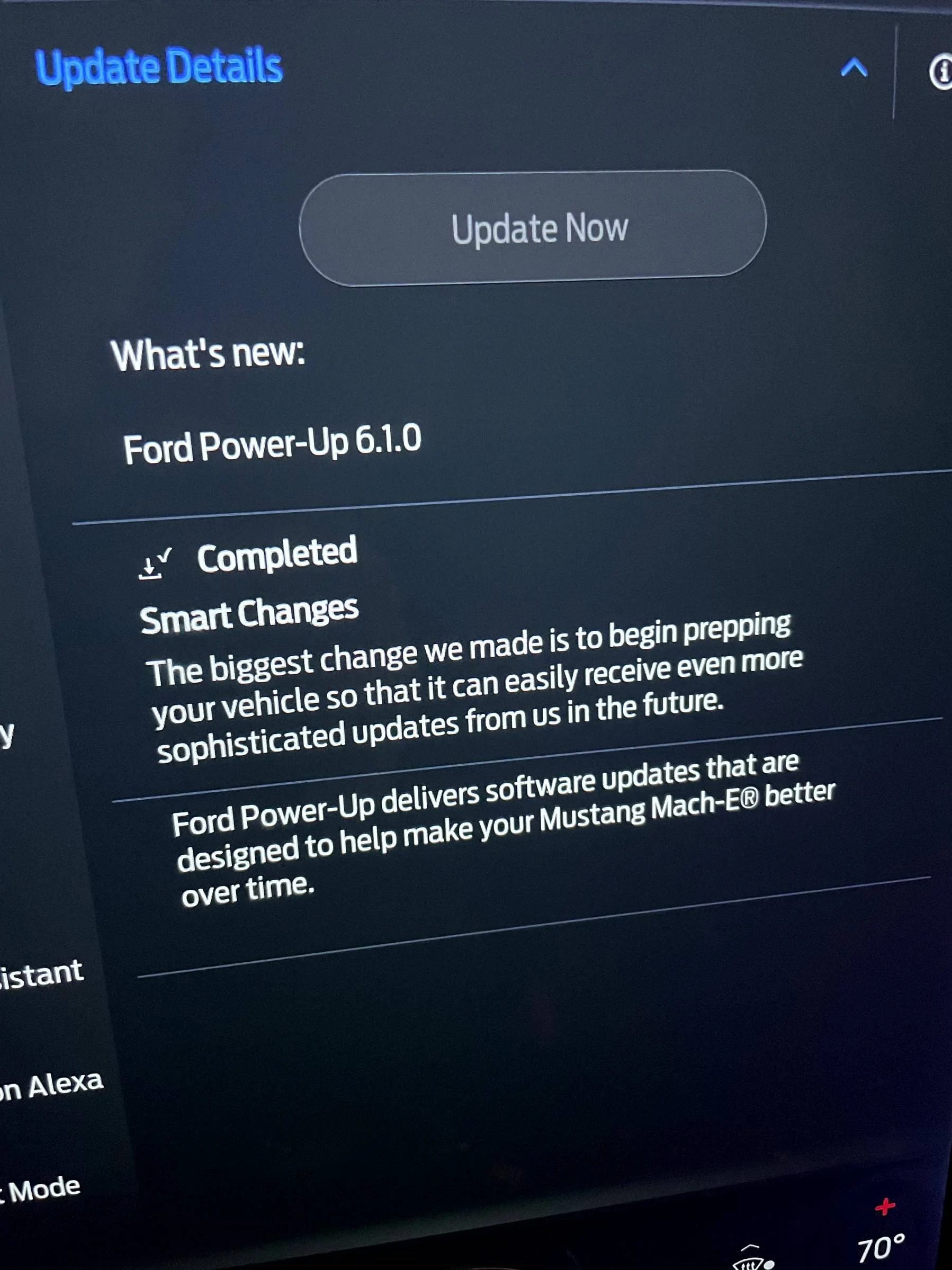

My car was stuck like this as well.
I have the needed FDRS equipment so today I applied the GWM update that is 6.1.0.
After the update was applied I checked the status in the car and the car now believes that 6.1.0 was applied.
Ford Mustang Mach-E Power-Up 6.1.0 OTA Update IMG_4737
Hopefully Ford can push this through without a need for FDRS.
After the update was applied I checked the status in the car it the car now believes that 6.1.0 was applied.
Glad that you got this sorted out. Unfortunately, I do not have FDRS but I have reached out to my service advisor. Hopefully they get this addressed. I too wish Ford can address this without the need for FDRS or a service visit.
Just happen to me again
