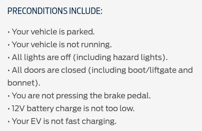

blower method got me to 95 SOC. Followed all steps and let it sit for 45 while updating. Came back out and still got the "install interrupted by a process" error. I have to charge at home tonight as I have a 4 hour round trip drive tomorrow. If that doesn't kick it in gear I will try some of the other methods.
Battery is charged enough. So you're pressing "install now" and then shutting off the vehicle? What are you missing from this list?
I am missing nothing from the precondition list.
press install now, it asks me to shut off the car, I shut it off, timer comes up, I open the door, get out, close and lock the car. Parking break is also on
OK. And just to cover everything, you have all USB and OBD2 port devices unplugged (including cables)? J1772 unplugged? And are manually turning the headlights off before starting the update?
