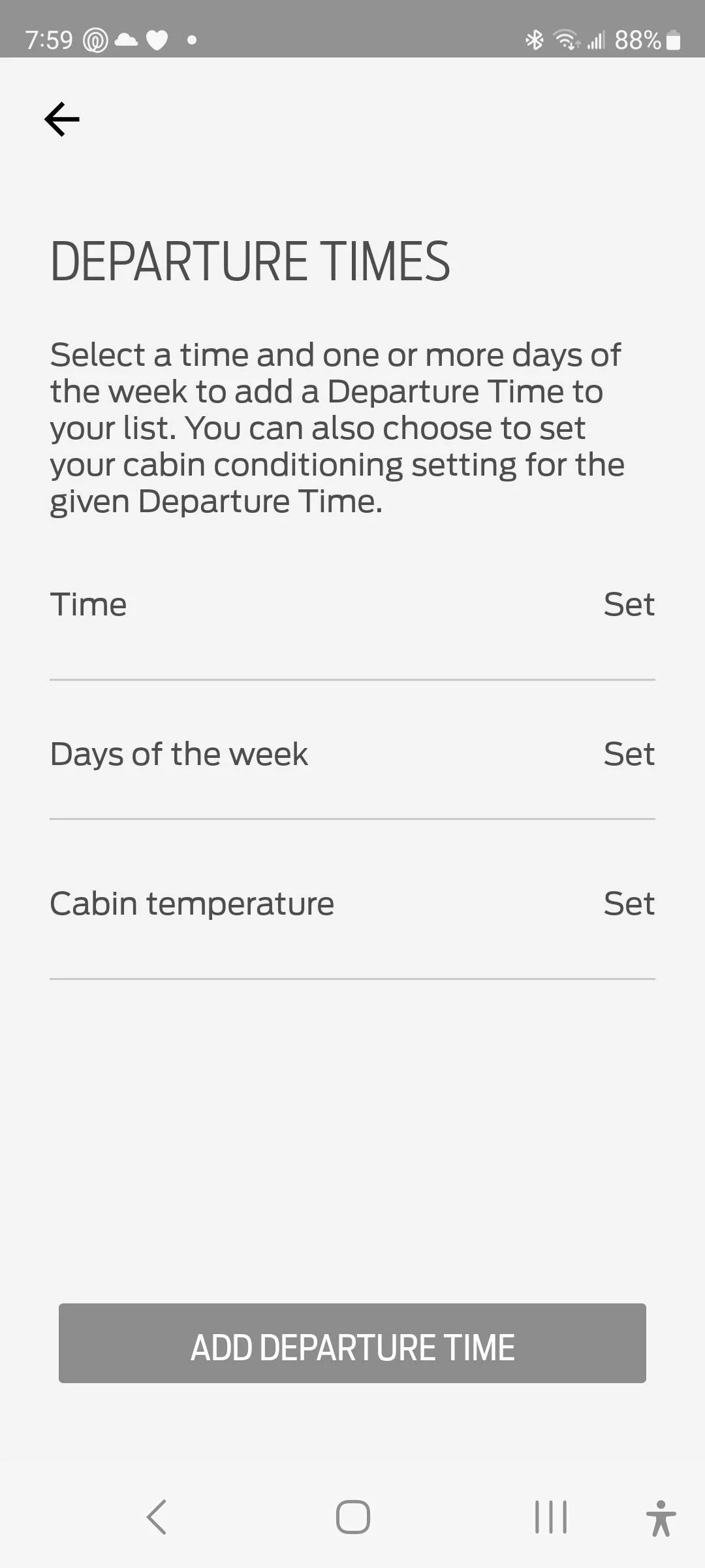

I just looked, and Departure Time does have a cabin temp setting as part of it. So it appears to do both. Or at least is intended to do both.
Ford Mustang Mach-E Preconditioning Improves Range up to 20% [Ford Brochure] Screenshot_20230506_075918_FordPass
267
17,957
27,994
Correct. But it does the cabin AFTER the battery is done.

My take is that this is way too much to ask any manufacturer to do.
"I want to leave in 17 minutes, so heat the battery for 12 and then the cabin for 5, then I can complain about the lack of range I got because I didn't plan ahead."
What should happen is that the app / vehicle should be able to feedback, "it will take XX minutes to precondition the battery and warm the cabin, do you want to do proceed, or instead do a remote start XX minutes prior to departure?"

They already thought of this with the current departure times implementation. The cabin is warm 5-10 minutes early, and continues to run for 15 minutes after the scheduled time. The only thing you might miss if you come early is the heated seats might not be fully warmed up yet because I think those turn on at T -5 minutes.
