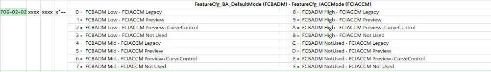

Yes. You can turn off predictive speed assist in the driver assist menu. Or, you can disable it completely with FORScan in line 706-02-02 on the IPMA. Change the 2 here back to a 0 to match the Bluecruise 1.0 config. Lane change assist and in-lane repositioning will continue to work.
