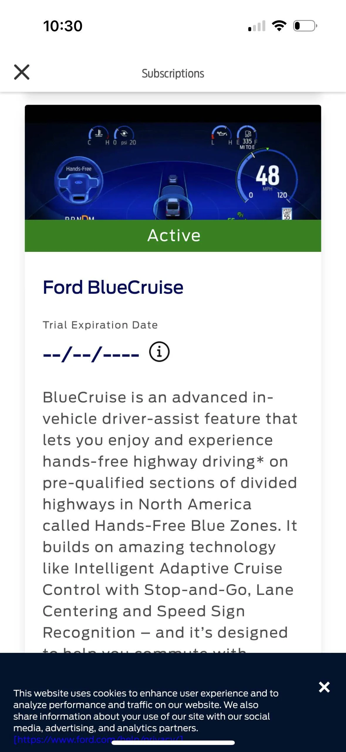

This thread made me check my app as it’s been a little over a month since I picked up my GTPE. bluecruise came with the vehicle so is this screen ok?
Expiration date will appear soon, if is active, just enjoy it, expiration day is 3 year from the moment you took ownership of the car.

Expiration date will appear soon, if is active, just enjoy it, expiration day is 2 year from the moment you took ownership of the car.
?. I thought it was just hardware and had no idea it was subscription based. I’m going to have to try it now ?‍?

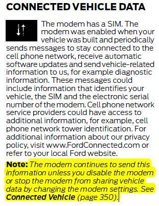

If you have not already, I would try cycling the Modem in the car to see if that gets the TCU to call home. FYI, you should see the Up/Down arrow in upper right corner of the Sync screen.
Ford Mustang Mach-E Problems With Brand New Mach-E 1670890009170
