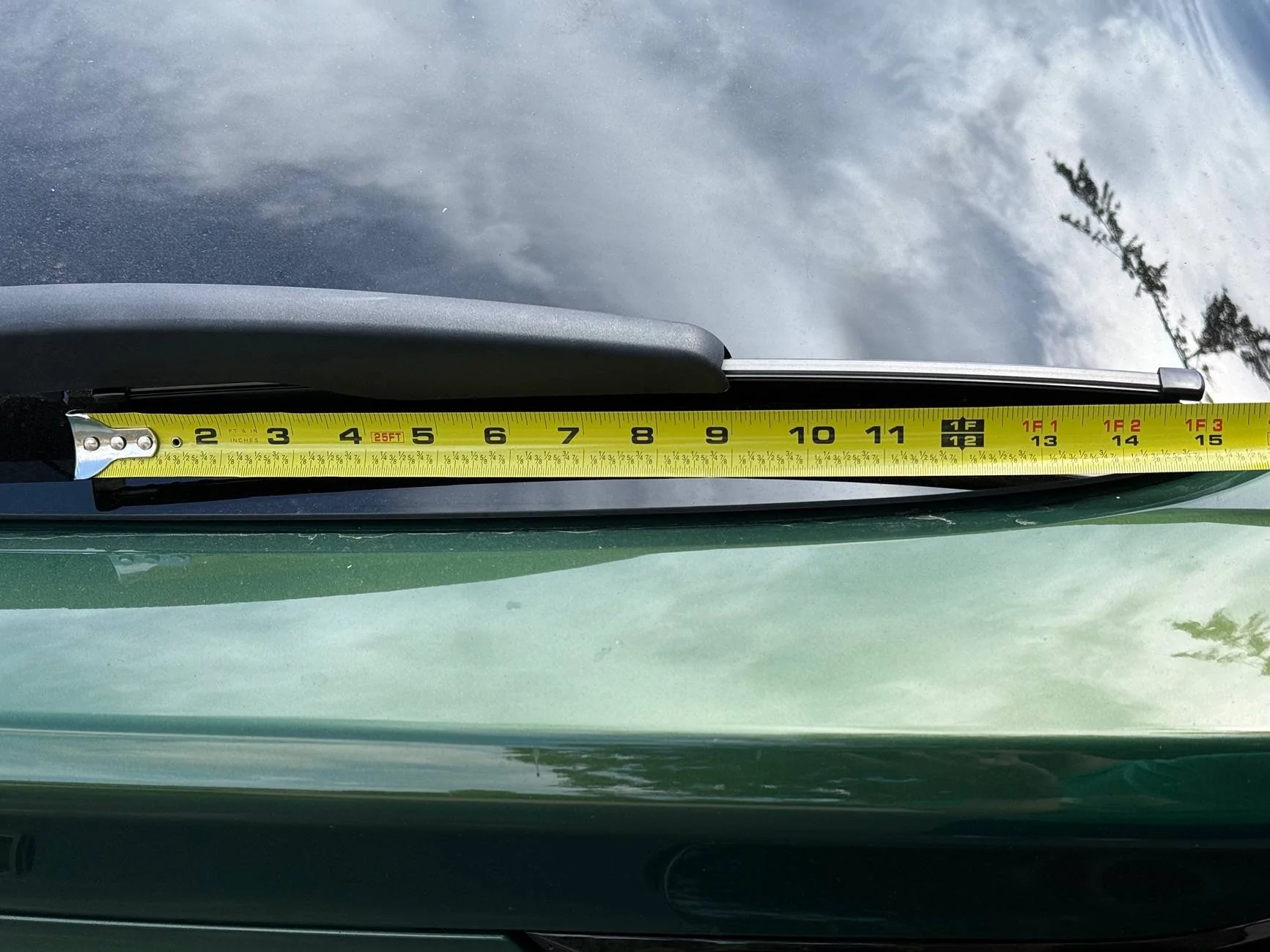

I was about to order a 15” rear wiper which is a popular upgrade. But looking at the rear of my car, the wiper suspiciously already looked like the longer ones people have installed. Took out a tape measure and it indeed measured 15”.
Looking at Ford parts, it does list a different part number (WW1510 or LJ8Z17528G) for cars made after 12/04/2024.
While y'all have solved it, I checked with the MME team. Yep, MY25 has a 15" rear wiper. It was an improvement they made, however as many have figured out in this thread, you can extend the wiper blade on previous models with a simple blade replacement.

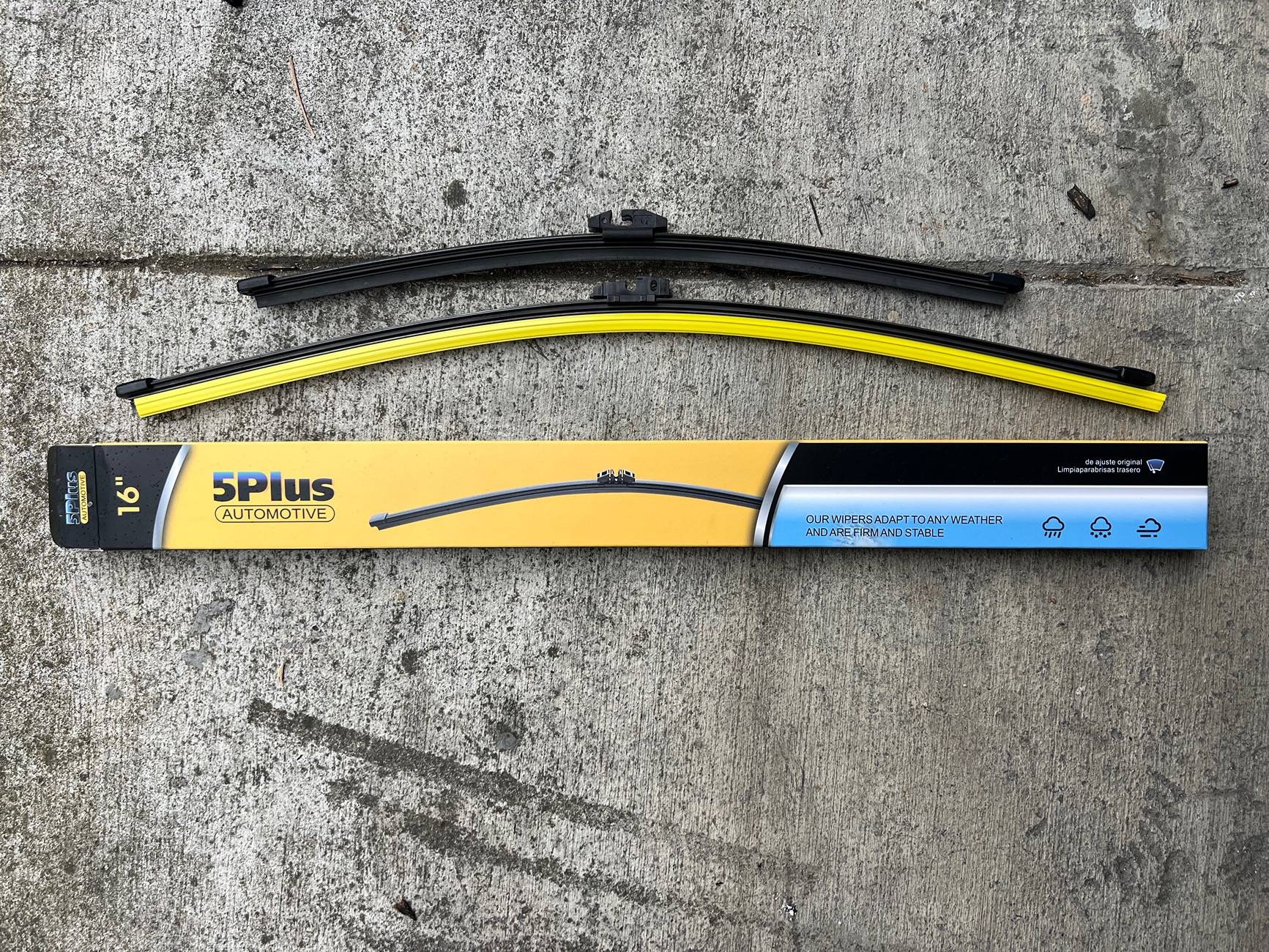

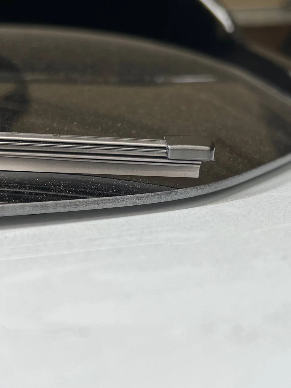

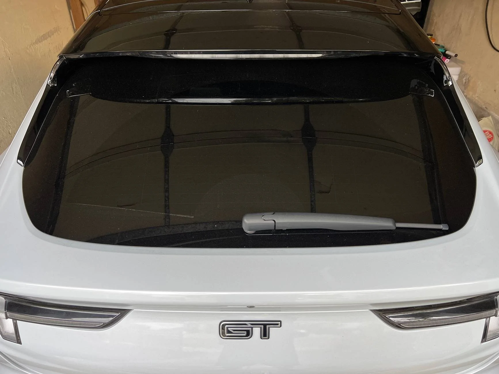

Just got done installing the new 16” wiper — the first Amazon link above. Visually, I don’t actually like how it looks and wish I would’ve gone with a 15”.
The last bit hovers instead of sitting flat on the window. Seems to have a far better arch when operated though so can’t complain about functionality. Curious to see if the wiper will cause noise when driving later.
Many before and after photos attached.
Side by side comparison. The 16" is noticeably longer than the OEM 12" one. Since the wiper is center mounted, this means you get 2" of additional cleaning at the top and the bottom.

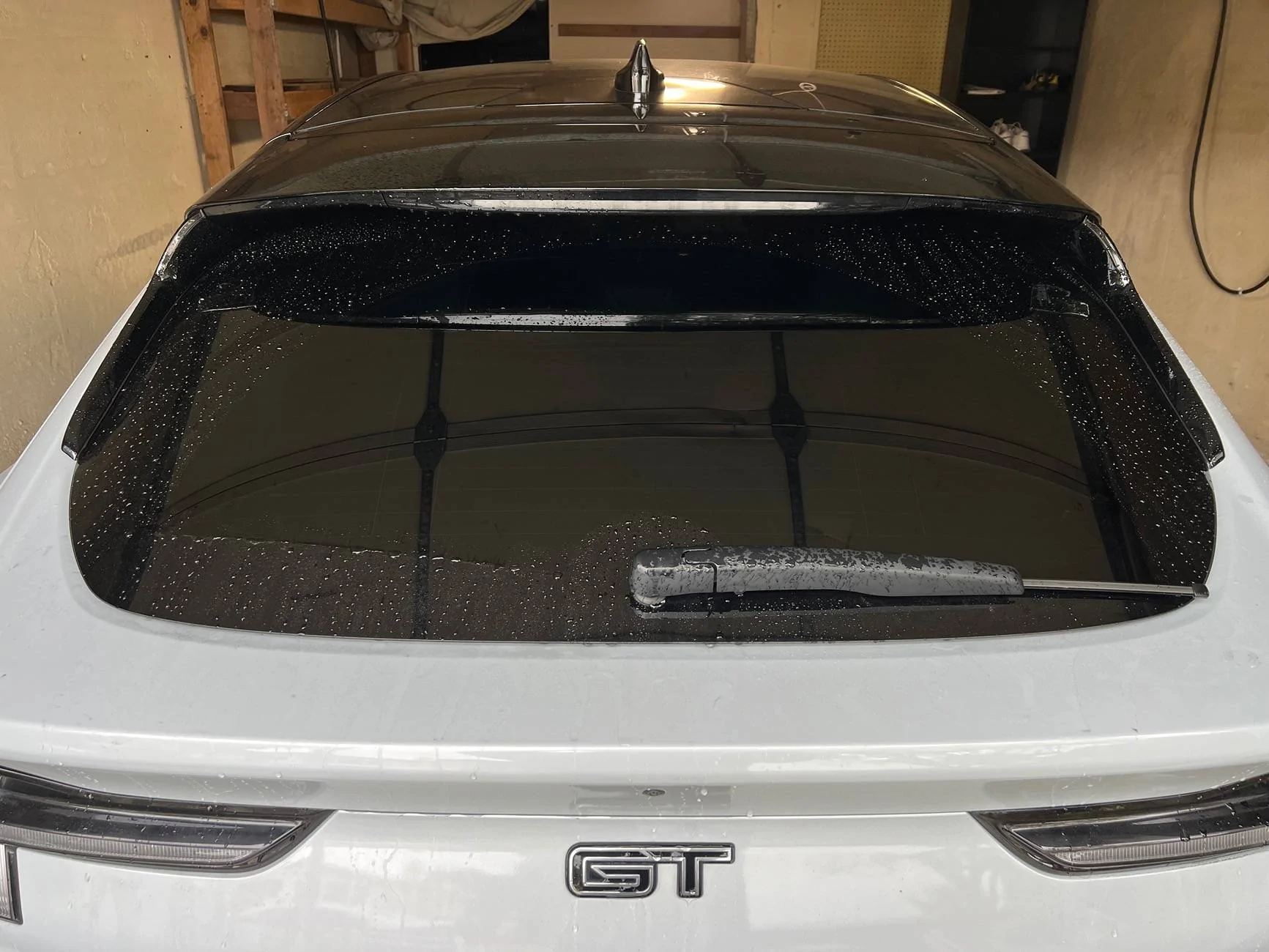

Factory rear wiper for reference
Ford Mustang Mach-E PSA: 2025 Mach-E comes with 15” rear window wiper from factory IMG_9856

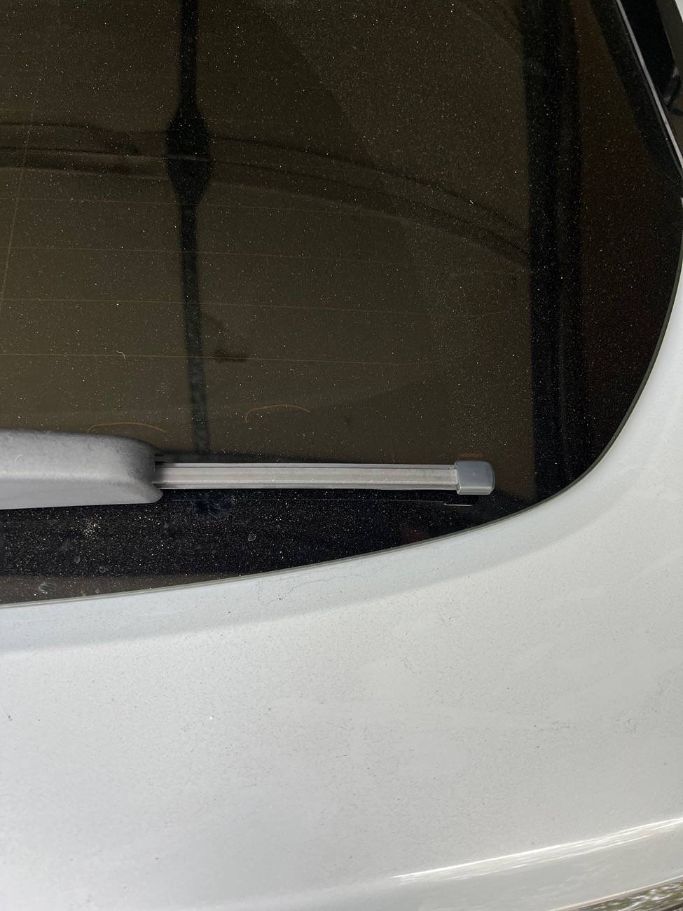

16" rear wiper installed. Visually, you can see how much more water gets cleared with the longer blade, both at the bottom of the arc and the top.

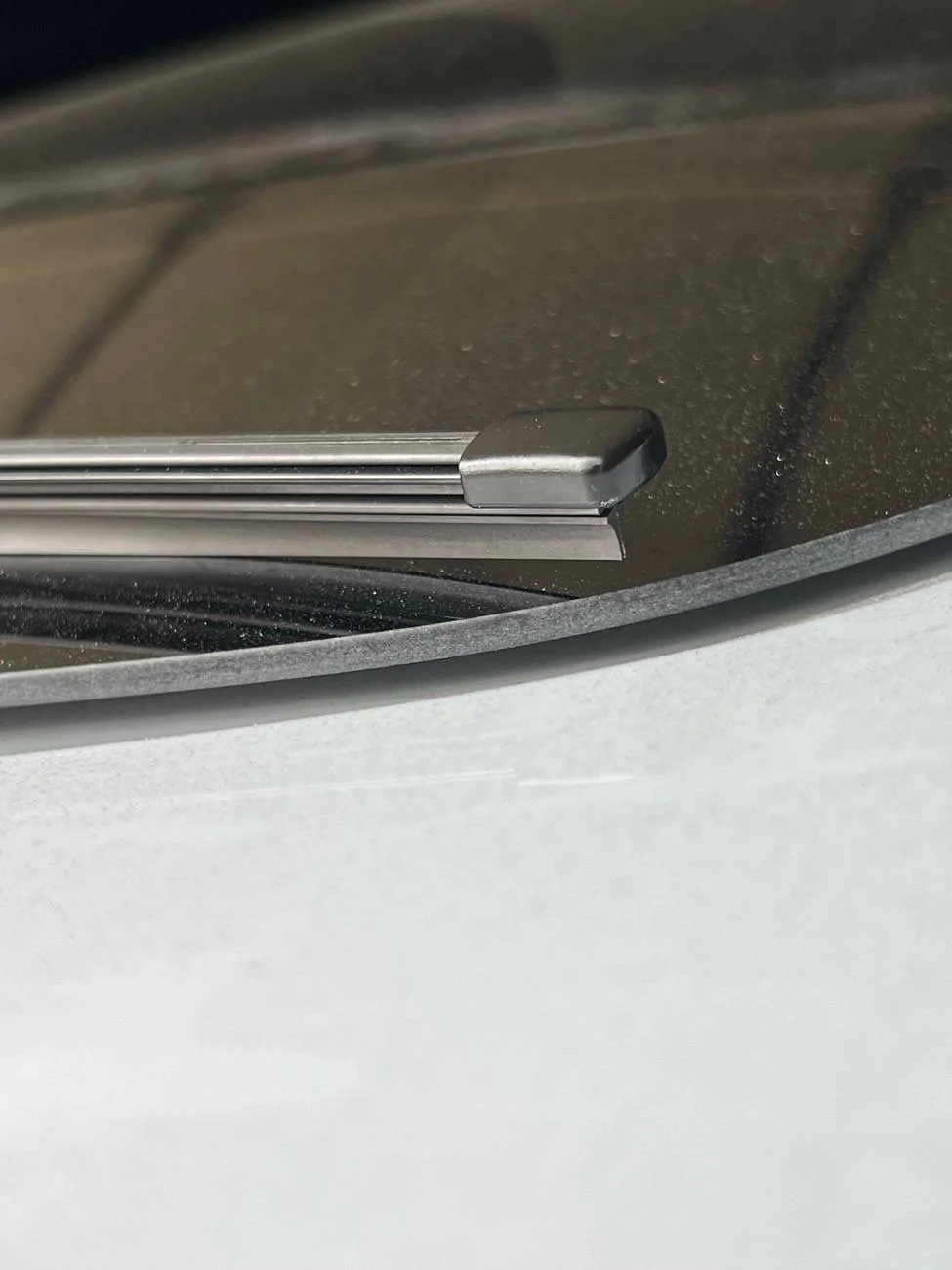

Last bit hovers a bit and doesn't sit flag on glass. When operated, I think the entire wiper makes contact with the glass?
Ford Mustang Mach-E PSA: 2025 Mach-E comes with 15” rear window wiper from factory IMG_9862
Another angle of the last part that hovers above the glass
Ford Mustang Mach-E PSA: 2025 Mach-E comes with 15” rear window wiper from factory IMG_9863
Ford Mustang Mach-E PSA: 2025 Mach-E comes with 15” rear window wiper from factory IMG_9858

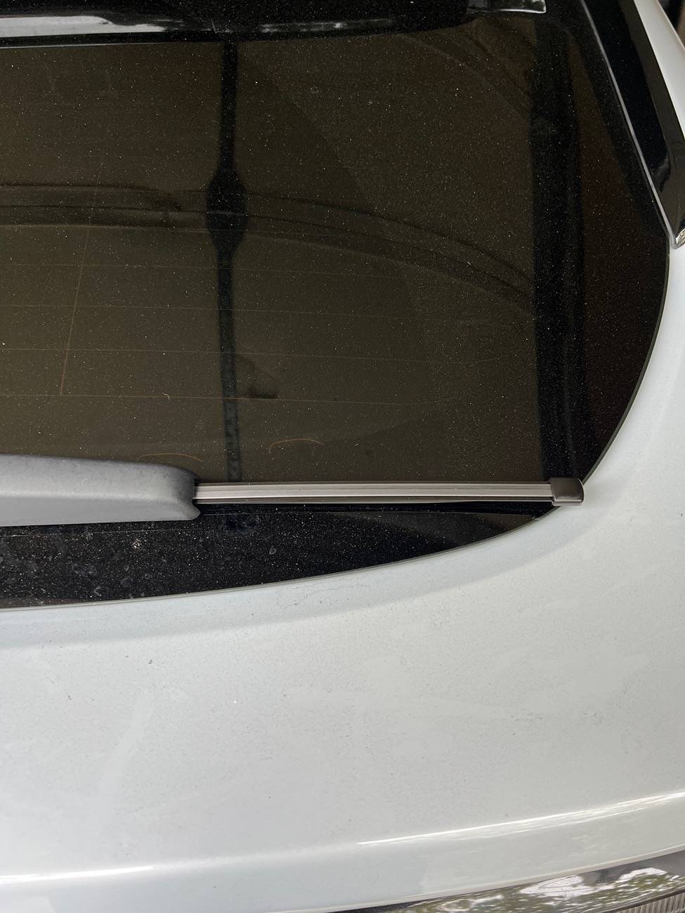

New 16" rear wiper. The top bit protrudes past the glass, but the bottom rubber is exactly at where the glass ends
That's the reason I went with a 15". I debated it in my head for a minute and ultimately chose style over function. Though i'm not sure how much function I lost chosing 15" over 16". But I know I like the look better.
