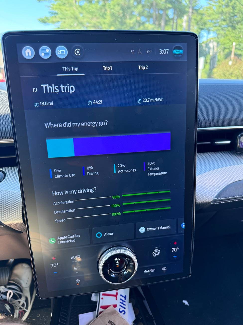

The uphill thing is real. I've had Ford Navigation say I could make it to my destination and the GOM say I can't. Makes me nervous even though it shouldn't.
My dad and i took mine up Mount Washington, we got all but 13 miles on the way back down.

What would be a nice update is a screen that lets you see what the values of the input data the car is using , so one could make any manual adjustments based upon your real plan.
They have this it's the "Trips" from the other apps screen it was the "Where is my energy going" but they changed it this tells you where all your energy is going for your trip. The C-Max has it set up where it shows you instead of giving you a little chart of where your energy is going.
