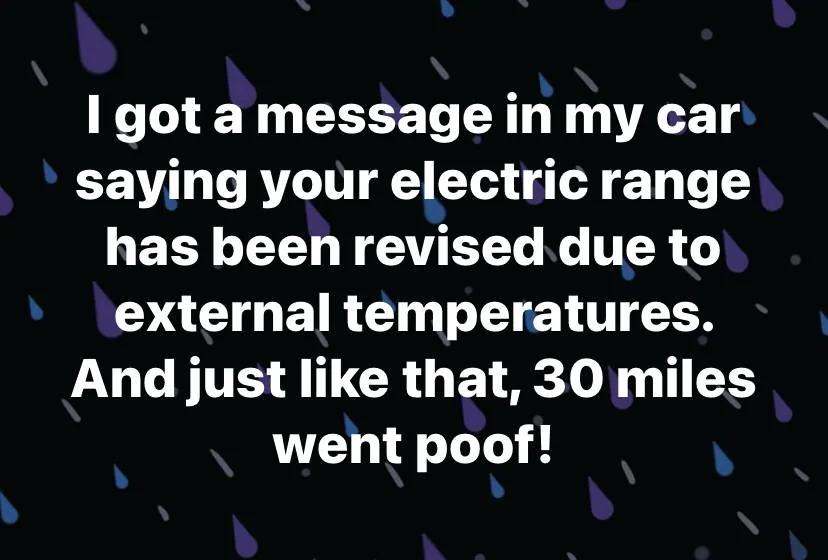

Just read another report on Reddit. Someone posted a pop-up message on the instrument cluster (that they also didn’t read), then a sudden downward recalculation of range. Wonder if Ford is updating the algorithm or perhaps there is some reset that is already built into the system.

And this on fb. I bet that’s what your’s said as well. Even if it wasn’t appreciably colder or it was a glitch that the recalc was done when it didn’t need to be.

Seems from what I’m seeing here and elsewhere, there was a momentary hiccup where the car recalculated range based on a colder outside temp, whether that was real or imagined on it’s part. And now it is recalibrating as you go.
