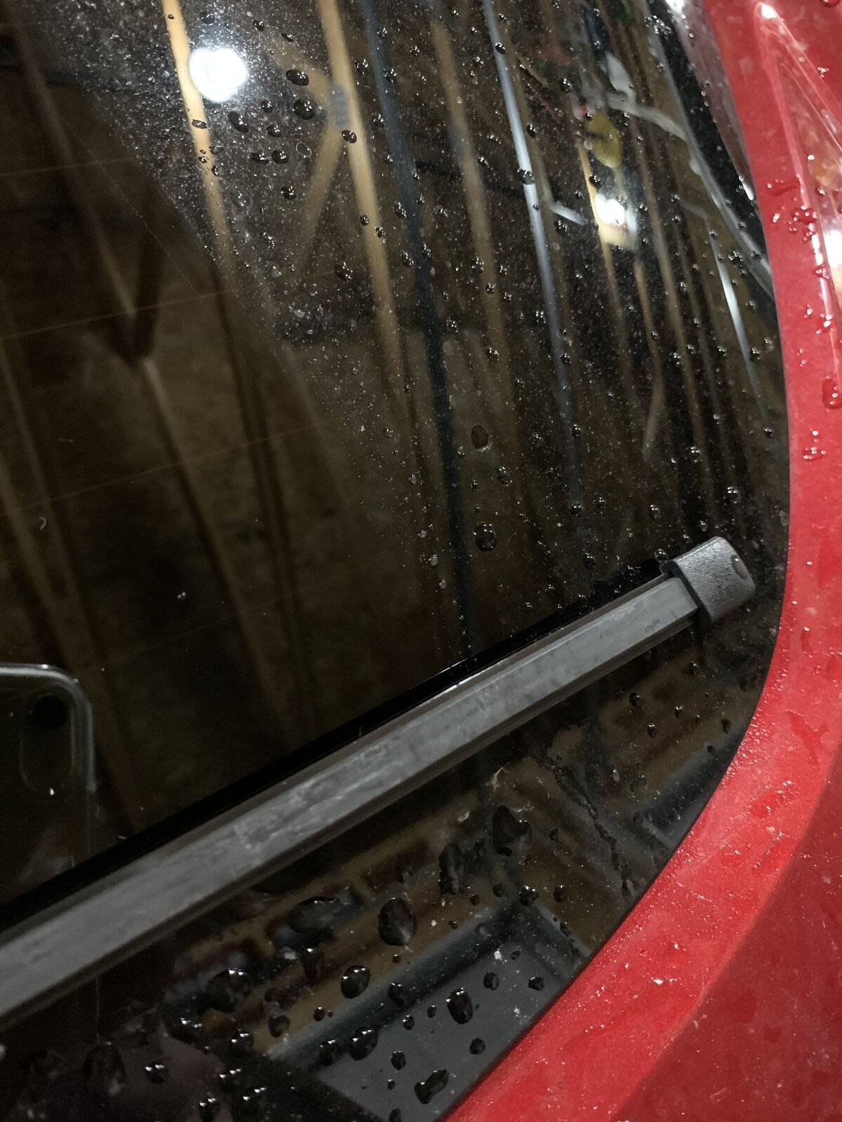

It’s not OEM but the trico blade comes with this adapter:
Ford Mustang Mach-E Rear wiper blade - longer replacement? 56680603-9CD1-456C-B72E-F0A4D724A78A
which you can slide the cover off to reveal it looking like this:
Ford Mustang Mach-E Rear wiper blade - longer replacement? 06C0EFE8-D7F6-4948-B5E4-AD28D41E9638
It then snaps easily but securely to the cross pin on the underside of the wiper arm.
this photos shows the extra coverage. Could still be more but this was the longest rear wiper blade Advance Auto had.
Ford Mustang Mach-E Rear wiper blade - longer replacement? 79666118-4159-43D6-912E-2EE696ACDC2C

I would like a longer blade too, to clear more of the top part of the window, as the OP notes.
What size is that one? Mine is 15" but is not as long to the outer edge as what you show in the picture. Maybe because I now have an explorer arm, I think it may sit lower to begin with. The dealer broke the ME one.

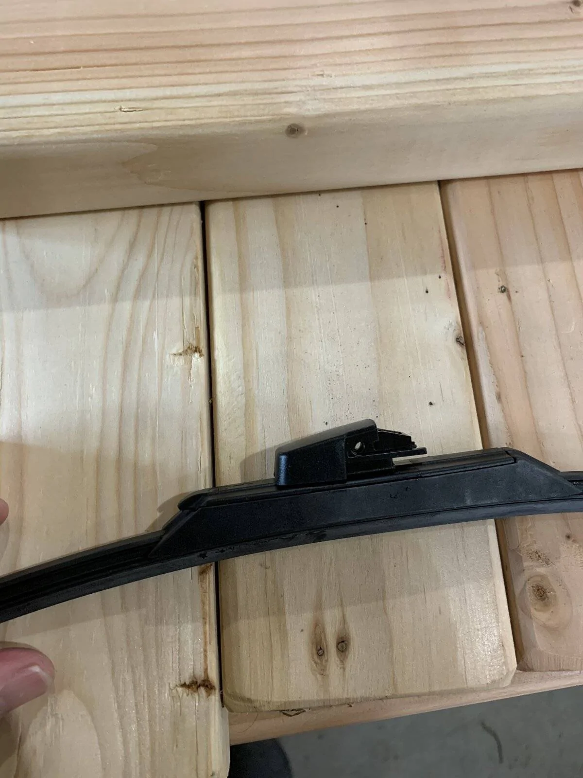

I think this seems to be the method:
louibluey
Joe
60
888
1,127
FE "Louibluey" GB

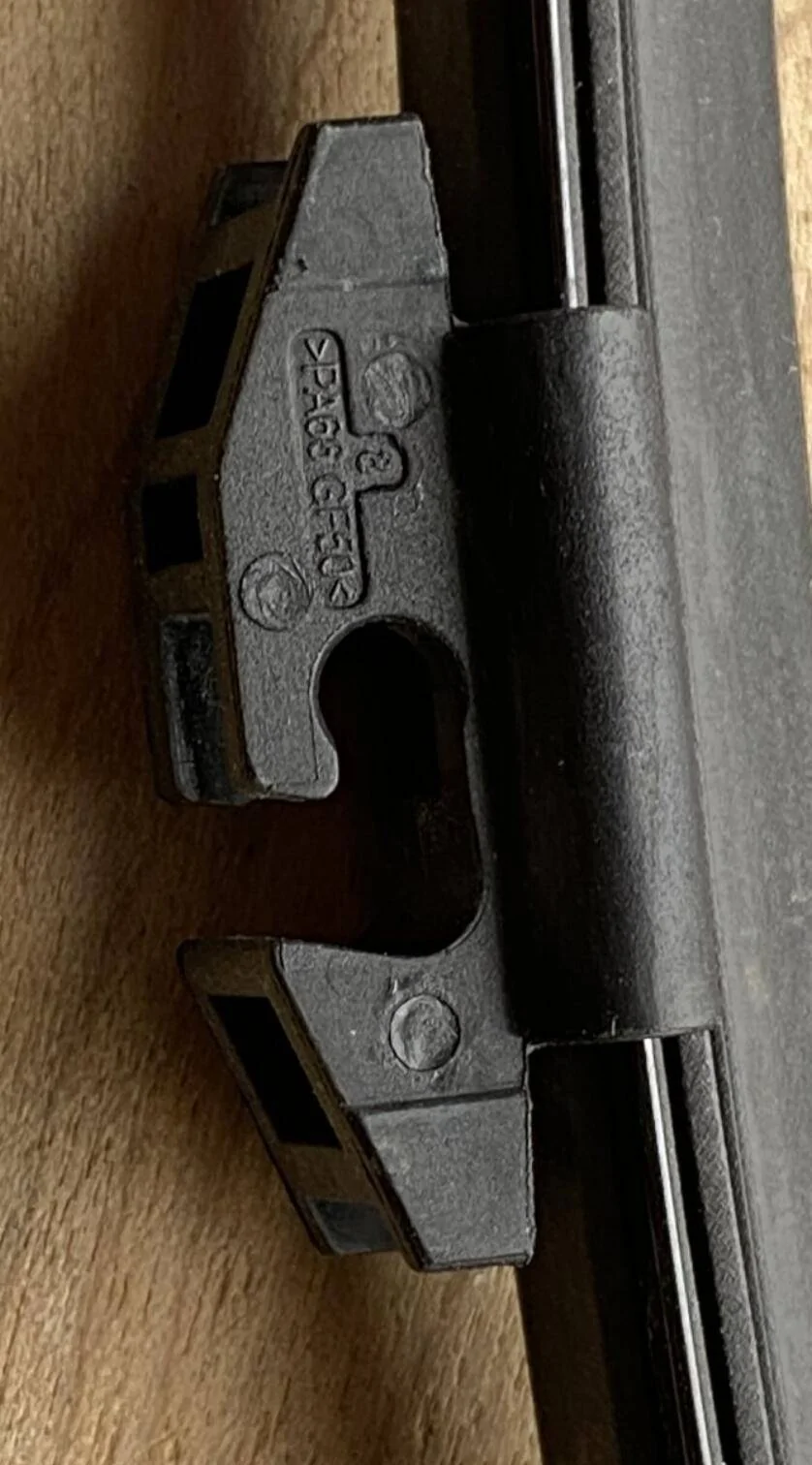

NO, that is how to break it. The old Explorer rear wiper blade just pulls off.
The MME original rear wiper has a horizontal slot AND a vertical slot, you first slide it outward in the direct of the wiper arm then pull it off.
The picture is not rotating, standby, I will go make a video.

lift the arm a bit and pull the blade toward the right side of the vehicle until there is a snap. Then pull it toward the window until it clicks again. It takes some slow but strong force.

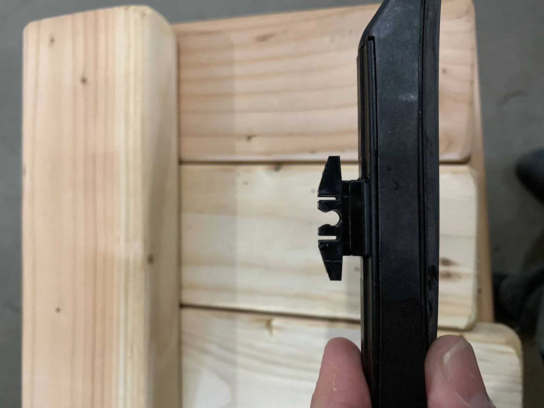

Step 1 - This is what seems to be different for MME (and as per @woody next post, 2018 and later Explorer).

Thanks.
It appears that the aforementioned dealer was was clueless.
Starting with model year 2018, Ford changed the design of the wiper blade clip.
Should you try to remove the blade the old way you will break one or more parts (eg. the arm, etc.).
This link is a good video demonstration of the previous post by louibluey.
The Trico replacement blade has the older (Ford) clip.
