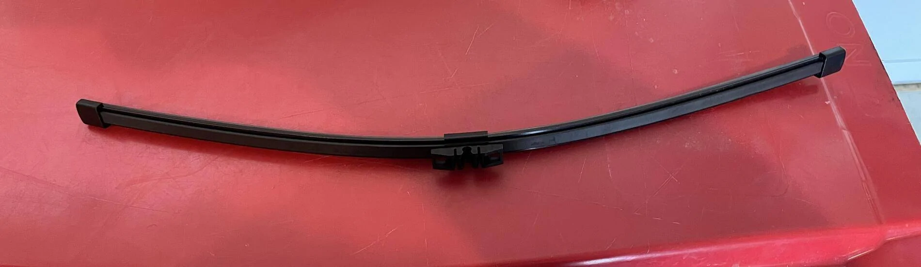

So I bought this exact blade. Easy install. Drove in the rain today and the top 3 inches of the area being wiped by the blade was not being cleaned. Appears the blade is not being pressed down hard enough against the rear windshield to be effective. Have you noticed this??? Very noticeable from inside the car.
I did some more testing while driving around so I could use a lot more washer fluid. You're right that there's a section of the arc that doesn't seem to be completely wiped by the blade. For me, it's about 3/4 of the way up above the arm pivot point. It wipes fine above and below this point, but there was still fluid left in this section.
So I tried another 15" blade to see if it was any better. This one is actually much closer in design to the original blade, just longer. I did the same tests and don't see any missed spots anymore. This one appears to be the way to go.

Just a quick update. We finally got rain today, so I was able to really test the Trico 15-G blade. I can confirm that it clears the full arc of travel with no missed spots. It's orders of magnitude better than the little OEM blade, but I kinda want to see if an even longer one is available that will work. Maybe 16"? I'll check around.
