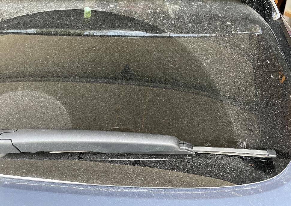

Just stopped at advance auto. The 15” trico rear wiper, item number 55150, comes with an adapter that can fit.
Thanks for this suggestion. I just installed the same wiper blade, and the coverage looks like it will be a lot better. My back windshield is pretty dirty, so don't want to try a test wipe until I'm driving and can spray some washer fluid.
Here's the original blade with the new blade behind it:
And the new blade installed. You can see how much further the blade extends in both directions past the dirty arc of the old blade.

Here's a shot of the arc with the new blade. It's a drastic difference.
You're a lifesaver, @generaltso! Until I saw this thread, I thought I was the only one that thought the sweep on that wiper was ridiculous. I got the last Trico blade from Advance Auto near me and it was an easy change.
So I bought this exact blade. Easy install. Drove in the rain today and the top 3 inches of the area being wiped by the blade was not being cleaned. Appears the blade is not being pressed down hard enough against the rear windshield to be effective. Have you noticed this??? Very noticeable from inside the car.
