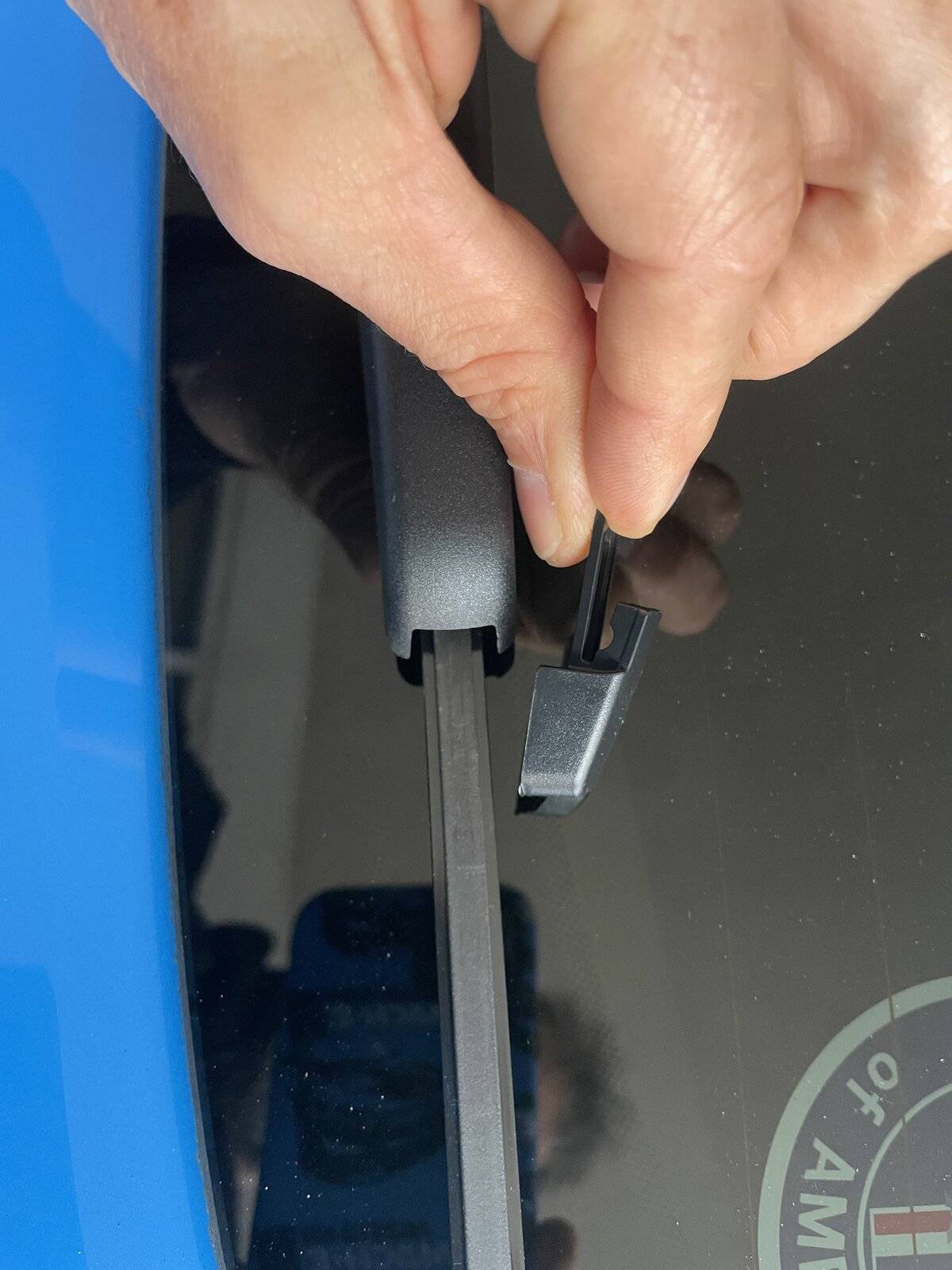

Following the videos on here made removal of the old wiper simple. The Trico 15G snaps right in but only a single snap. It comes with an adapter to make it double snap but I don’t see any way to fit the adapter into the Mach E arm. Has anyone figured out how to use the adapter?
