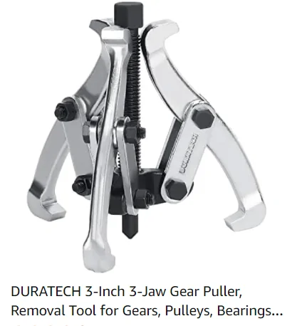

Now that I have broken the arm and need to replace it, what is needed after taking the nut off under the cover? Does the arm just pull off the shaft once the nut is removed? Do I need to pry it off with one of those plastic pry bars?
Please don’t use a pry bar. Use a puller.

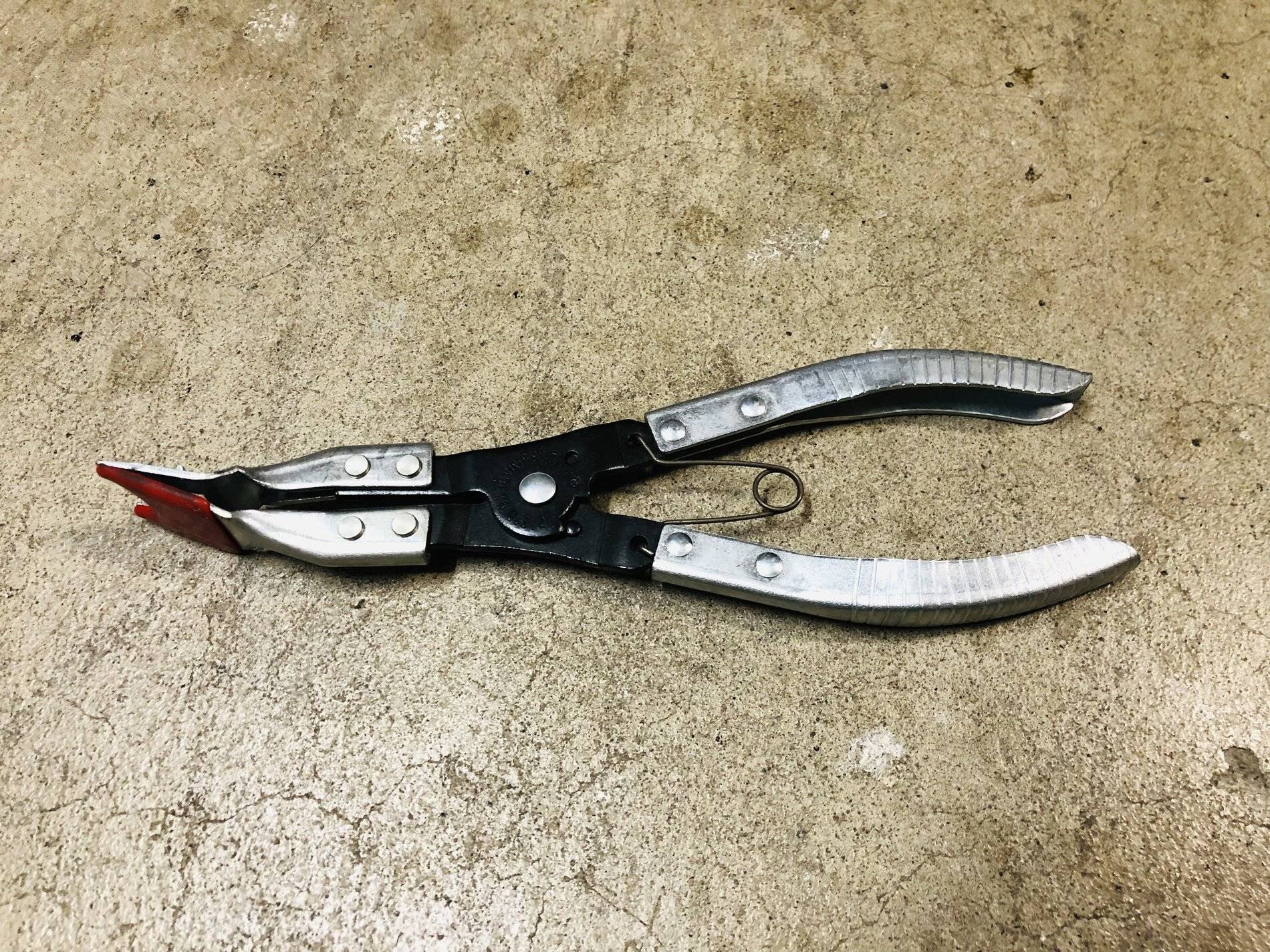

Here’s a pic of the wiper arm puller I use most often.
Ford Mustang Mach-E Rear wiper blade - longer replacement? AD5D3981-3561-4E75-9A91-2ED665FCD888
