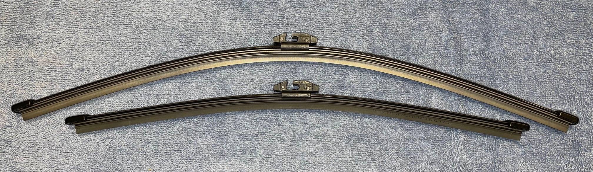

Just want to add Motorcraft also makes a longer rear wiper that is identical to the stock blade except longer. It is from the Ford Edge, and you can get one from you Ford dealer (see table for part number). The mounting is identical, right down to the mold marks. It is very similar to the Trico 15-G but the mounting is the OEM type.
Part No.Length
Mach-E bladeLJ8Z-17528-CA11.75"
14" Edge bladeFT4Z-17528-D14.0"
15" Edge bladeFT4Z-17528-DA15.0"

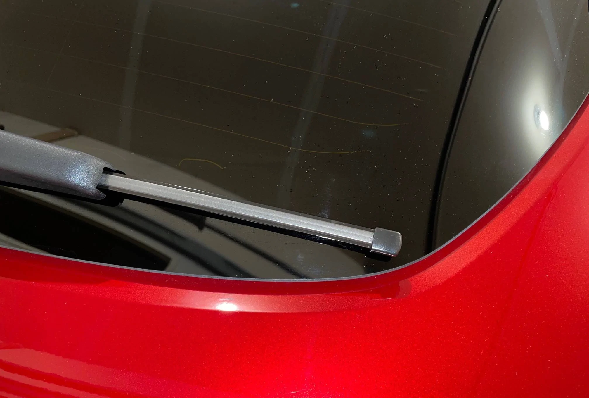

As you can see the 15" Edge blade is 1 5/8" longer on each side and the mounting is identical:
Ford Mustang Mach-E Rear wiper blade - longer replacement? IMG_1046
Ford Mustang Mach-E Rear wiper blade - longer replacement? IMG_1047
Ford Mustang Mach-E Rear wiper blade - longer replacement? IMG_1048
The last 1/2" of the blade isn't touching the glass in the parked position due to the glass curvature. Personally I think a 14" blade would just about be perfect, perhaps there's another Ford SUV with an intermediate length. EDIT: Turns out there is a 14" Motorcraft blade, part # added above.

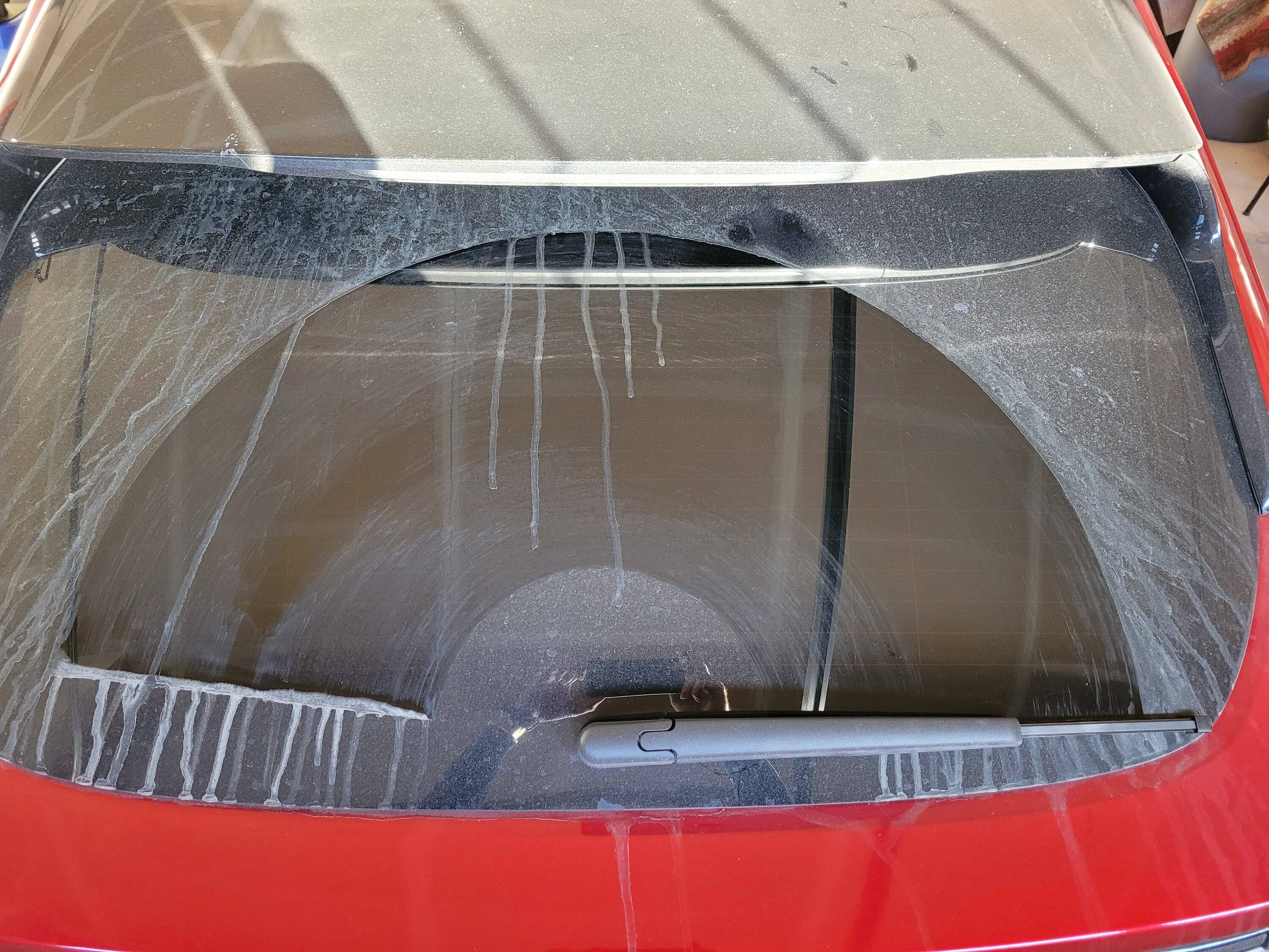

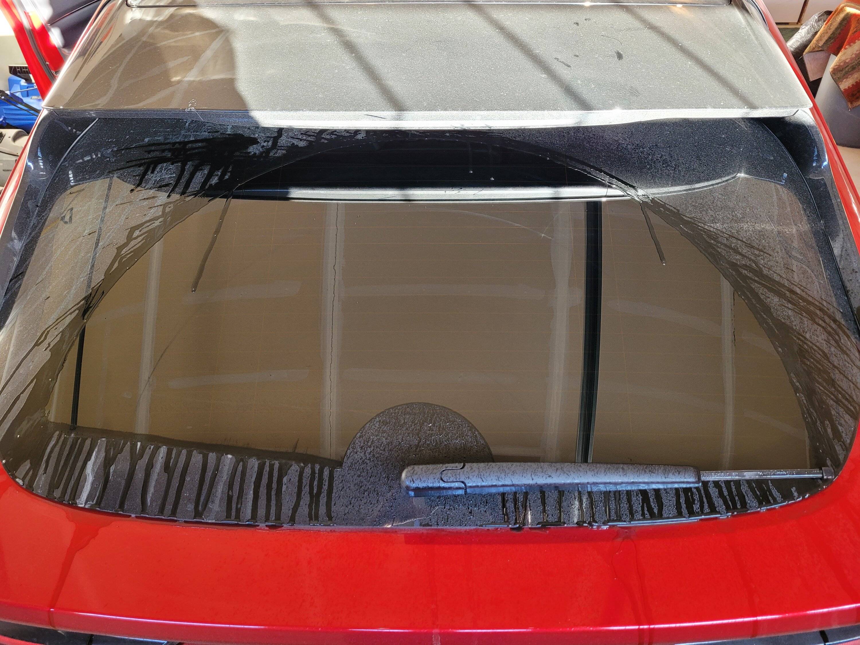

I swapped mine out for the Trico 15-G in January. It definitely helps, but still only borderline for being able to see below the sweep line when looking out the rear view mirror.
My window was nice and dirty when I changed the wiper, so here's a comparison of the new vs original blade.
**edit** That's actually the new blade in both pictures (in case you're wondering why it sticks out past the dirt in the lower pic). I just hadn't done a wipe yet when I had the idea to take before and after pics.
