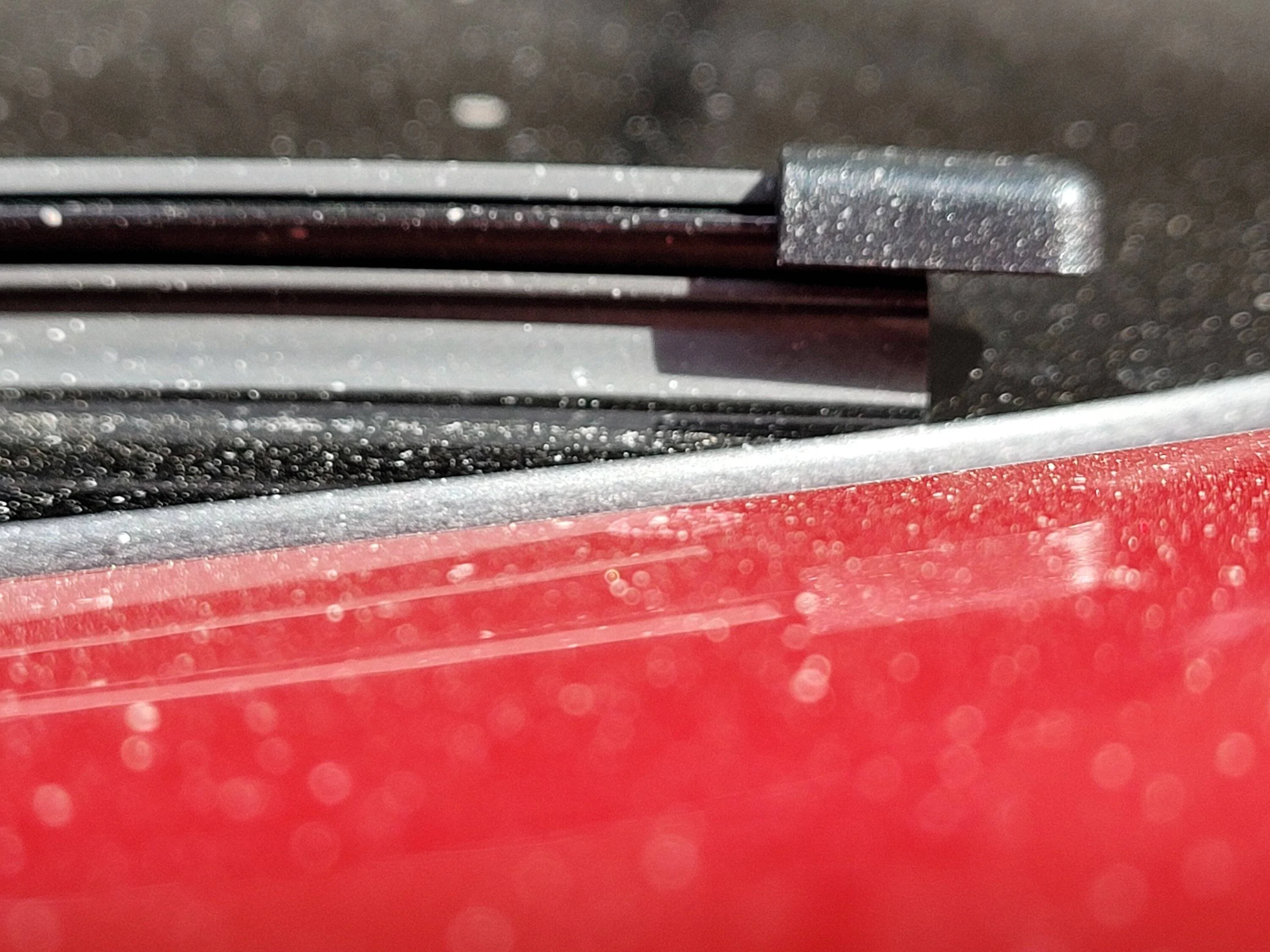

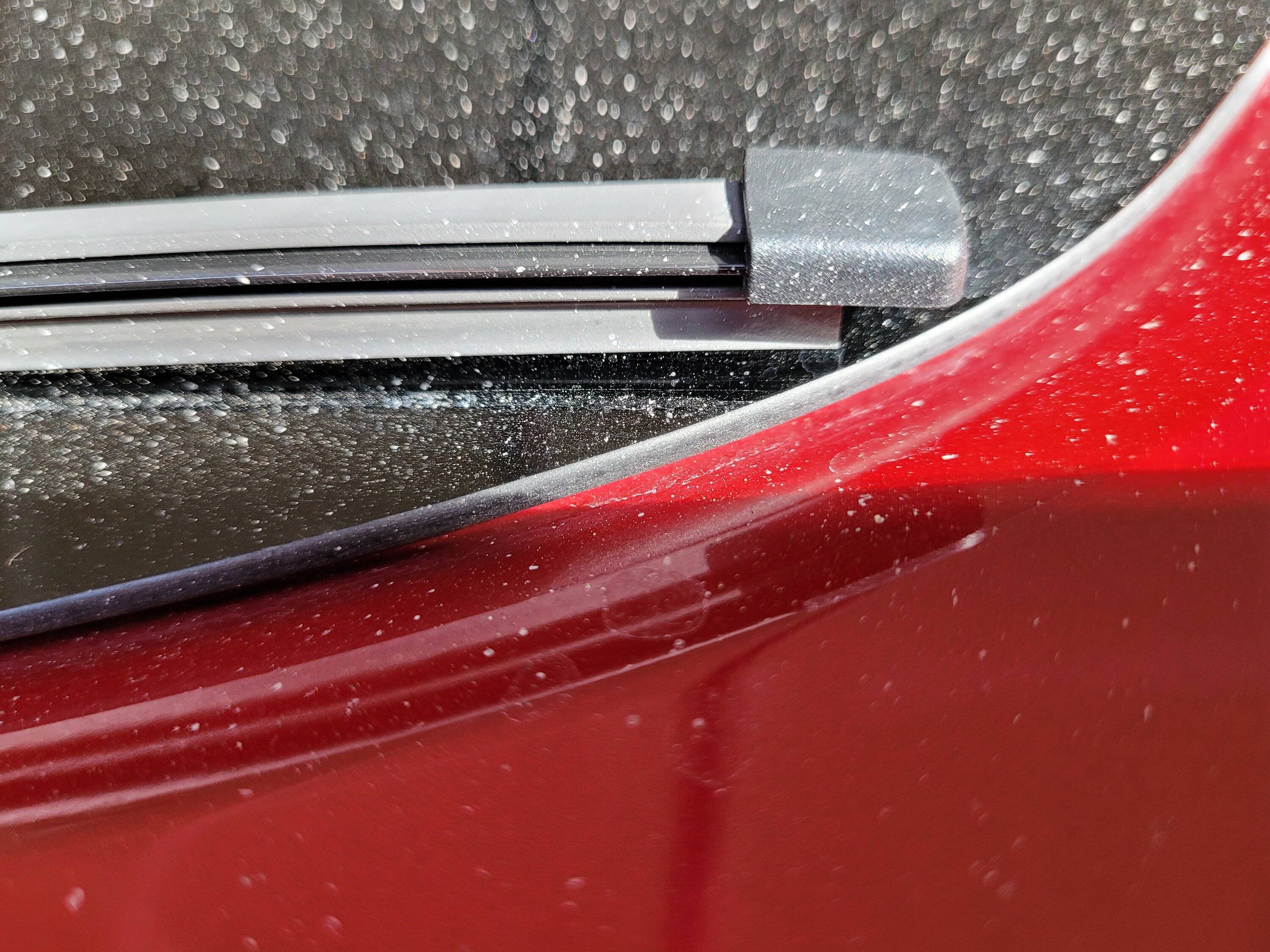

I must be misunderstanding what you're saying then. To clear more of the window at the top of the sweep, the blade is going to stick out longer on the side when it's horizontal too.
I just went out and looked at mine again, and the Trico 15-G blade actually maintains contact with the glass the entire way. It's the arm that sticks out a little past, but that doesn't really matter. The blade is pretty much the max that can go on there without running over the edge of the glass.
