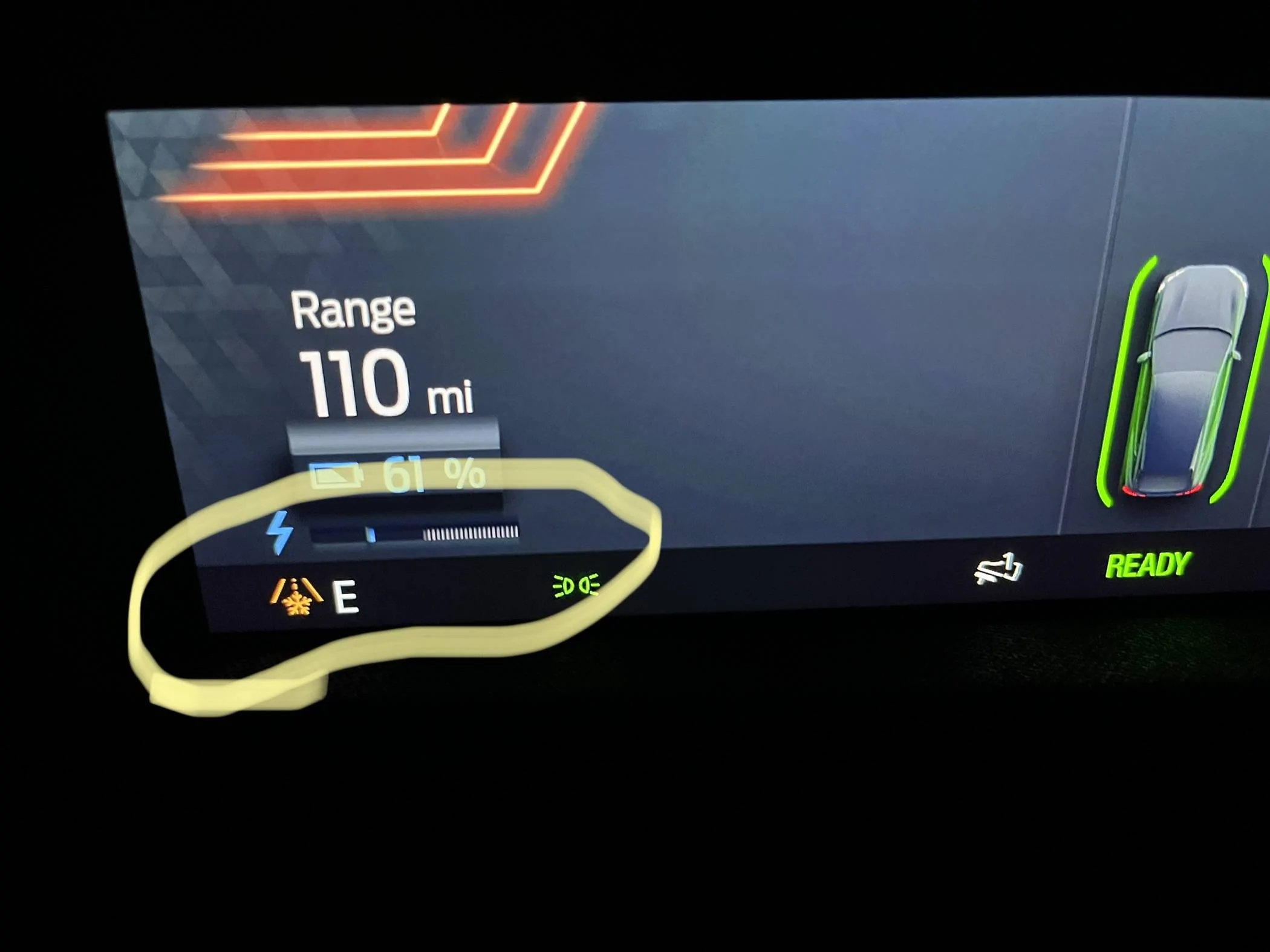

I
Because the other models don't get that boost to begin with. It's not like they are reducing the GT/PE's power to BELOW other models...they just have less boost than they normally get.
It definitely IS power reduced below other models. Heck, sometimes mine is reduced below my daughters scooter. No errors. Service manager at dealer can’t give me answers.

I
It's cold and you're driving fast. And that power is likely exactly the sort of power the others models will be providing as well they just don't show you the reduction bar.

I
Was the vehicle fully warmed up? External temp? How fast were you going? I don't think I have ever seen that many bars on mine, or if so, for only very brief times. Usually worst I see is about 2/3 that many bars. That typically happens on cold start, where I didn't precondition/start or charge beforehand.
MMEUser7
Jan 6, 2022
Pittsburgh
2021 MME GTP Dark Matter
This was about 30 miles into my daily 44 mile trip home from work. When started, after sitting outside work in 30deg, there were maybe 3-4 bars. Then they will come and go as I drive but after I came to stop light and made a right turn, then all of a sudden this. No jamming on the pedal or trying to out run someone.

IT
Bizarre. I have never seen anything like that. I wouldn't worry about it unless you start seeing it regularly.
