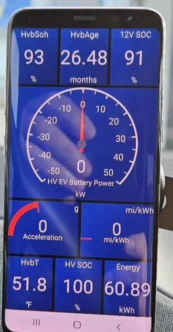

The easiest way to see the regen (and much more!) is to get an ODBII reader and install the CarScanner app
Ford Mustang Mach-E Regen not working? ODBII

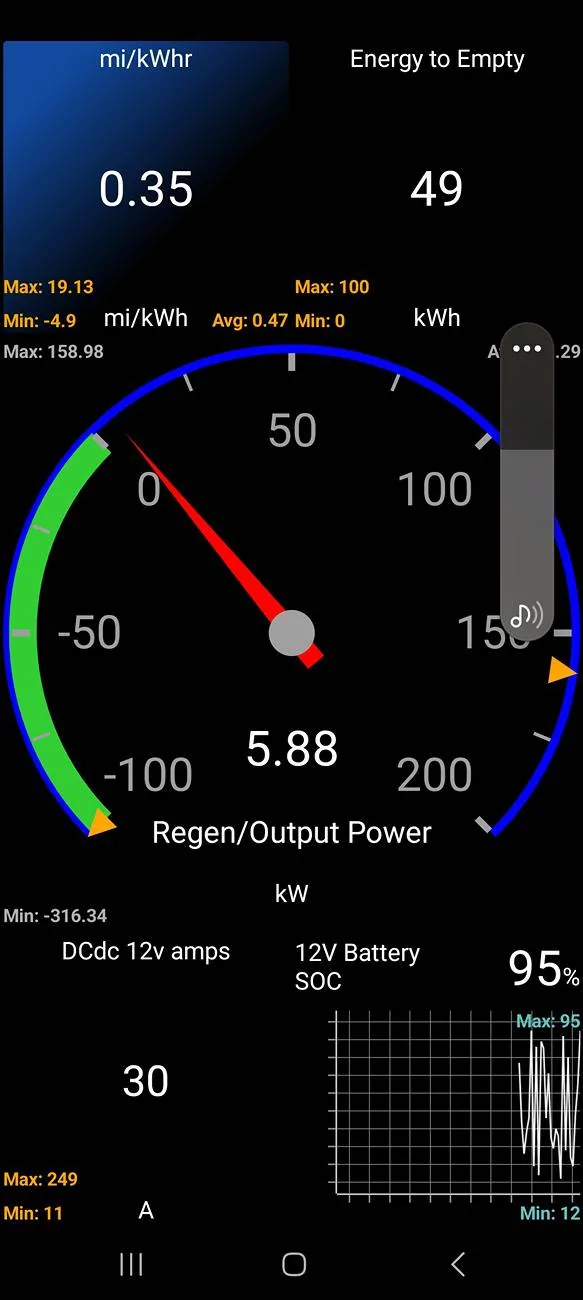

Is there are regen display mode that can be configured that actually displays regen graphically? I have not seen/found it if there is a method.
unfortunately not with factory display....
you can however get a $25 ODB2 reader, and free phone app 'CarScanner', and configure your own display to show all kinds of information not shown on the factory displays.
I find the power output/regen, shown in kW, to be informative ... and I really like to be able to see actual kWhr remaining in the battery when on a trip so I can get a much better idea of remaining range as conditions change on a one-way travel day.
