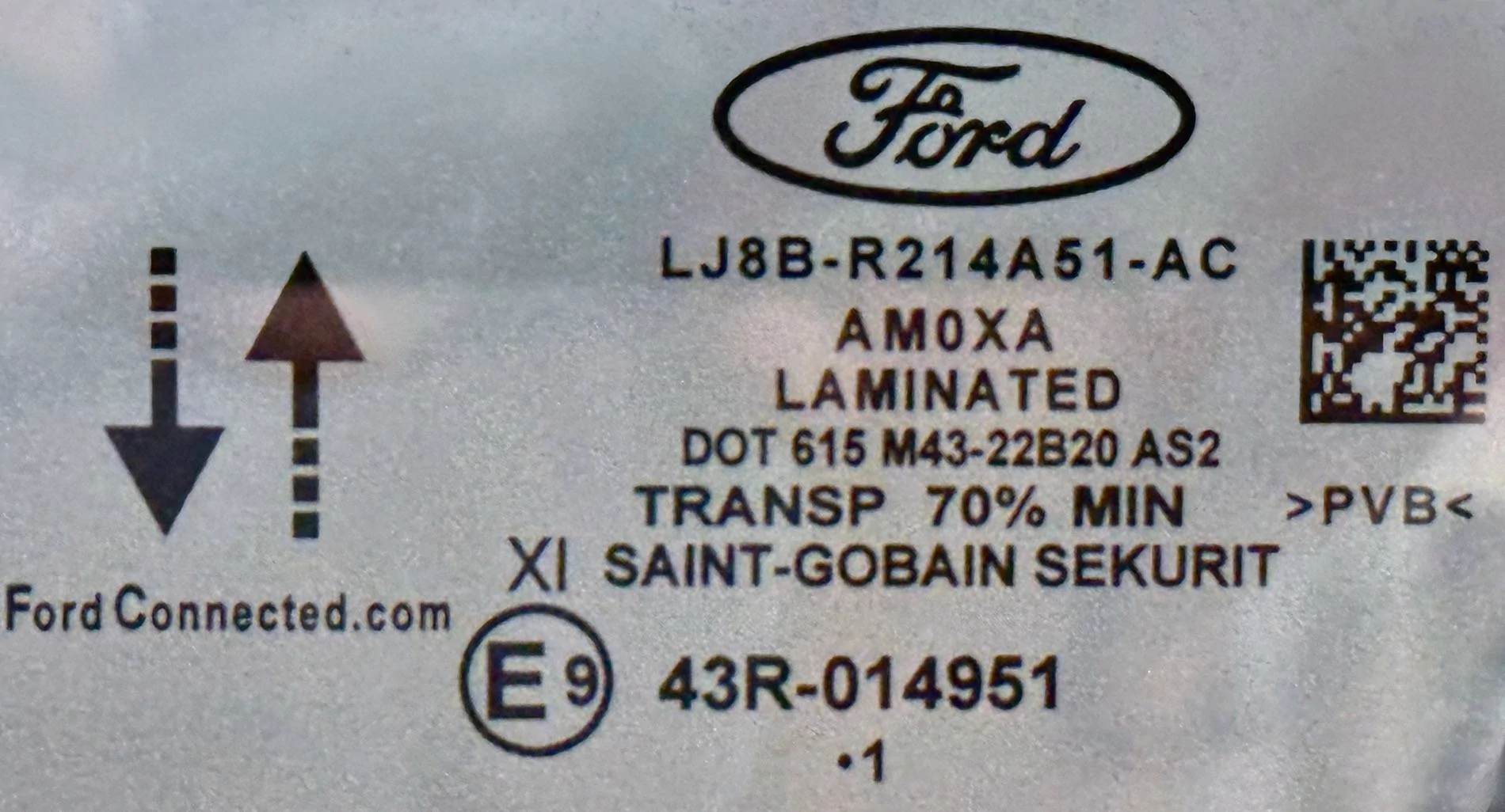

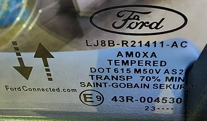

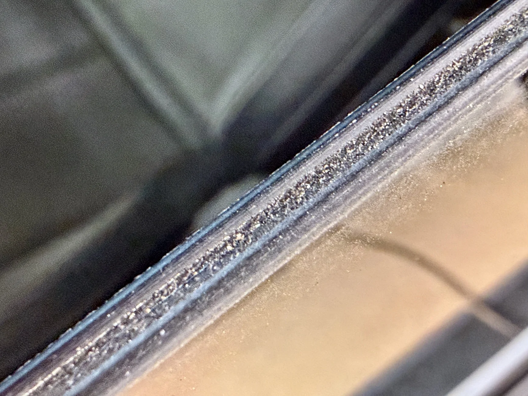

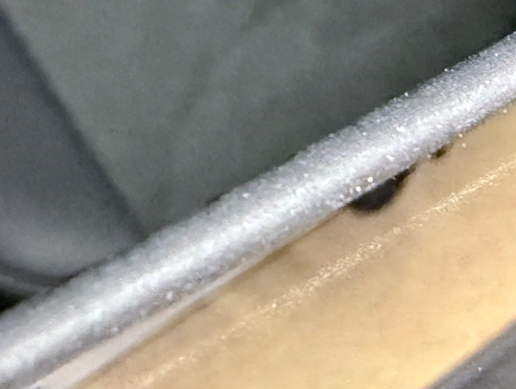

I have a '25 GT, less than a month old. How can I tell if it has the laminated front side windows? Can you tell just by looking at it? I am a bit surprised by the amount of road noise I'm hearing since reducing noise was one of my objectives coming from a 2018 Tesla Model 3.
Look at the lower right corner of the driver's door window. If it is marked Laminated, it is acoustic glass (two pieces of glass with plastic sandwiched between them). Tempered is not acoustic.
You can also very easily tell by just looking at the top edge of the glass. The Laminated clearly shows two pieces of glass with a center plastic piece while the tempered is just a rounded edge.
Rats. Mine is tempered.
