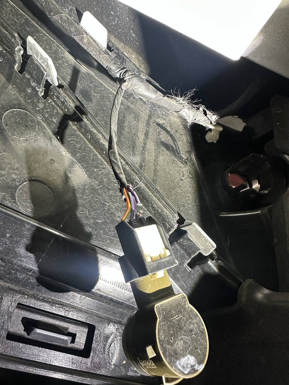

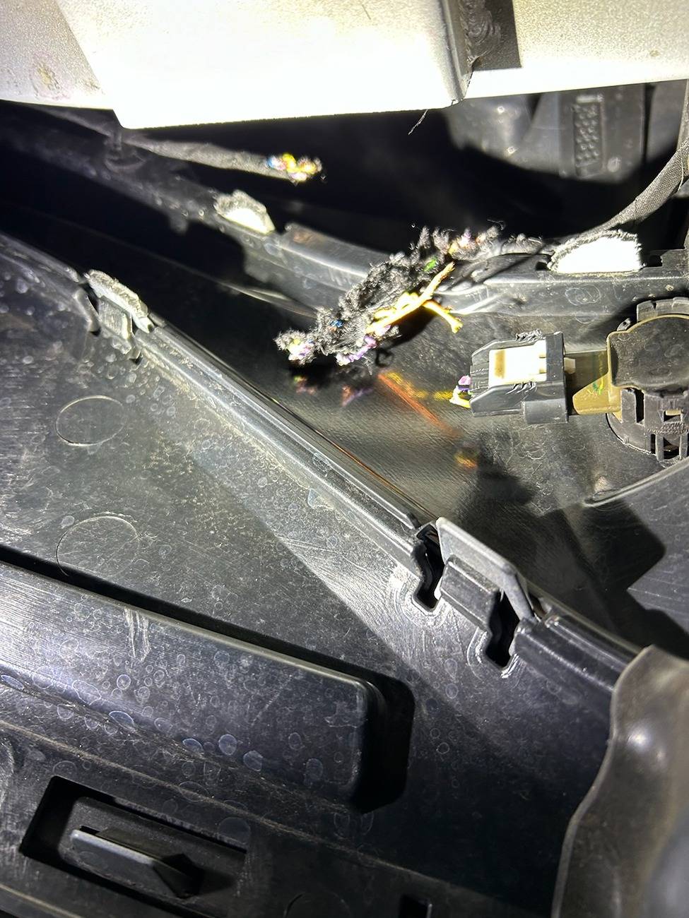

Twice in the last two months, I have taken my 2023 Mach-E to the dealer because of a backup sensor fault. Both times the dealership technician reported that the wires for the backup sensors had been chewed up by a rodent. They even sent me pictures of the damage. Both times it cost $500+ to get it repaired. The second time I boughr rodent tape from Honda and had the wires wrapped with it. Has anyone else experienced this and found a good solution?

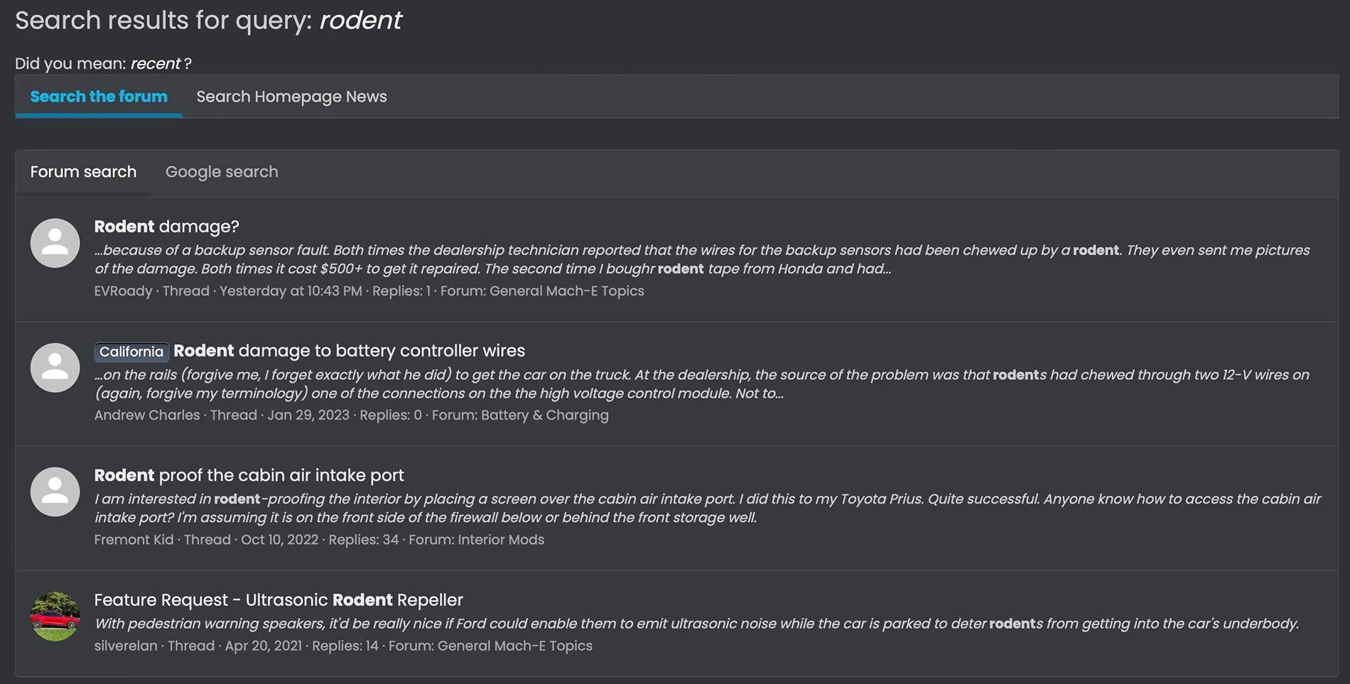

@mattsaradan, there are a couple of threads on rodent damage in the car including one about how to make the access points relatively inaccessible for mice and rats. In the meantime, I use Granpa Gus’ pouches in the frunk and change them regularly. Some folks dangle one in a string from the beauty panels so they’re below the frunk as well.
Good luck.
