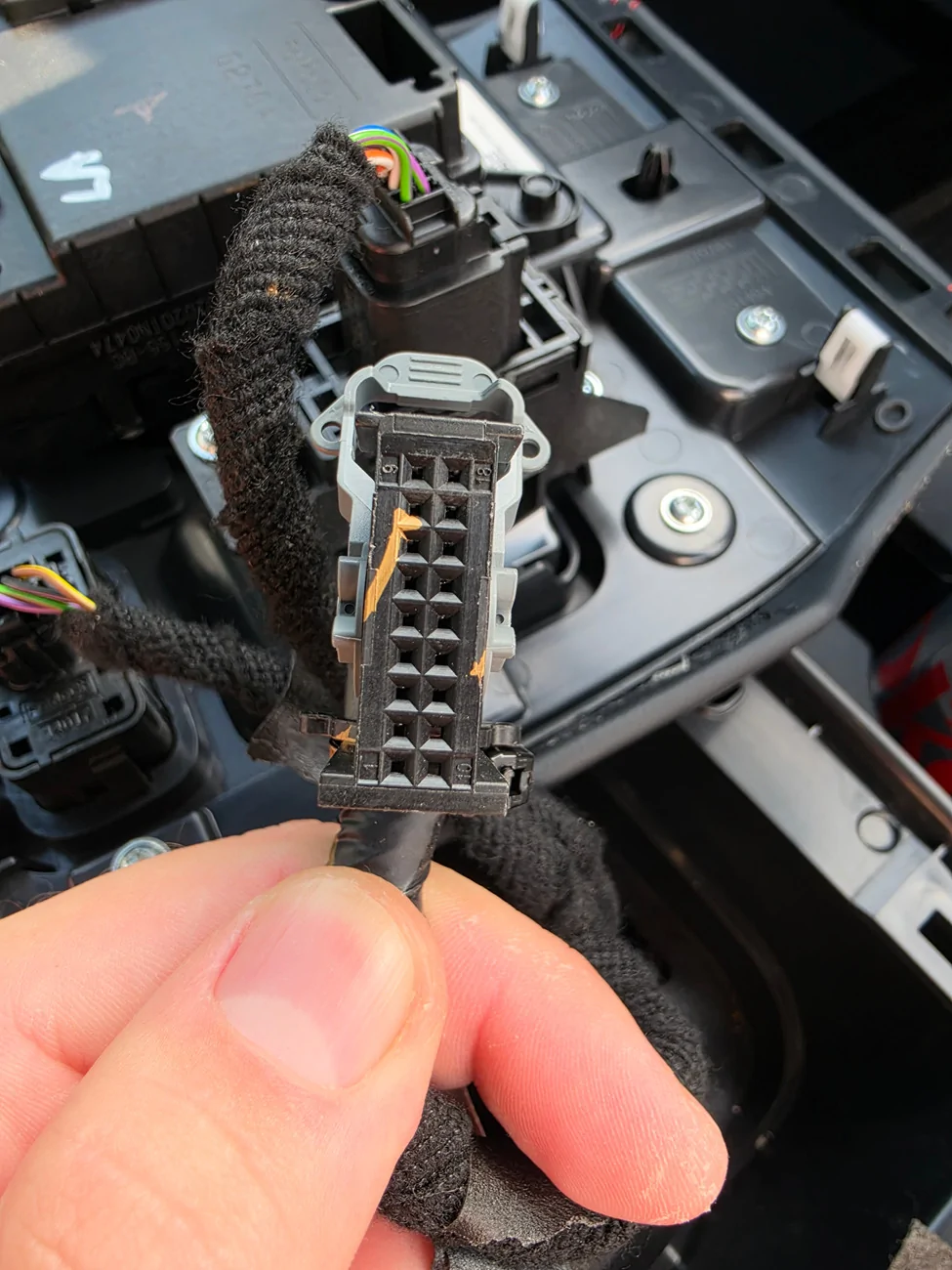

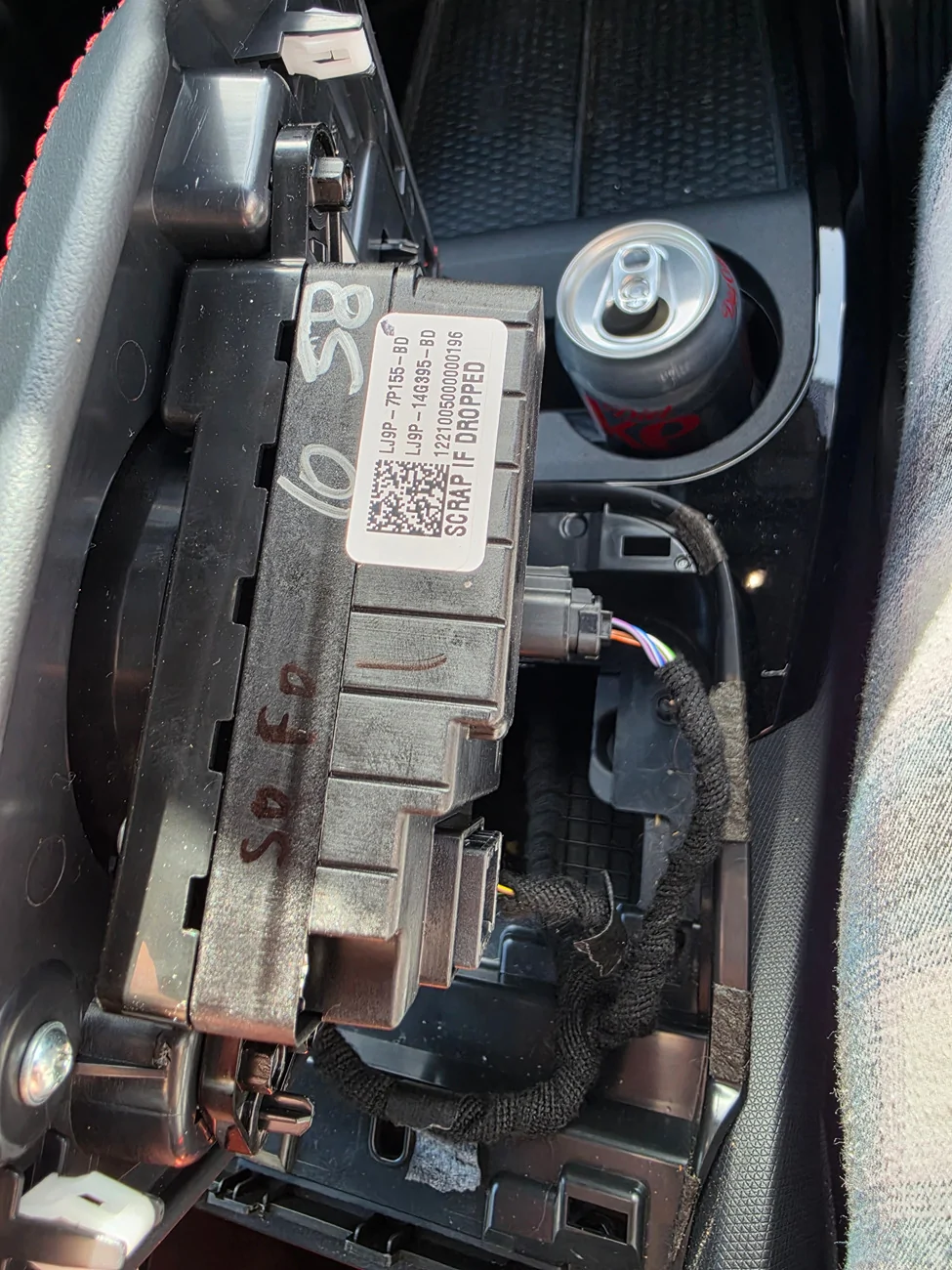

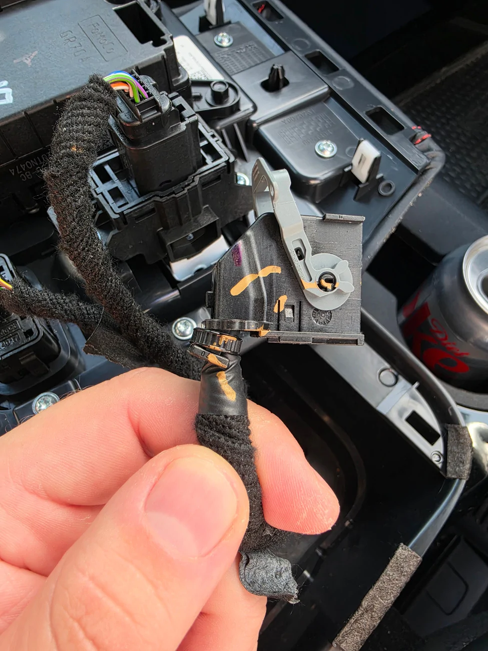

As a last ditch effort before getting into endless hours of diagnosis I tried a method suggested elsewhere on the forum. I disconnected the gear shift selector, power cycled the car and then reconnected it. This didn’t work with the same errors and car behaviour persisting (No actual negative outcome, just error messages)

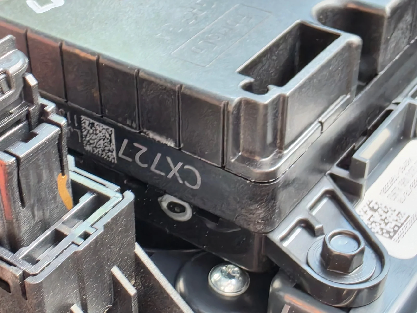

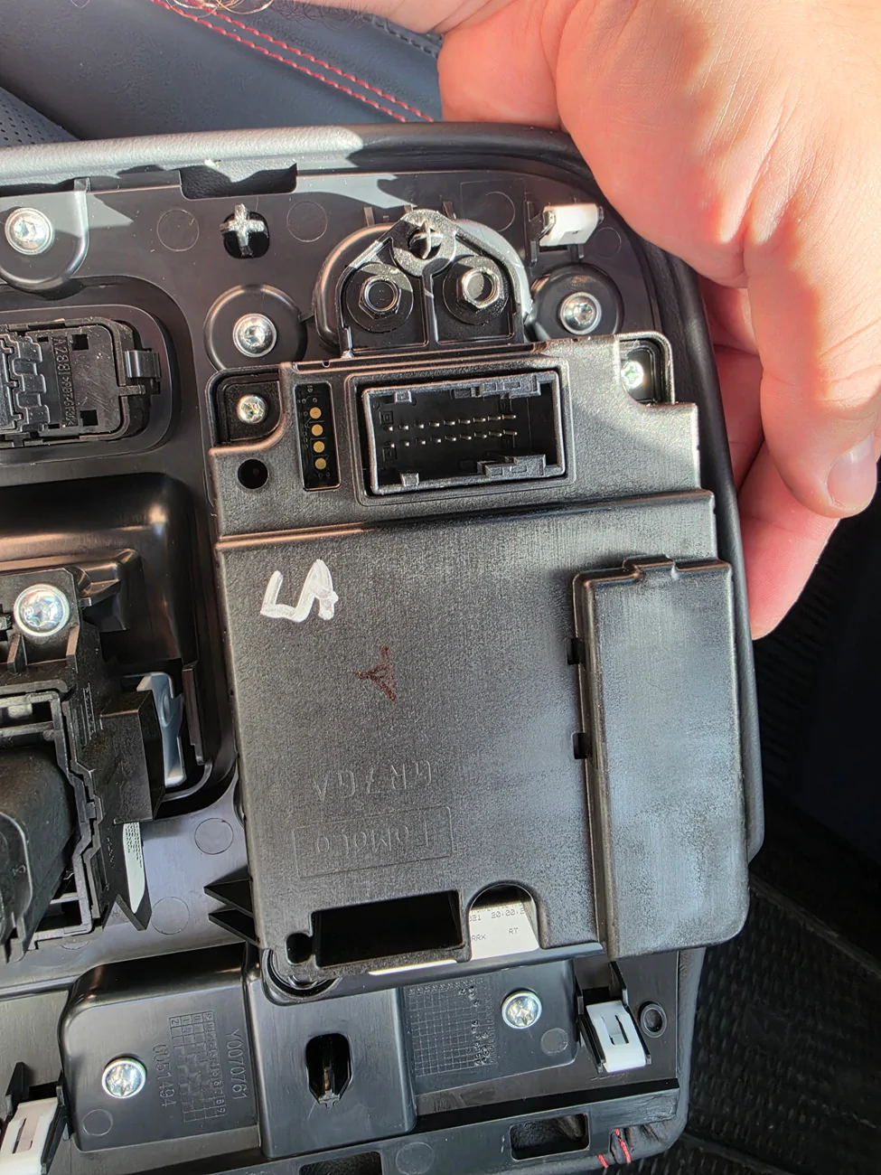

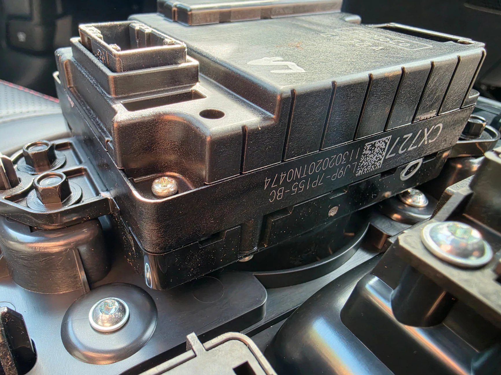

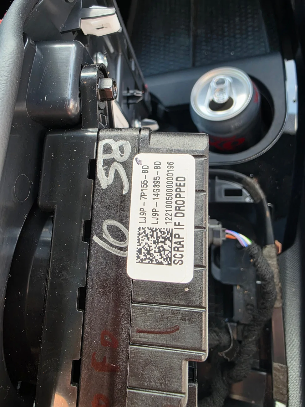

Whilst doing this however I noticed the shift selector module was covered in silver and gold hand written writing and marks. This seemed....odd? Why would a factory fresh part be covered in notes and witness marks? Is this normal? Is this a sign this part has been swapped out or tampered with since it was built? Pictures attached.
The car is new to me from 0 miles so no previous owners or dealers.
