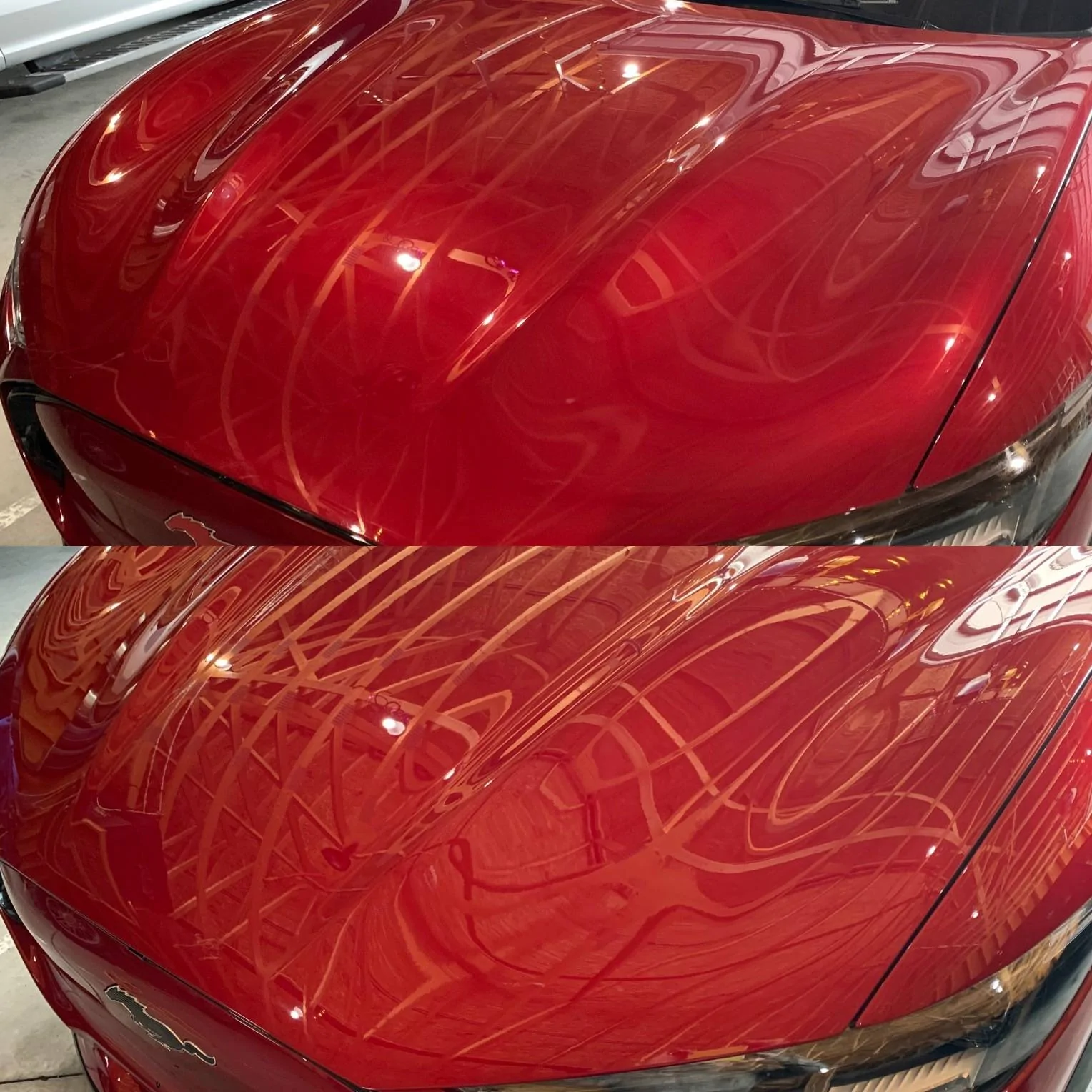

I finally received the the stripes for the Wife’s car yesterday. So I started by detailing her car. Washed, Clayed, Polished, Isopropyl wipe, and two coats of Ceramic from Chemical Guys. Before and After Below:
Since I didn’t put the same effort into detailing hers (she doesn’t care as much and won’t take care of it anyway) I finished early and had time.

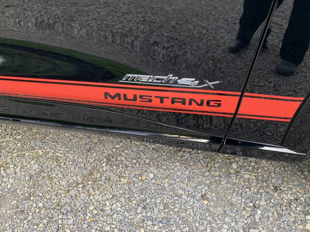

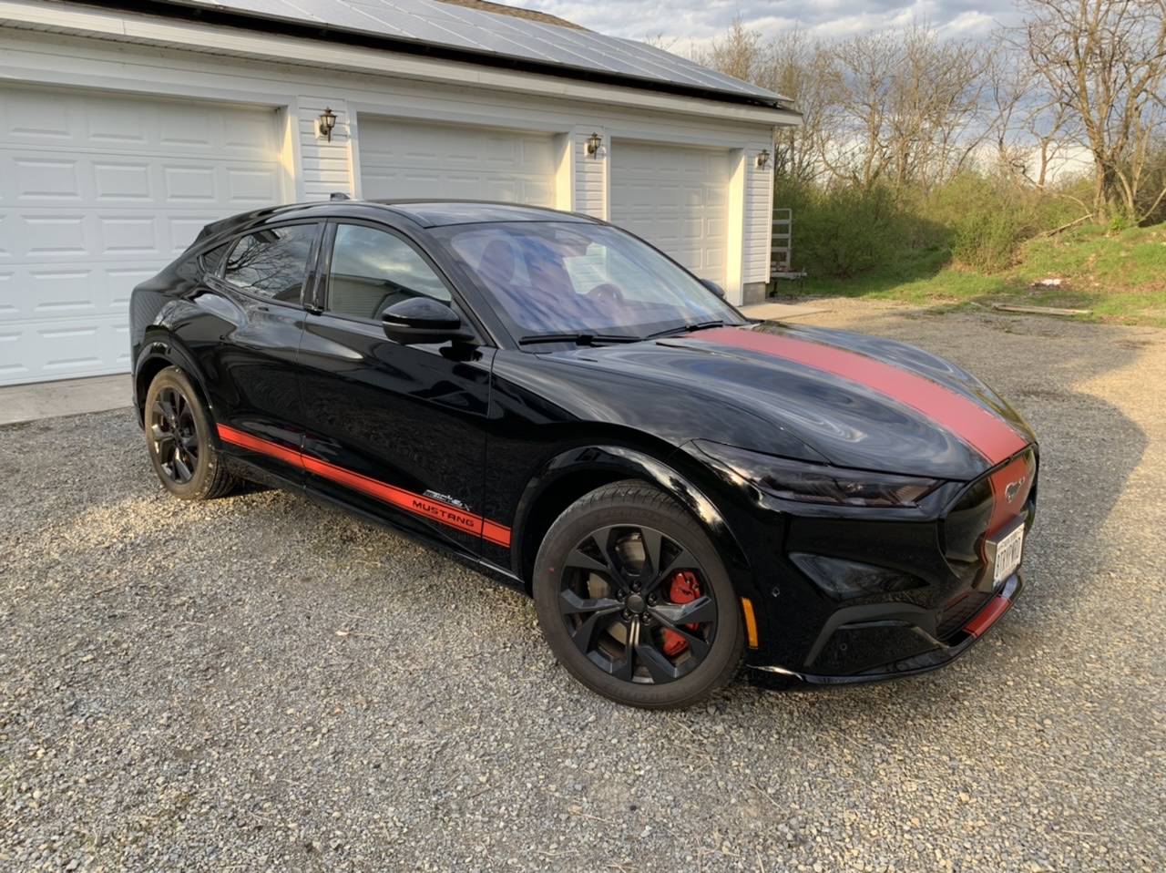

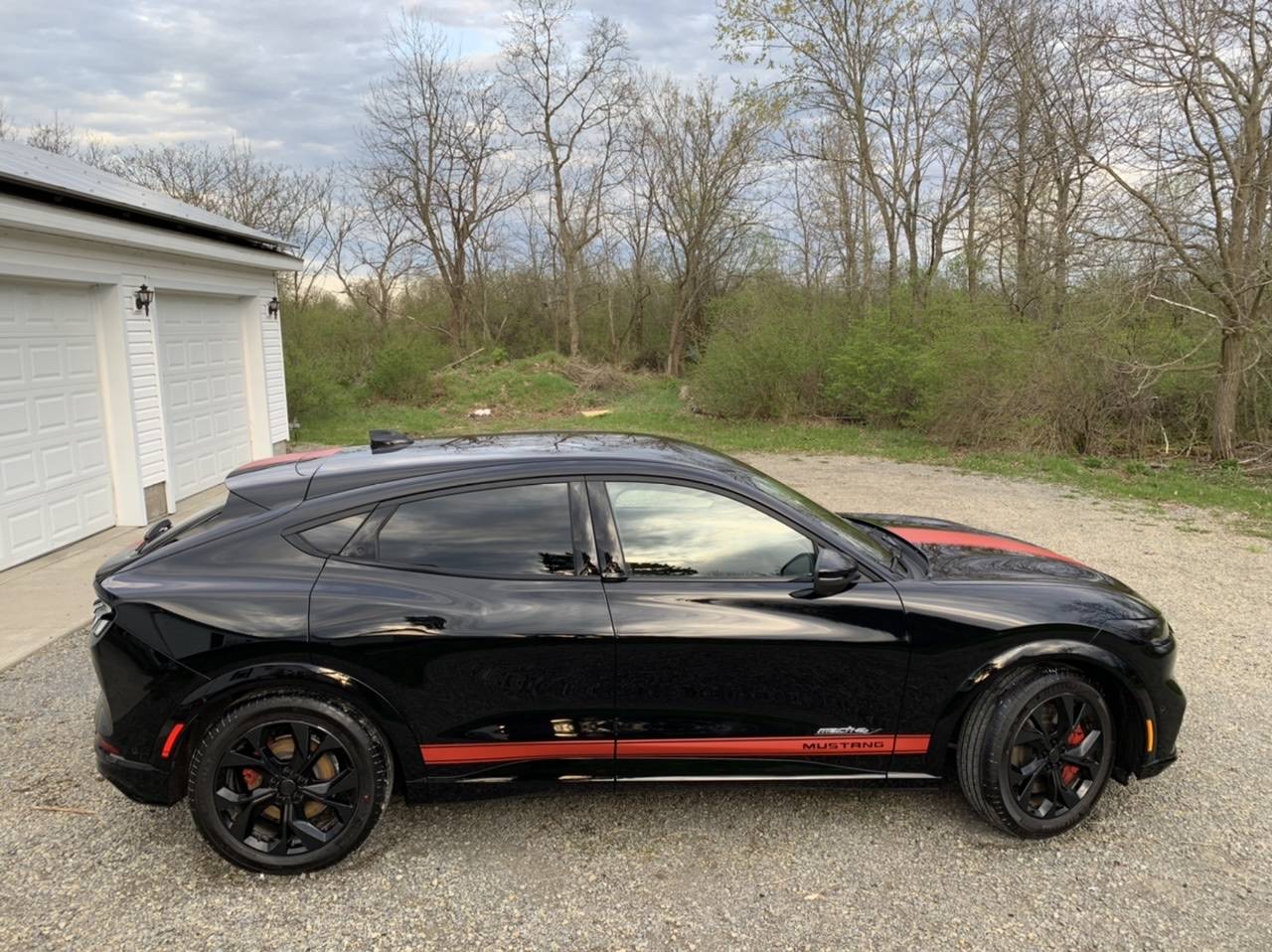

Ladies and Gentlmen, let me introduce you to SIDE STRIPES:
This should really het the “Not a Mustang” crowd going. ?
Had to remove the badging as going below the badging out the stripe right through the faux lower door seam. And going above the badging was just too high for side stripes. So after the stripes were laid I put the badging back on.

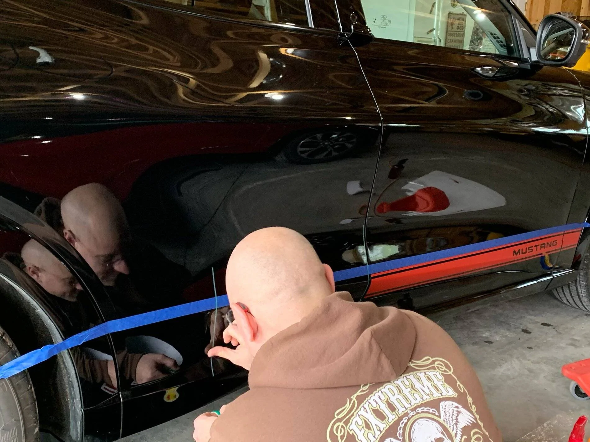

Again, pretty proud of how this came out considering last month I had never detailed a car nor touched a piece of vinyl. The side
Stripe kit was for a 2015 mustang coupe so I had to make a splice between two pieces in the middle of the back door. Again CKWraps YouTube channel showed me what to do and the seam is invisible unless you know where to look.

Hey this looks great. I was wondering how it will look since the accents on the side are inclined and at an angle. Quick question any particular reason why you didn't just put the red stripe over the Mach E logo with a cutout around that area of course.
Because I orders the stripe that said “Mustang” and the Mach-E emblems would have been right in the middle of that. It only took about 30 seconds to remove the emblems and 3 minutes to put them back on. Even if I hadn’t gotten the stripes that said Mustang, a cutout around the Mach-E emblem would have looked half-asses in my opinion. So I would have removed the emblems, laid the striping, then put the emblem back down on top of the stripe.

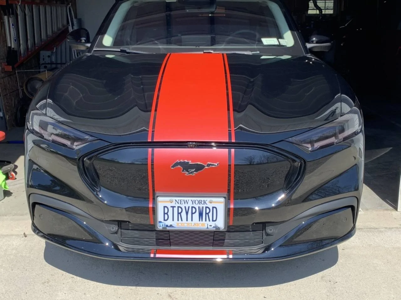

Looks great!! More pics of the front please. ???
