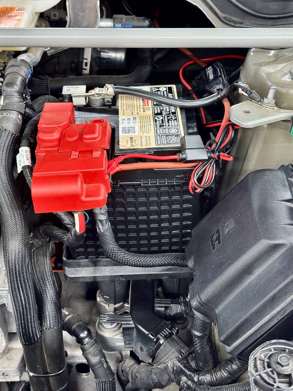

Man I just lost about half of my clips on the rear center piece. What a wonky design for a clipped in panel. Those things are absolutely gone into the ether.
the rear center cover I leave off.
not because I lost the clips, but because I like to see the fluid levels, and have easy access to where I stow my 12v jumper cables.
I thought about doing that, I was concerned about water/rodents though.
I think the rear cover left off lets in more light, which rodents don't like, and enables easier visual inspection.... water sprays up from wheelwells regardless, so as long as you don't put anything there that can't get wet, you are fine.

It doesn't look like pulling out the frunk tub is that big a deal? Or am I missing something?
It's not, but it is awkward and heavy'ish. Plus you get many more chances of losing one or more of the $5 clips if you take the whole front apart!

As Mach-Lee mentioned earlier, it is possible to slide out the battery aft by removing one side of the strut bar but it won't just pop out as easy as it is shown in the video. As Lee said, it's a tight space and you have to lift straight up while keeping the battery cables out of the way with the hood right above that area. In my car, having the Steeda strut brace which is secured with three bolts on each side, the entire brace must be removed. It's easier and faster for me to remove the frunk tub (don't have to touch my strut bar) plus you have much more room to lift the battery out (forward).
I timed myself removing the frunk tub and it took about 2 1/2 minutes:
https://www.icloud.com/sharedalbum/#B0c5p3ichEIQlg
Plenty of room to take out the battery once the frunk tub is removed:
