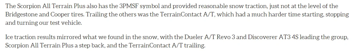

I've got REVO 3s on the F150 which perform better than a lot of 3 peak rated. Best to find actual testing being done on the same vehicle / conditions. Few are willing to do such tests but some of the larger tire retailers will.
I doubt it, if it would have been able to pass the test Bridgestone would have put the rating on the sidewall.
If your not familiar there are regulations on the three peak rating. Some things like m&s are marketing terms and some are actual tests.
That being said it's a good all season tire.
Go through their data yourself. Creating a tire to accel at a test isn't the same as what is achieved in real-world performance.
https://www.tirerack.com/tires/tests/testDisplay.jsp?ttid=240

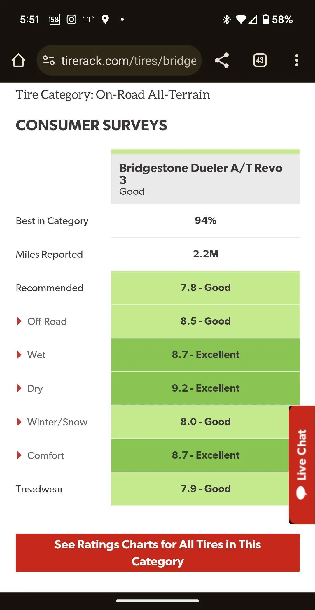

Makes me wonder why Bridgestone would not test and certify the tire for 3pmsf I don't have the answer but it's interesting. Also off-road on packed snow is not a condition we see much here in the USA and that could skew the result
One other section on TR not to avoid is customer feedback from people who bought the tire and drove on them. These are a real-world rating. I usually look to see if testing and feedback align if they don't like in the case of the Revo 3 it makes me wonder if the test is accurate to roads and driving conditions.
