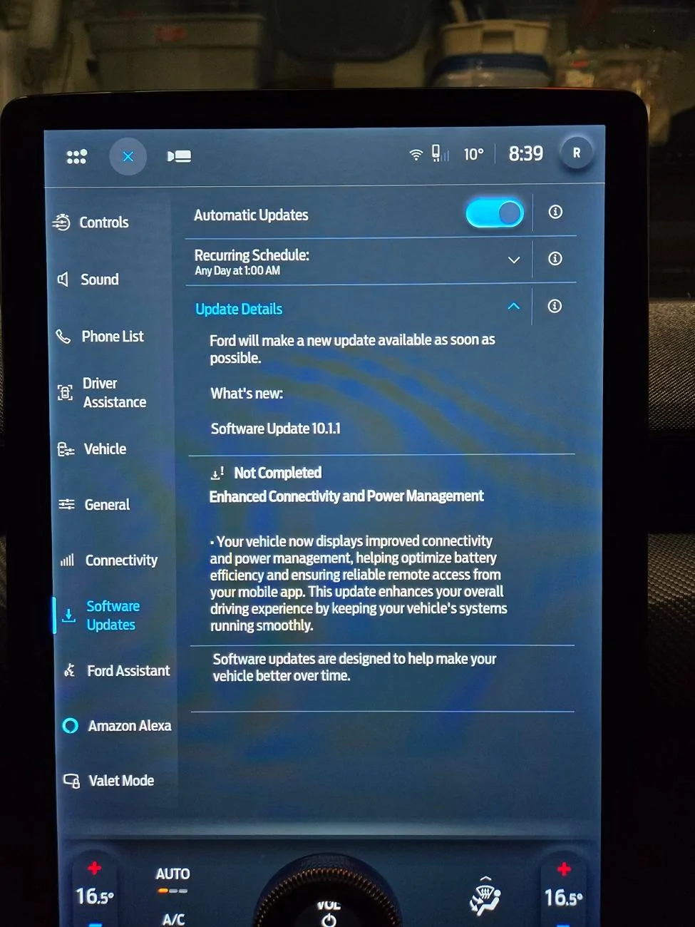

For 2 days I've noticed that I'm stuck on a Not Completed error:
Ford Mustang Mach-E Software Update 10.1.1 20241109_203957

In my experience, this means your 12v didn’t have enough charge. Drive it for something like 30 minutes. I believe 12v doesn’t charge unless the HV is charging or you are driving it.
And if you don’t have a GT avoid using 12v accessories while driving to charge the 12v as the non GT has a smaller transformer.
I believe when the SoC of the 12v is below 40% it also charges from the HV.
the problem is bigger software updates need more battery and so the threshold for the 12v SoC is higher.
