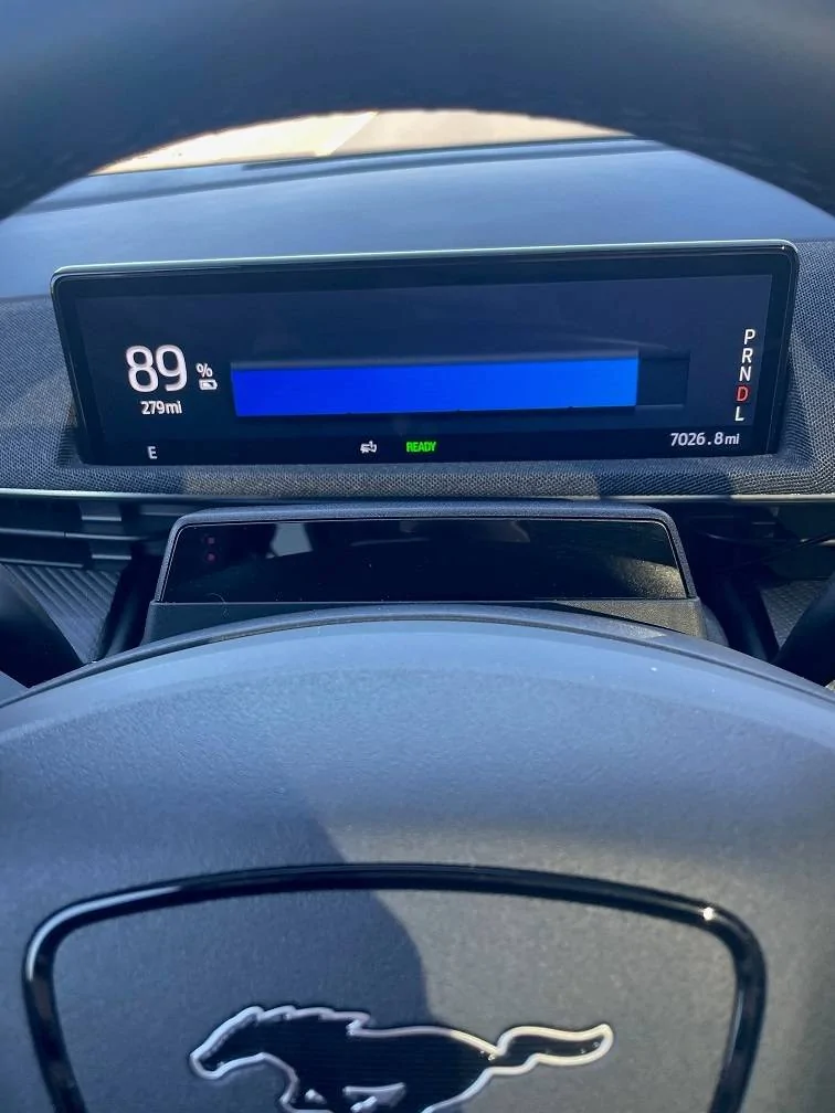

Is it possible to reboot the screen in front of the steering wheel (dashboard screen)? I got in my car the other day and was driving down the freeway when I realized the speedometer wasn't there. Turning the car off and back on resolved the issues but I was curious if something like that existed as it does for the main screen. I am really good at rebooting that one. :rolleyes:
Interestingly enough I did use the carscanner app and was able to get my speed so likely just the computer that controls that screen was frozen. The photo from below is Unbridled but as you can tell its not, switching between the modes didn't resolve it either. The drive mode would change but the display did not. The battery % also went down as a drove.

hold the down button and the fast forward button on the right hand side of the steering wheel controls

Just the Sync screen reboot, which may resolve the IPC issue. Not many reports of the IPC having issues or freezing, etc. and needing a reboot while driving, so hopefully this isn't a common occurrence for you and you won't have to pull over and restart to get it sorted!

I should mention I did try a sync reboot. Overall not a big deal because rebooting (turning off\on) resolved it and so far it has only happened once in my 13 weeks of ownership. More curious if there is another steering wheel reboot type thing for that screen to save me from pulling over and rebooting and hopefully help someone else in the future.

That's a new one. 2022's haven't had an IPC update yet. Any codes? If it happens more you might need a new IPC.

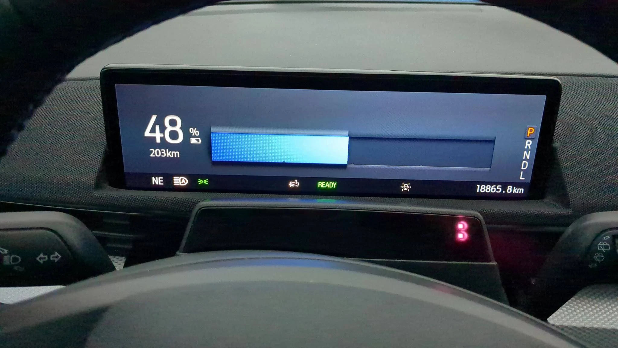

Ford Mustang Mach-E Speed (MPH) Missing - Reboot Dashboard Screen? MachECluster
My wife had this happen today to her as well. she didn't think to reboot so drove the 10 minutes without a speedometer. 2022 Rt1, first time I'm aware we've had this in almost 19,000 km's.
