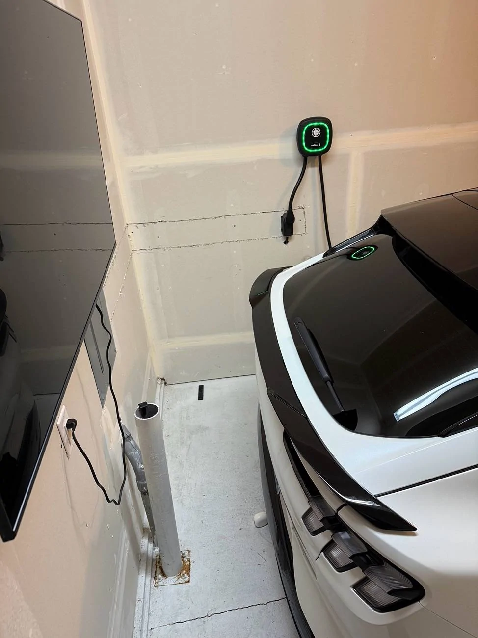

The 3M sealent only goes in that crevice / ridge underneath, correct?
Yes, the 3M sealant goes into the crevice / channel on the seating part.
But I used the extra sealant to fill in the gap that was created.
Notice the right side has an uneven look to it.

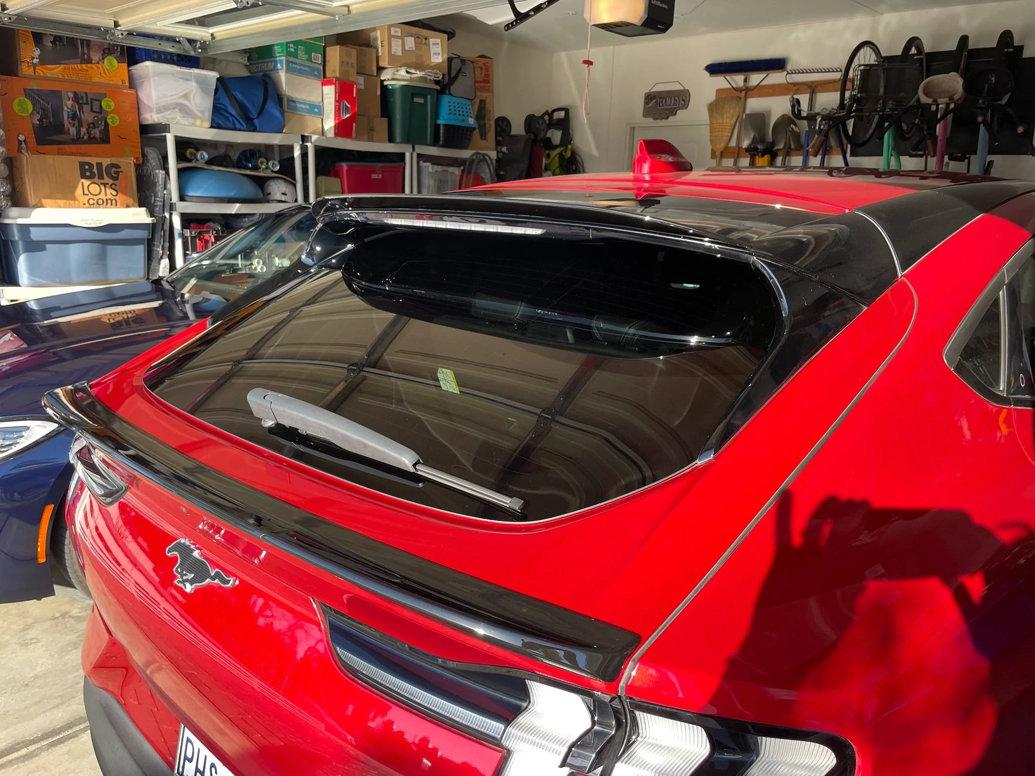

I installed the air design deck spoiler. I mocked it up for 30 minutes before I installed it and followed the instructions exactly. I got lucky and its straight. But i can see how this might go wrong. When glueing it down I suggest putting the leading edge of the spoiler in position first, double check your alignment then let the trailing edge drop down on to the deck. And then put sandbags on top to hold it down. finally I let it cure at60 degrees for 24 hours. Holding it down with Tape is ridiculous, that’s never going to do anything.
First impressions are that it actually helps on a GTPE with a giant front splitter. It steers a little straighter, less darty and twitchy.
