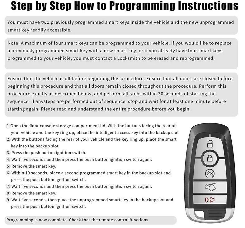

The only reason we've had to rely on a dealer or locksmith to add a new fob is because the "self service" procedure requires you to already have 2 fobs paired to the car. That's not an option since the MME only comes with one fob. But once you have 2, you should be able to add a 3rd and 4th yourself.
What is the “self service” procedure? How would you go about programming one? Is it in the manual about making a “My Key?”
