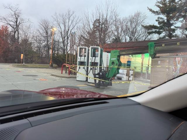

I just did a nearly 1,200 round trip from NW Ohio to Baltimore. I used Telsa Superchargers 4 times and had no problems. I'm not sure the order you connect is important. I just put the adapter on and plug it into my car. I have my Ford Pass account set up for plug & charge and it has worked at all the Telsa and Electrify America stations. I have had only one problem with Telsa when it wasn't compatible with my car. What I would suggest is when you get near your destination, where you know there are Tesla Superchargers, go into the app on the car for "Public Charging" (it will only show you the chargers within a relatively short range of your location). The nice thing about the app in the car, is it will show you which Telsa stations are not compatible with your car and which ones use the adapter and are plug & charge. I did not find that information on any of the other apps I used.
I used the navigation in the car to chart the course to my next charging station, but it doesn't give me any info when you start the trip to tell you the status of the station when you get there. I went about 125 miles to an Electrify America, only to find this!!!
Ford Mustang Mach-E step by step using NACS at Tesla Supercharger [help needed] IMG_0439
They were swapping out the chargers, but the mapping app didn't know that! Not good.......I was at 12%! I went into the "Public Charging" in the car app and it showed a Tesla station (which is the next picture below, where we charged on the way to Baltimore, just .2 miles away. Whew!).

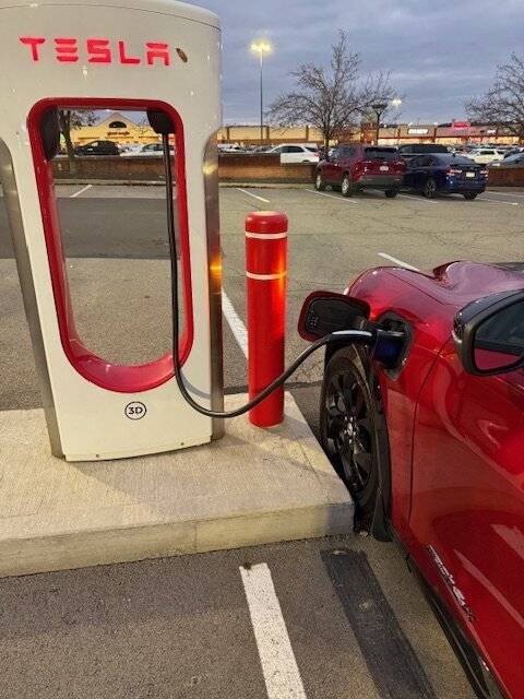

The most tricky thing at Tesla is the short cord, compared to EA. Sometimes you can get lucky and they have a space on the end or a charger
Ford Mustang Mach-E step by step using NACS at Tesla Supercharger [help needed] IMG_0136
perpendicular to the other chargers. If not you have to hope you can clear the curb or park on an angle, which is a little embarrassing.
Ford Mustang Mach-E step by step using NACS at Tesla Supercharger [help needed] IMG_0435
When done, just hit the unlock button and take your adapter and you're done!

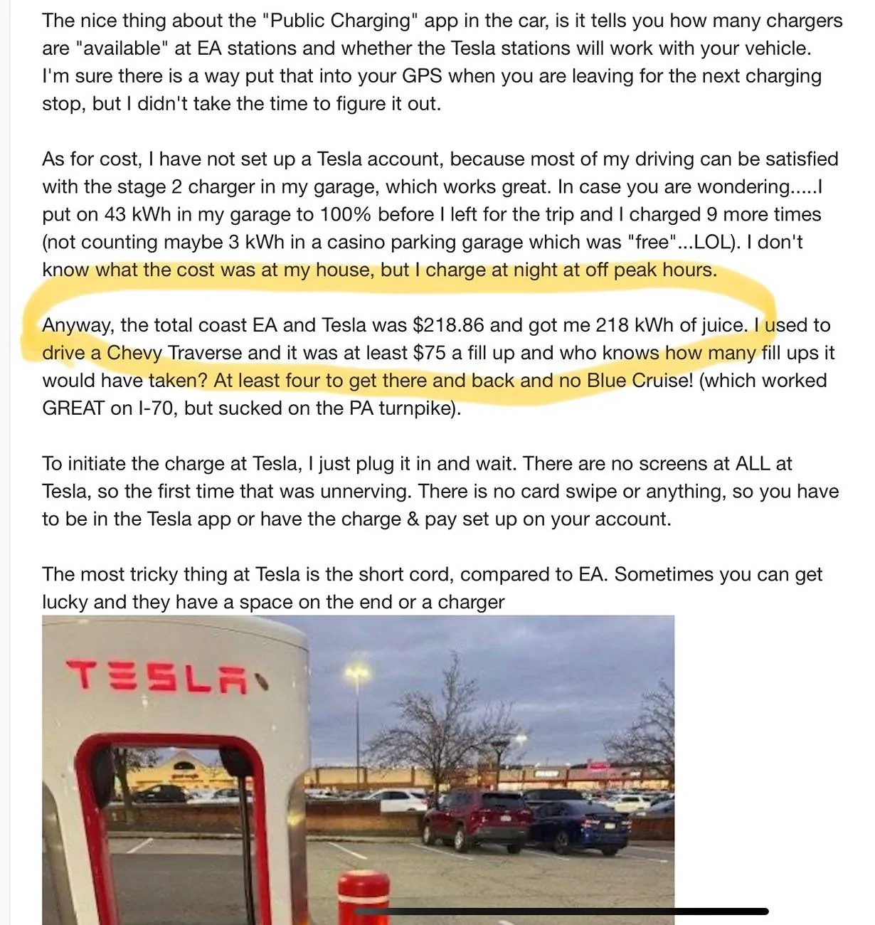

Are your number correct here? This would indicate you paid $1.00 per kWh.

prices in NM are generally $0.64/kwhr at public charging DCFC, the Ford dealership near me is $0.45. I dunno about Superchargers since I haven't used one yet.

You are correct, I either added wrong or wrote it wrong. I made 8 charges using either EA or Tesla supercharges and going back through my charging history and comparing it to my messages showing what was billed to Ford Pass....it shows 358 total kWh for $195.05. I made one other charge at a Dealership where I had to use a credit card, but I don't think it was crazy expensive. So, the above 8 charges would be $.54 per kWh, if my math is correct. I know there are a lot of engineer types on this site and math was not my strong suit, so that's why I went to law school. Sorry...... But the overall sentiment is still the same: I enjoyed the experience more than had I driven my wife's Jeep Cherokee.
