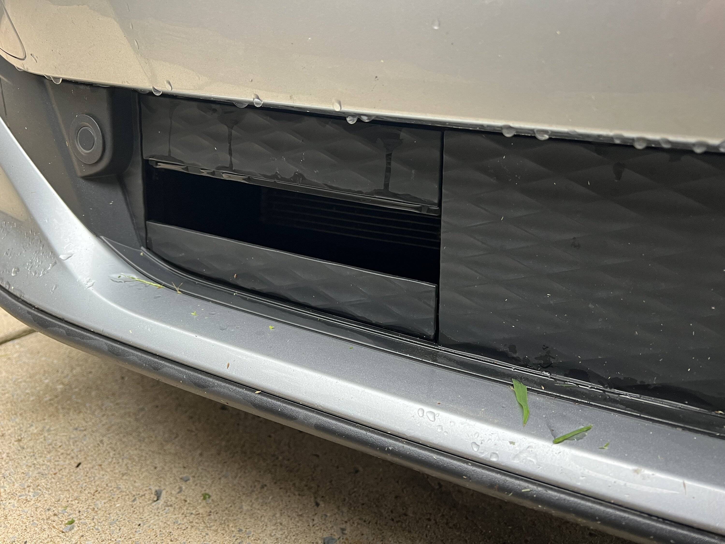

Hey, I was wondering if I could get the file for this one. Hit a bird on the Interstate and lost it. We should create a library somewhere with these sorts of files to access. 2023 model year.
Hi i did started a thread in AOSK sub forum section
https://www.macheforum.com/site/thr...or-a-quick-3d-print-fix-on-small-parts.25151/
which i share some 3d file of Mach E for a quick fix.
and i attached the file of this piece in this thread as well, its on #32
Can you pass along the ones for the driver's side (all three)?
i shall have all 6 of them in the file, you might want to print them out individually?
I'd be very interested in these files as well. Guessing these probably shouldn't be printed in PLA right? Maybe PETG?
if your printer is able to print ABS, that would be the best. but PLA shall be fine i guess?
https://www.macheforum.com/site/threads/【aosk】mach-e-3d-scan-files-for-small-parts-request-thread-if-you-are-looking-for-a-quick-3d-print-fix-on-small-parts.25151/
Ah - I didn't realize that you included all of them in that zip file. Thank you very much for providing this - that is such a great service to so many of us! :)
