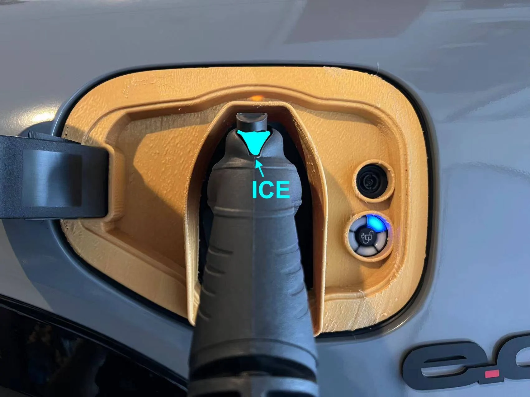

AOSK, please take a look at this so you fully understand the problem:
https://www.bmwblog.com/2016/02/21/bmw-i3-life-hack-charge-port-snow-cover/
You need to think more in 3 dimensions rather than just having a flat plate. It needs to protect the latch button of the J1772, otherwise ice will get inside and you won't be able to press down the button to release it:

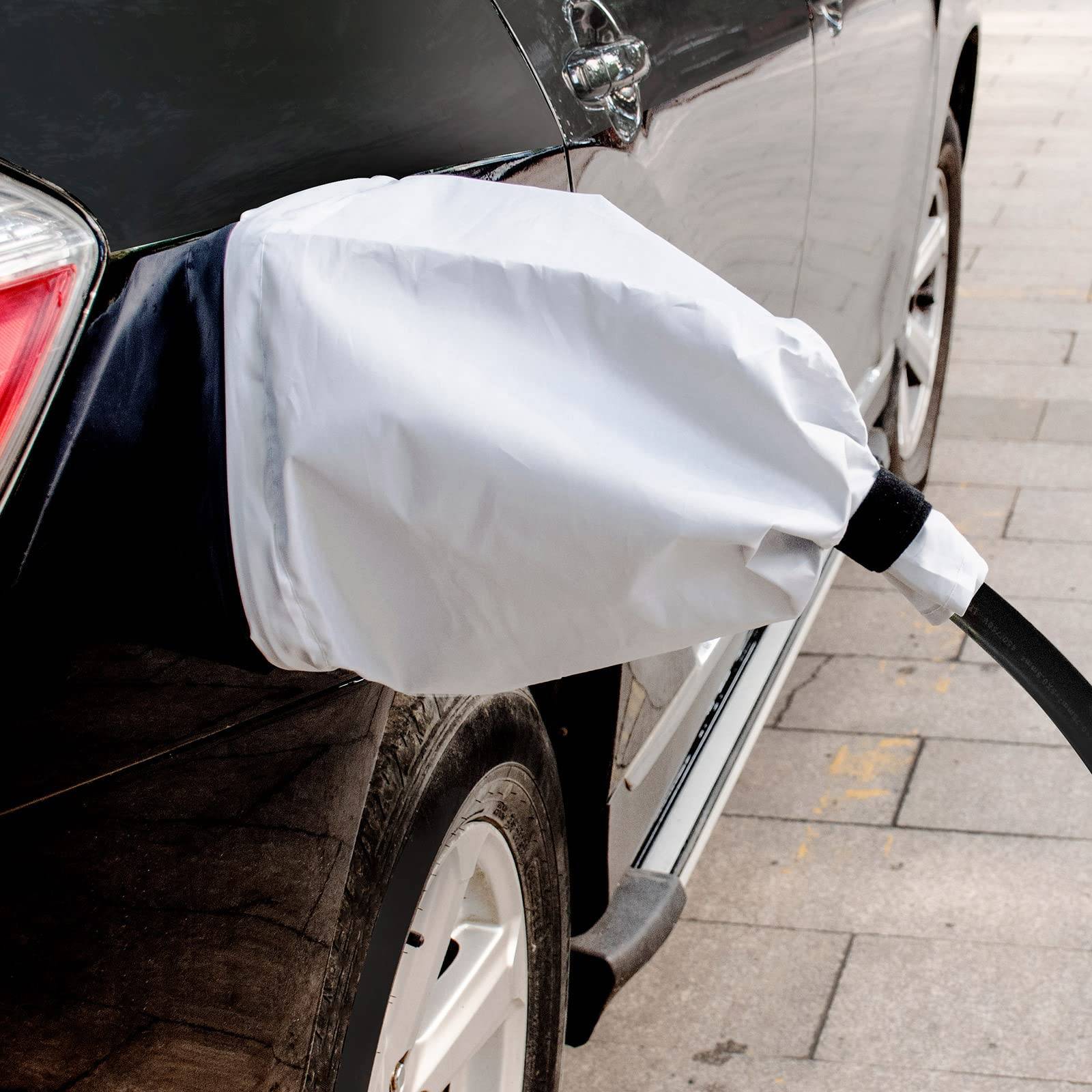

A bag over the whole thing is the best solution:
https://www.amazon.com/BestEvMod-Pr...ries-Compatible/dp/B0BQ2SWXM6?ref_=ast_sto_dp
we do have something like this too

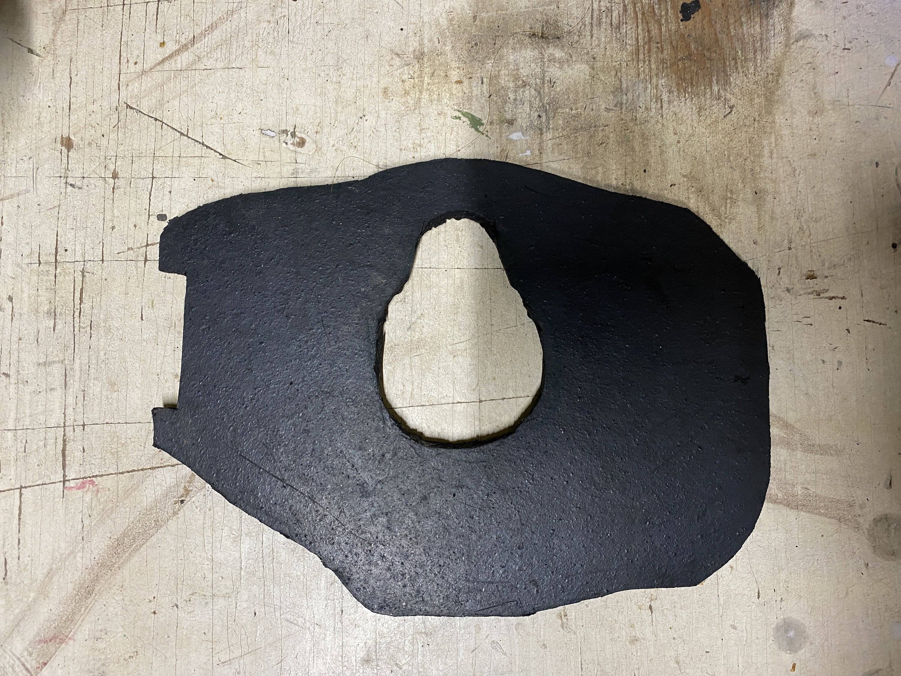

What is the added benefit compared to this original accessory? (It's cheaper too)
The AOSK one works with the J1772 and CCS-1 charger handle used in North America, where the Ford version does not (EU only). ??
