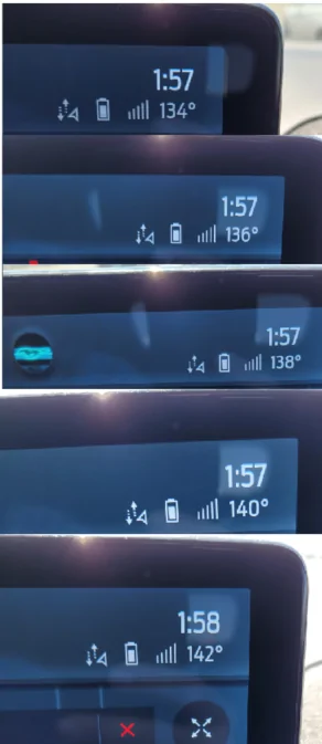

Those of us who drive here in the valley should beware. The new updated software does not appear to be as good at cooling compared to last year. We haven't even hit the real summer yet and I am already seeing temps on the screen MUCH higher than before. Max I saw last year was 133F I believe. We are blowing right by that now.....especially if you use 1PD in stop and go traffic.
Today I was traveling down the freeway at 50-55 mph and the temp on the screen said 118F. Then traffic came to a crawl for a mile or two and temps started creeping back up to around 125F. Then I switched over to 1PD and temps shot right up and that was when I started snapping photos. I switched back to 2PD around 140F and then the temps reduced slightly to around 138F and maintained there until traffic started flowing again.
None of this ever happened last summer. The car handled last summer's heat like a champ. This summer is going to be dicey I think. :oops:
Ford Mustang Mach-E Summer is here!  Ugh! 1654904923214

I thought the temp reading seemed unusually for so early in the season. I just thought the temp reading was high due to place of the thermometer on the car. I did not realize the temperature correlated to how the MME runs, etc.

The sensor is in a place that effectively measures the air temp after it has passed through the two heat exchangers at the front of the car. As far as I can tell, the delta between that reading and actual ambient can be an indication of how well the cooling system is working.
So far this summer, my observations seem to indicate a desired delta of 10F or less and the car is happy. Greater than that and you better get moving as to create airflow though the louvers. I really don't remember this being a problem last year but maybe I wasn't paying close enough attention.

I wouldn't think 1pd would cause more heat. Most likely it would be due to it stopping more. My FFE DIES in the heat. My black one would spend all it's energy trying to cool the battery that the AC wouldn't work for 20 min unless you were rolling above 35mph for 10 min. Traded it in for a Silver FFE. It's AC works pretty well but ramps that fan up hard and there is a lot bigger air intake and fan on it then the MME from what I can tell.
