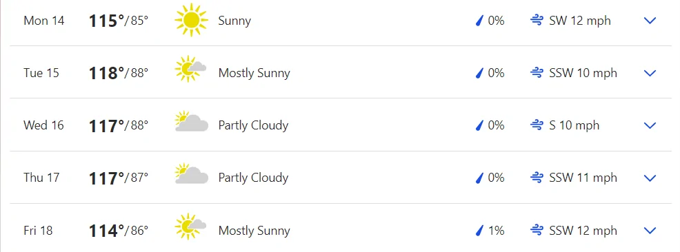

I understand that this:
... is from me driving around during this:
So I parked and plugged it in, since I've arrived at home where that's easy to do.
But then nothing special happens. I don't hear any fans or chillers or whatnot. Why not?
BTW, charging is delayed until 11 pm per my vehicle's location based settings. The EVSE isn't set up with any sort of time restrictions.

There are three basic cooling strategies.
1. Circulate fluid. Very hard to hear the pumps.
2. Circulate fluid with fan on and louvers open.
3. Circulate fluid, fan on, louvers open, chiller active (compressor on).
Being late in the day, your car may have been able to manage the heat soak by just circulating fluid.
If it was afternoon. In the shade you are more likely to hear the fan turn on.
Tomorrow you might hear the chiller turn on during the peak of the day.
