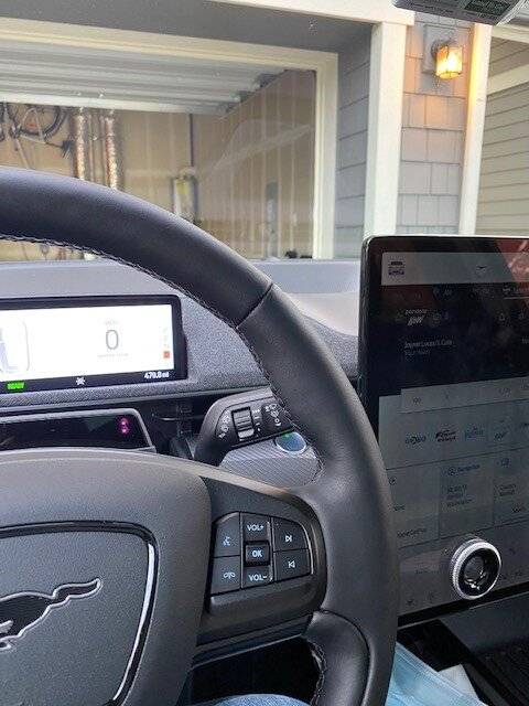

Add me to the list of owners that is having this issue now - though this is substantially later than all yours. I’m on update 4.2.1 and I can BARELY see my screen. Adjusting brightness next to the headlights does nothing, nor does resetting the screen.
To preface this issue I was away for three weeks and the vehicle went into a deep sleep mode. When I started it up it would not auto adjust to my brightness settings that I had set to my profile. I took it to the dealership yesterday for its second delivery and they had no clue. Any help in this matter would be appreciated!!
