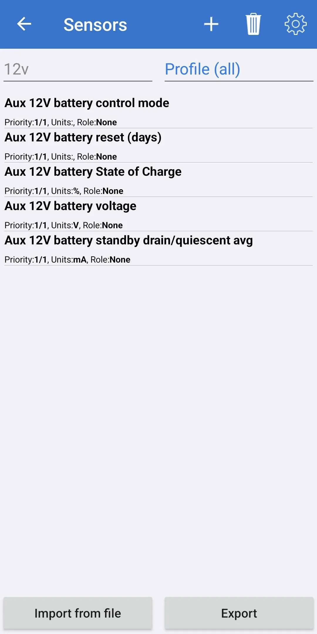

Some cars are driven more often or take longer trips, which keeps the 12V battery in good shape and probably counters the battery drain caused by app widgets.
To get reliable test results, you should check the %SOC of the 12V battery before and after turning off these widgets. Aux battery has a separate BMS, which will trigger an alarm if 12V drops below some %SOC threshold.
OBD2 bluetooth dongle will read 12V battery parameters in Car Scanner ELM OBD2 app:
Ford Mustang Mach-E System off to save battery Sc_70316732
